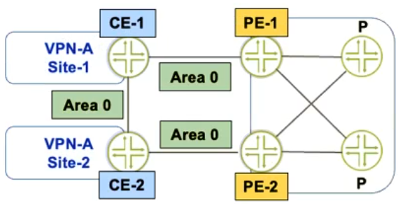

Click the Exhibit button. Referring to the exhibit, the PE-to-CE protocol being used is OSPF for the L3VPN. Also, there is an OSPF neighborship between CE-1 and CE-2. Which statement is correct in this situation?
You must set a high metric on the CE-1 to PE-1 link for hosts at Site-1 to use the CE-1 to CE-2 link to reach hosts at Site-2.
You must set a high metric on the CE-1 to CE-2 link for hosts at Site-1 to use the L3VPN to reach hosts at Site-2.
Hosts at Site-1 will reach hosts at Site-2 through the CE-1 and CE-2 link by default.
Hosts at Site-1 will reach hosts at Site-2 through the L3VPN by default.

c) is correct: the type-1 direct link CE1-CE2 is preferred over the type-3 or type-5 LSA via L3VPN
