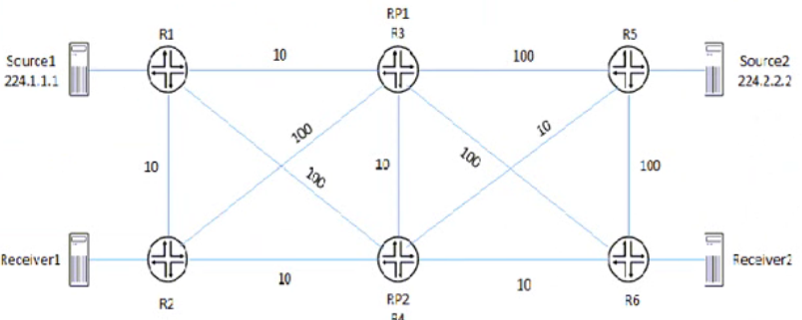

Referring to the exhibit. PIM-SM is configured on all routers, and Anycast-RP with Anycast-PIM is used for the discovery mechanism on RP1 and RP2. The interface metric values are shown for the OSPF area.
In this scenario, which two statements are correct about which RP is used? (Choose two.)
  • A. Source2 will use RP1 and Receiver2 will use RP1 for group 224.2.2.2.
  • B. Source2 will use RP2 and Receiver2 will use RP2 for group 224.2.2.2.
  • C. Source1 will use RP1 and Receiver1 will use RP1 for group 224.1.1.1.
  • D. Source1 will use RP1 and Receiver1 will use RP2 for group 224.1.1.1.
ac

b) and d) anycast will follow IGP metrics
