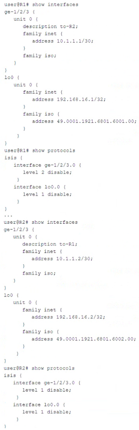

Referring to the exhibit, what must be changed to establish a Level 1 adjacency between routers R1 and R2?
  • A. Change the level l disable parameter under the R1 protocols isis interface lo0.0 hierarchy to the level 2 disable parameter.
  • B. Add IP addresses to the interface ge-1/2/3 unit 0 family iso hierarchy on both R1 and R2.
  • C. Remove the level 1 disable parameter under the R2 protocols isis interface lo0.0 configuration hierarchy.
  • D. Change the level 1 disable parameter under the R2 protocols isis interface ge-l/2/3.0 hierarchy to the level 2 disable parameter.
uax
1 month ago
d) is correct
