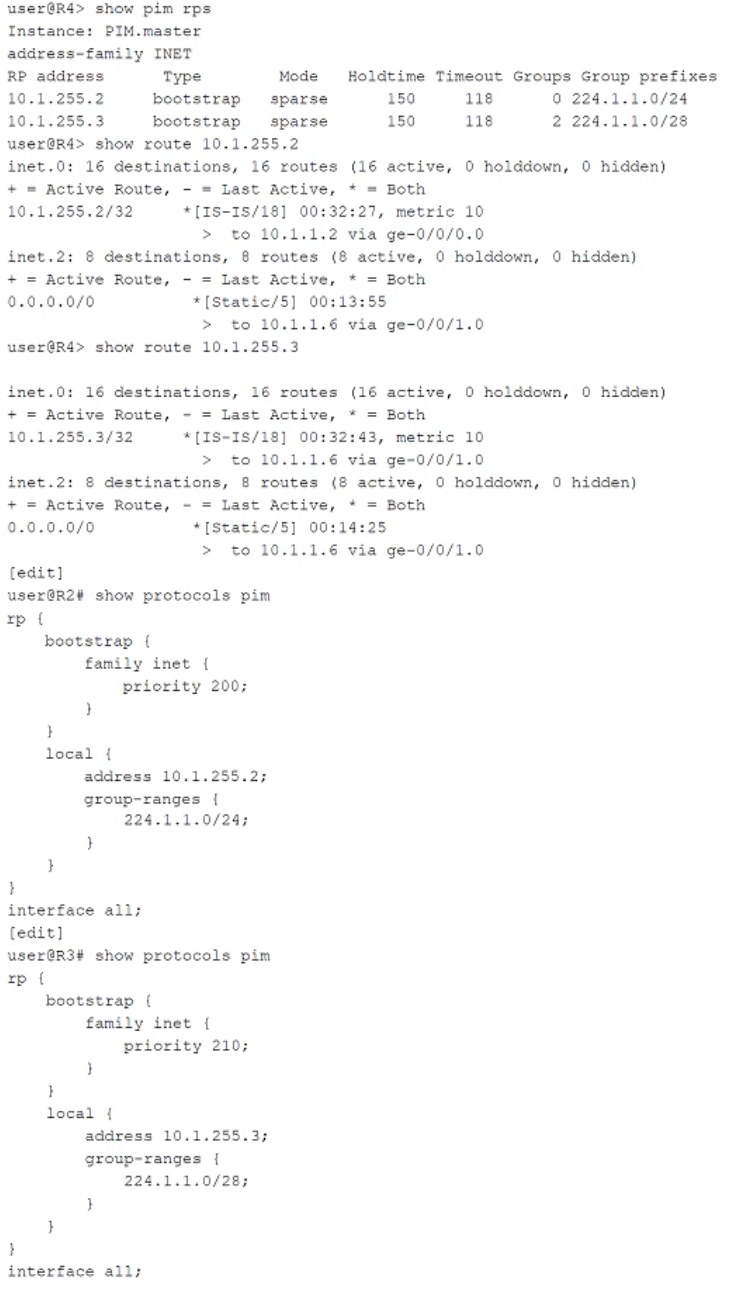

R4 is directly connected to both RPs (R2 and R3). R4 is currently sending all joins upstream to R3 but you want all joins to go to R2 instead.
Referring to the exhibit, which configuration change will solve this issue?
  • A. Change the bootstrap priority on R2 to be higher than R3.
  • B. Change the local address on R2 to be higher than R3.
  • C. Change the default route in inet.2 on R4 from R3 as the next hop to R2.
  • D. Change the group-range to be more specific on R2 than R3.
uax
1 month ago
a) correct
