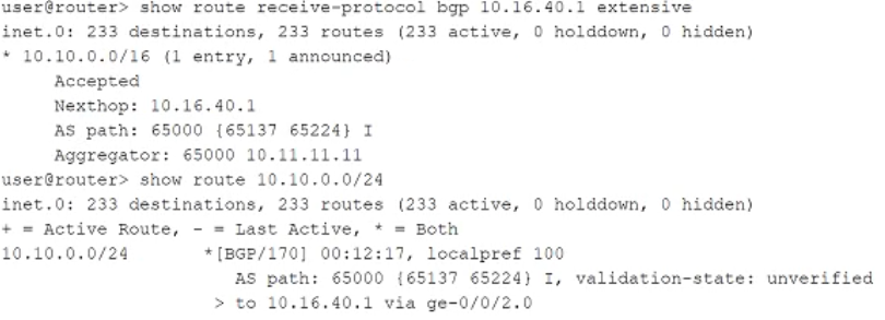

You are troubleshooting an issue for a customer site that uses 10.10.0.0/24 in AS 65224, but you see another AS in the AS path.
Referring to the exhibit, what is the cause of the problem?
  • A. AS 65000 is pre-pending AS 65137 to route advertisements.
  • B. The local AS is in the process of withdrawing the route from AS 65137.
  • C. AS 65137 is advertising the 10.10.0.0/24 prefix.
  • D. The local AS is receiving two equal cost routes to 10.10.0.0/24.
c -
uax
1 month ago
c) is correct
