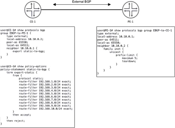

CE-1 must advertise ten subnets to PE-1 using BGP. Once CE-1 starts advertising the subnets to PE-1, the BGP peering state changes to Active.
Referring to the CLI output shown in the exhibit, which statement is correct?
  • A. CE-1 is unreachable.
  • B. The prefix limit has been reached on PE-1.
  • C. CE-1 is advertising its entire routing table.
  • D. CE-1 is configured with an incorrect peer AS.

b) is correct
