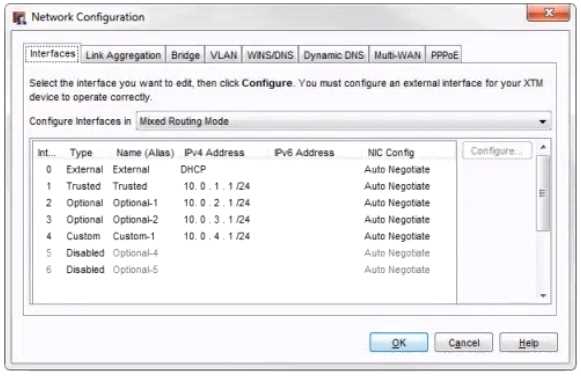

In the network configuration in this image, which aliases is Eth2 a member of? (Select three.)
  • A. Any-optional
  • B. Any-External
  • C. Optional-1
  • D. Any
  • E. Any-Trusted
A, C, D

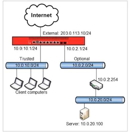

Clients on the trusted network need to connect to a server behind a router on the optional network.
Based on this image, what static route must be added to the Firebox for traffic from clients on the
trusted network to reach a server at 10.0.20.100? (Select one.)
  • A. Route to 10.0.20.0/24,Gateway 10.0.2.1
  • B. Route to 10.0.20.0/24,Gateway 10.0.2.254
  • C. Route to 10.0.20.0, Gateway 10.0.2.254
  • D. Route to 10.0.10.0/24, Gateway 10.0.10.1
