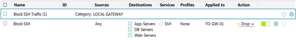

Given this exhibit:
Which statement is true about the firewall rule?
  • A. It is a distributed firewall applied to App-Servers, DB-Servers and Web-Servers that rejects traffic on port 22.
  • B. It is a gateway firewall applied to a Tier-1 gateway that rejects traffic on port 22.
  • C. It is a distributed firewall applied to App-Servers, DB-Servers and Web-Servers that drops traffic on port 22.
  • D. It is a gateway firewall applied to a Tier-0 gateway that drops traffic on port 22.

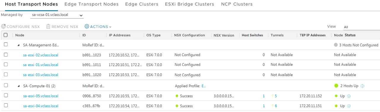

Given this exhibit:
Which statement is true about the host transport nodes?
  • A. sa-esxi-04.vclass.local is successfully prepared for NSX with a TEP address of 172.20.11.151.
  • B. sa-esxi-02.vclass.local is successfully prepared for NSX with a TEP address of 172.20.10.52.
  • C. sa-esxi-05.vclass.local is successfully prepared for NSX with a TEP address of 172.20.10.55.
  • D. sa-esxi-03.vclass.local had an error while being prepared for NSX with no TEP address assigned.
