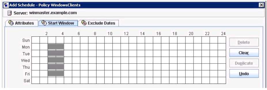

A backup policy uses a Full backup schedule with a schedule type of Frequency: 1 days. The start
window for the schedule is configured as shown in the exhibit:
The administrator runs a manual backup at 10:00 on Thursday.
When will the next backup run, if all prior backups completed successfully?
  • A. Friday at 2:00
  • B. Friday at 10:00
  • C. Monday at 2:00
  • D. Monday at 1:00
