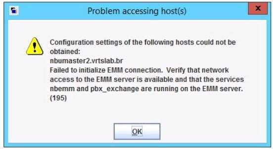

Refer to the Exhibit.
An administrator is trying to access client properties on the NetBackup Administration Console and
receives the following message:
When checking the services on the master server, the administrator sees that the PBX service is
down.
Which two commands can the administrator use to increase the PBX log level to determine the
reason for the message above? (Choose two.)
  • A. vxlogcfg
  • B. pbxcfg
  • C. vxpbx_exchanged
  • D. pbx_exchange
  • E. vxlogmgr
AE

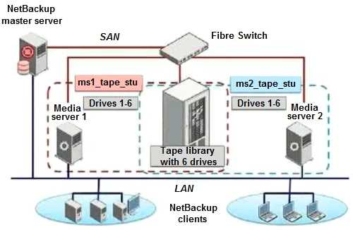

Two media servers, sharing a library with 6 tape drives, exist in the NetBackup environment
displayed in the exhibit. Both weekly Full and daily Differential Incremental backups need to run for
the clients and each schedule has a different retention period. Because of network topology, some
clients back up to Media server 1 and some back up to Media server 2. The environment suffers from
multiple status 96 failures during the backup window.
How can the administrator minimize the number of failures?

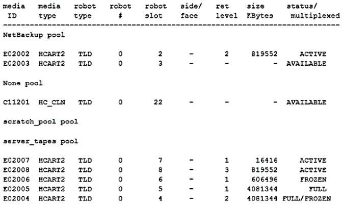

A backup job configured with a retention level of 2 and Policy volume pool set to the
server_tapes is failing due to status code 96: Unable to allocate new media for backup. See the
output of the available_media command below:
Which task in the NetBackup Administration Console should the administrator perform to resolve the
status code 96 error?
  • A. Change volume C11201 to the “scratch_pool" volume pool
  • B. Change volume E02002 to the “scratch_pool” volume pool
  • C. Unfreeze volume E02004 in the “server_tapes” volume pool
  • D. Change volume E02003 to the “scratch_pool” volume pool

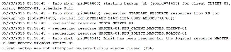

An administrator has a job that has failed. Upon reviewing the Detailed Status tab for the job, the
administrator sees the following information:
Which setting value prevented the job from running during the backup window?
  • A. the Global Attributes > “Maximum jobs per client” master server host property
  • B. the Timeouts > “Client read timeout” master server host property
  • C. the “Maximum concurrent jobs” storage unit setting
  • D. the “Limit jobs per policy” policy setting
