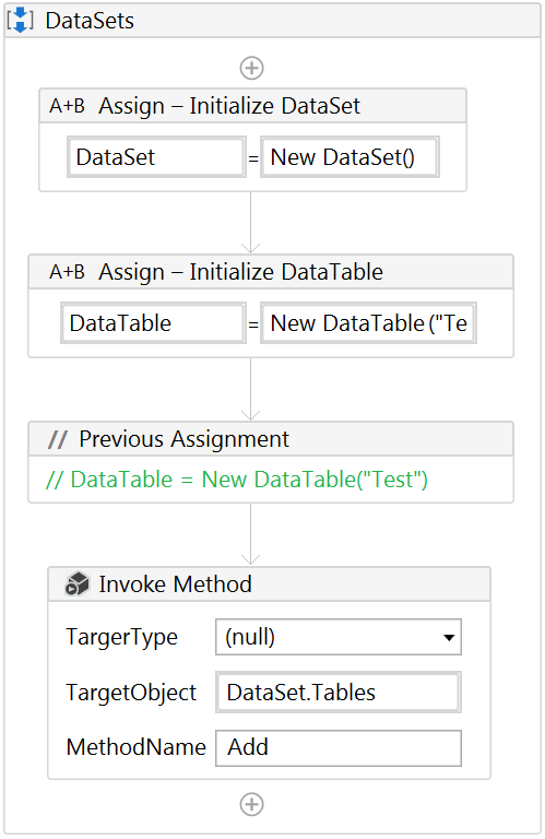

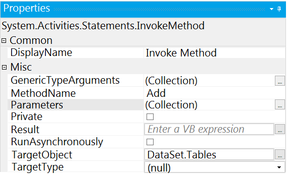

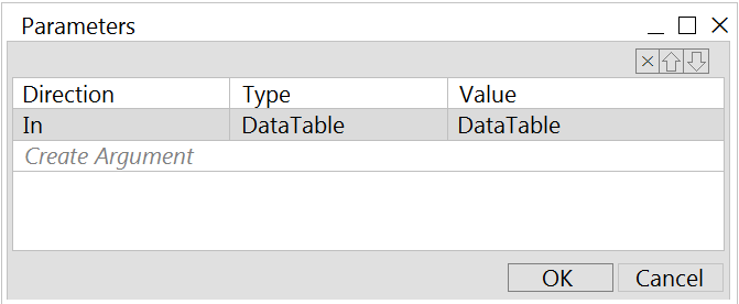

A developer reviewed the following sequence:
The parameters of the Invoke Method are:
In order to get the table name of the first element in the DataSet, which expressions should the
developer use?
  • A. DataSet.Tables(0).TableName
  • B. DataSet.Tables(1).TableName
  • C. DataSet.Rows(0).TableName
  • D. DataSet.Rows(1).TableName

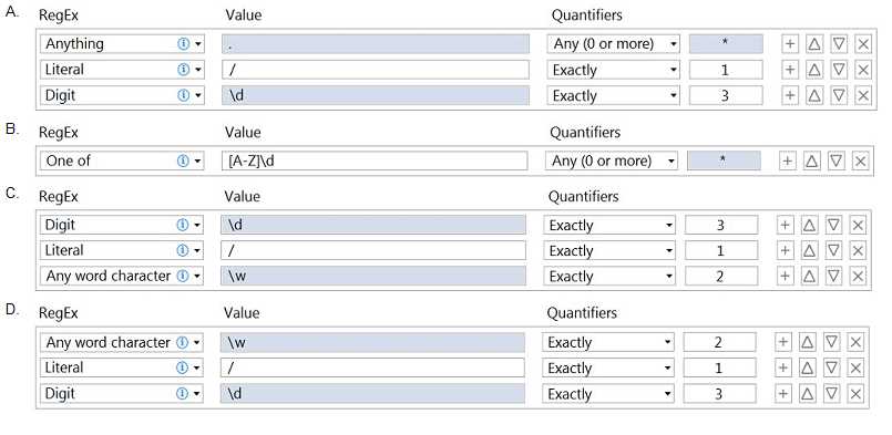

A developer needs to automate a process which involves capturing support ticket numbers from the
email subject line. For example, the email subject line includes: "Action Required – XA/135" where
"XA/135" is the ticket number. The robot should validate the pattern of the ticket number before
proceeding.
Which expression exclusively matches the ticket number pattern from the subject line?

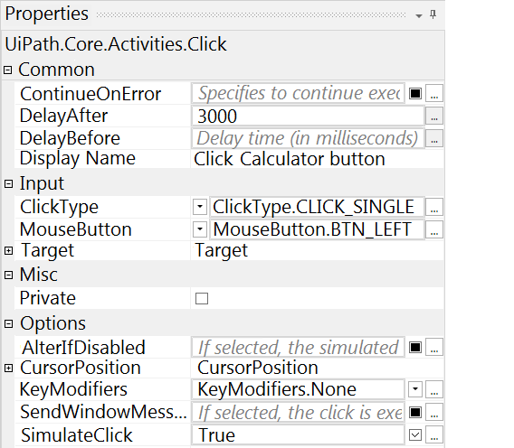

A developer uses Workflow Analyzer with the default rules to check if a project follows best
practices. In one of the workflows, the Properties of a Click activity is shown in the following exhibit.
Which warning will be shown in the Analyzer output for this activity?
  • A. Timeout values is not defined in activity Click Calculator button
  • B. Hardcoded delays used in activity Click Calculator button
  • C. Activity Click Calculator button has a default name
  • D. SendWindowMessages not checked in activity Click Calculator button

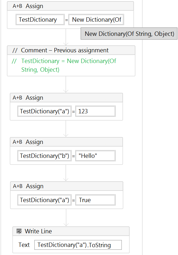

Review the following exhibit:
Based on the exhibit, what is the result of the Write Line in the sequence?
B. True
C. Hello
D. 123True

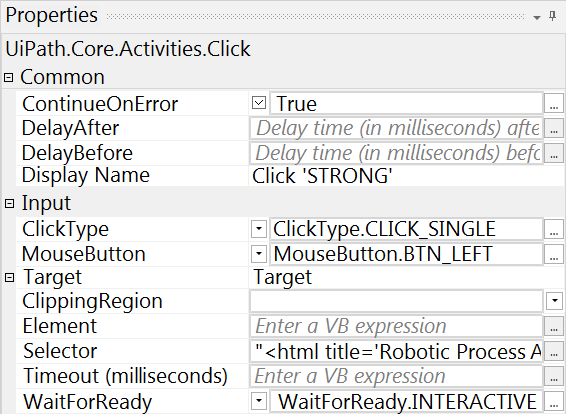

A developer configured the properties for a Click activity on an element inside a web page as shown
in the exhibit. An animation on the web page never completely loads but the element specified in
the Click activity does.
What occurs when this Click activity executes?
  • A. Timeout error occurs without clicking on the element.
  • B. Waits 10 seconds before clicking on the element.
  • C. Continues to the next activity after 30 seconds without clicking on the element.
  • D. Element is clicked once it is fully loaded.

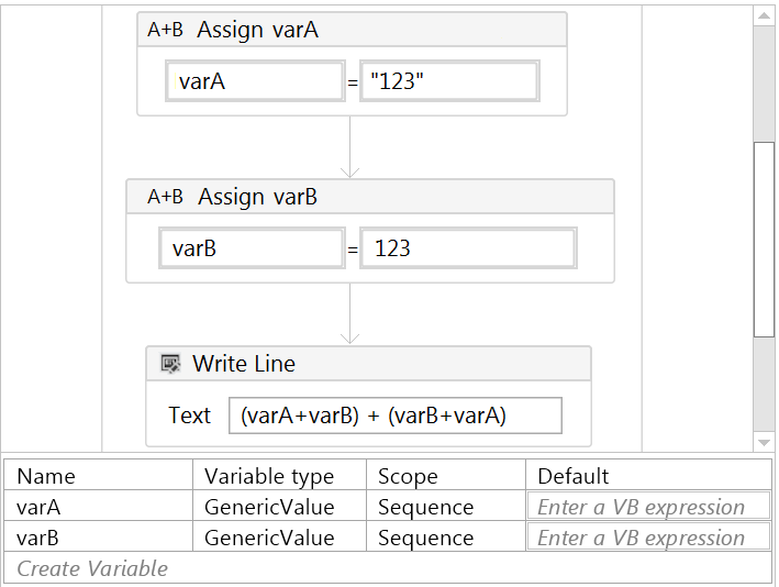

You have two variables, varA and varB, as shown in the following exhibit:
What is the output of the Write Line activity?
  • A. 246246
  • B. 123123246
  • C. 246123123
  • D. 123123123123
