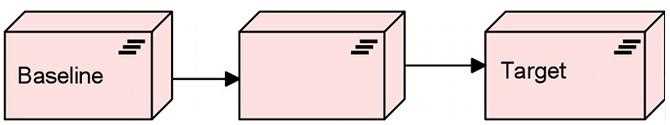

Consider the following diagram, which represents a migration from a Baseline to a Target
Architecture:
Which of the following answers best interprets the unlabeled symbol in the middle of the diagram?
  • A. It represents a relatively stable intermediate state during the migration from the Baseline to the Target Architectures
  • B. It represents a project that progresses the architecture from Baseline to Target
  • C. It represents the deliverables necessary to transform the architecture from Baseline to Target
  • D. It represents a conceptual point of transition between the two architectures, but one that is unlikely to exist in reality for more than an instant

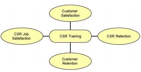

Consider the following diagram, in which CSR stands for Customer Service Representative:
Which of the following statement is expressed by the diagram?
  • A. CSR Training has four key modules, each focusing on a different topic
  • B. The CSR Training business service is valuable in four different ways
  • C. CSR Training is a basic service, upon which four sub-services depend
  • D. CSR Training accesses four different types of information

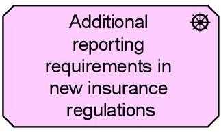

Consider the following symbol, which represents information about a transformation project at
ArchiSurance involving systems and business processes:
Which of the following statements correctly expresses the meaning of the symbol?
  • A. TheArchiSurance legal department has determined the impact of the new regulations
  • B. The project must satisfy requirements for additional reporting
  • C. The additional reporting requirements in new insurance regulations are driving change at ArchiSurance
  • D. The project’s systems must be flexible enough to accommodate any future changes in reporting requirements

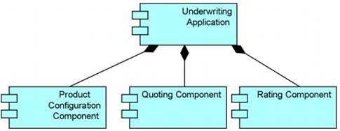

Consider the following diagram:
What does the diagram express about the Underwriting Application?
  • A. It has three distinct components
  • B. It processes three different types of data objects
  • C. It performs three different functions
  • D. It groups together three components that are not a part of the Underwriting Application

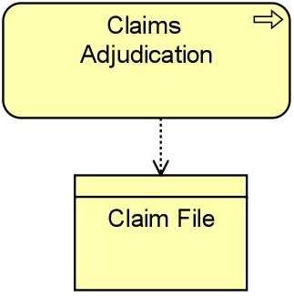

All ArchiSurance divisions use a Claims Adjudication Process specific to their lines of business to
determine whether a claim should be paid as well as the payment amount, Consider the following
diagram:
Which of the following statements is expressed by the diagram?
  • A. The Claims Adjudication Process realizes the Claim File
  • B. Claims are filed after the Claims Adjudication process is complete
  • C. The Claims Adjudication team relies on the Claim File to get its work done
  • D. The Claims Adjudication process accesses the Claim File

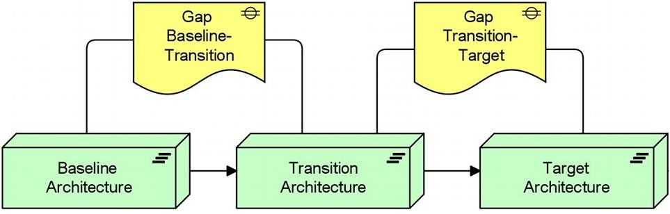

What Implementation & Migration Extension concept is used to model the outcome of an analysis of
the differences betweentwo architectural states?
  • A. Transition
  • B. Gap
  • C. Work Package
  • D. Deliverable

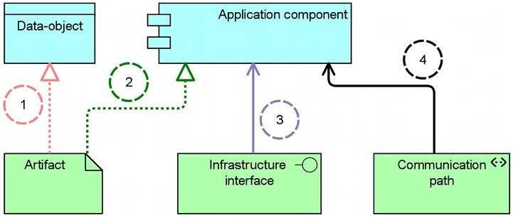

Consider the following diagram with four relationships modeled:
Which relationship modeled in the diagram is not allowed to connect the application layer with the
technology layer?
  • A. Relationship 1
  • B. Relationship 2
  • C. Relationship 3
  • D. Relationship 4

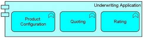

What does the diagram express about the structure of the Underwriting Application?
  • A. The Underwriting Application groups together a number of modules that are either free-standing or part of other applications
  • B. The Underwriting Application is composed of three application components
  • C. The Underwriting Application invokes three other modules
  • D. The Underwriting Application performs three functions

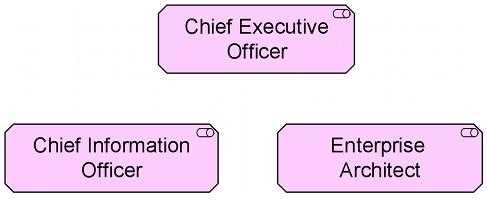

The following diagram shows a typical group of stakeholders:
Which ArchiMate viewpoint abstraction level would support these stakeholders for the purpose of
change management?
A.Coherence
B.Designing
C.Details
D.Overview

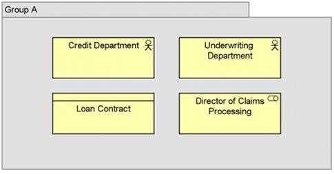

Which of the following best describes the relationship between the four objects in Group A?
  • A. The objects share information
  • B. The objects are collaborating on a key initiative
  • C. The objects were instantiated at the same time
  • D. The objects belong together based on some common characteristic

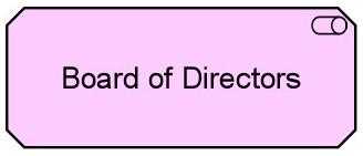

  • A. The Board of Directors will use the transformed systems
  • B. The Board of Directors has a business role in the project
  • C. The transformed systems will store information of interest to the Board of Directors
  • D. The Board of Directors has concerns about the project
