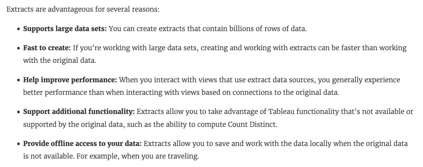

Which of the following are valid reasons to use a Tableau Data Extract (.tde) over Live Connections?
  • A. To support additional functionality such as count distinct
  • B. Fast to create
  • C. Help improve performance
  • D. To have access to the freshest possible data at all times
A, B, C
From the official documentation, the following are the major advantages of using Tableau Data
Extracts:
From Tableau 2020.2 onwards, .hyper is the recommended way since it is faster than .tde!
https://help.tableau.com/current/pro/desktop/en-us/extracting_data.htm

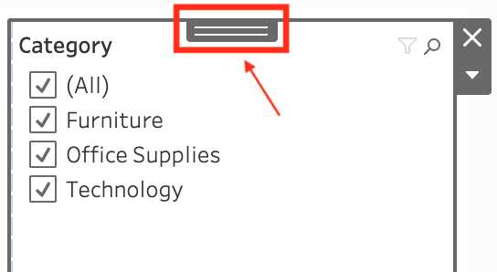

If you have a dashboard and are displaying its filter, how can you rearrange it?
  • A. By clicking on the 2 lines on top and dragging the filter.
  • B. By clicking on the dropdown and dragging the filter
  • C. By clicking on the filter title and dragging it.
  • D. By clicking anywhere inside the filter and dragging it.
You can drag the filter by clicking on the 2 lines on top, and then dragging the filter as shown:

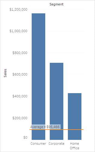

Which of the following can you add a reference line to?
  • A. Groups
  • B. Calculated Fields
  • C. Measures
  • D. Dimensions
You can add reference lines, bands, distributions, or (in Tableau Desktop but not on the web) box
plots to any continuous axis in the view.
Reference Lines - You can add a reference line at a constant or computed value on the axis.
Computed values can be based on a specified field. You can also include confidence intervals with a
reference line.
https://help.tableau.com/current/pro/desktop/en-us/reference_lines.htm

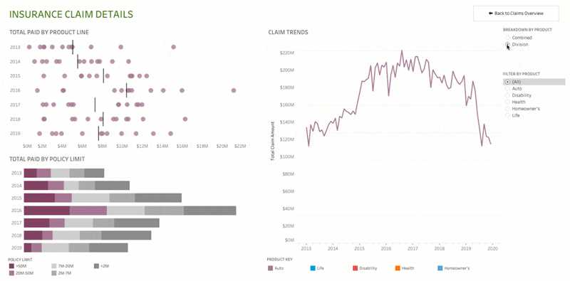

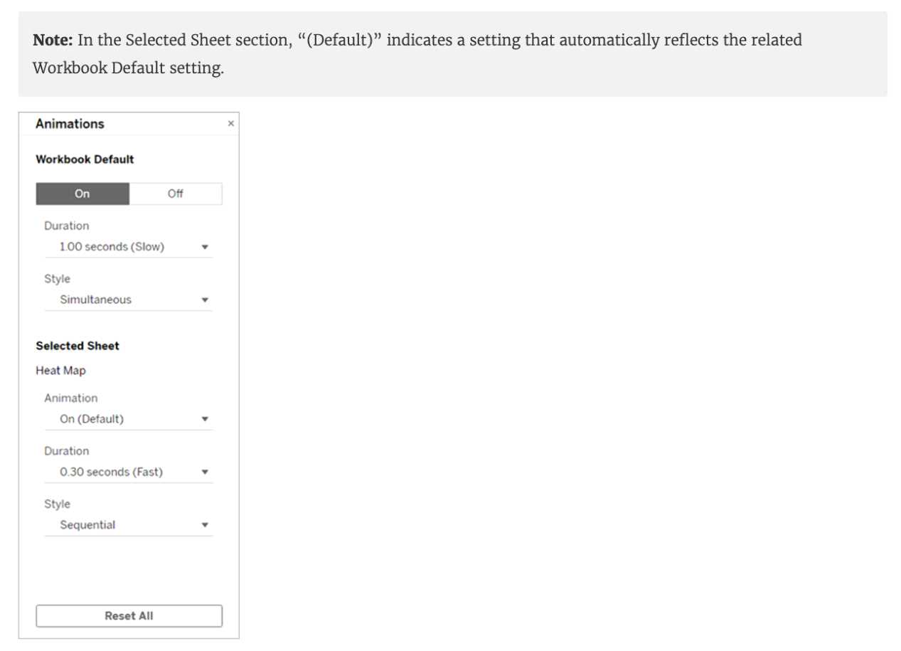

Are animations enabled by default in Tableau?
  • A. No
  • B. Yes
No, by default, animations are not enabled in Tableau.
We can animate visualizations to better highlight changing patterns in your data, reveal spikes and
outliers, and see how data points cluster and separate.
Animations visually transition between filter, sort, and zoom settings, different pages, and changes to
filter, parameter, and set actions. As visualizations animate in response to these changes, viewers can
more clearly see how data differs, helping them make better informed decisions.
When you author animations, you can choose between two different styles: simultaneous or
sequential. Here are examples of each type.
1) Simultaneous animations
The default simultaneous animations are faster and work well when showing value changes in
simpler charts and dashboards.
2) Sequential animations
Sequential animations take more time but make complex changes clearer by presenting them step-
by-step.
To Animate visualizations in a workbook:
1) Choose Format > Animations.
2) If you want to animate every sheet, under Workbook Default, click On. Then do the following:
For Duration, choose a preset, or specify a custom duration of up to 10 seconds.
For Style, choose Simultaneous to play all animations at once or Sequential to fade out marks, move
and sort them, and then fade them in.
3) To override workbook defaults for a particular sheet, change the settings under Selected Sheet.
https://help.tableau.com/current/pro/desktop/en-us/formatting_animations.htm

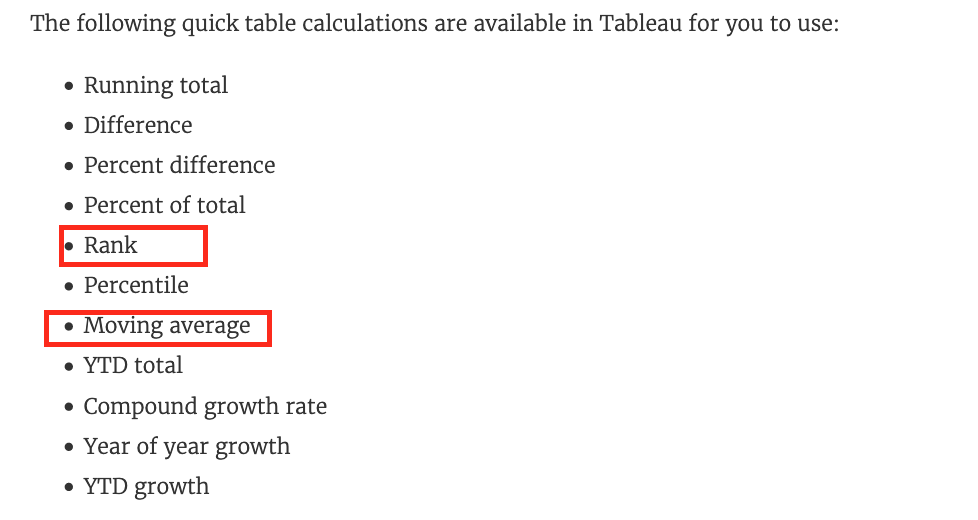

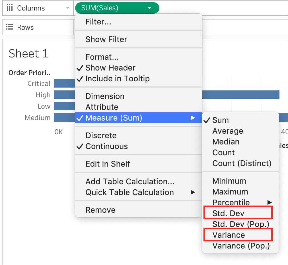

Which of the following calculations DO NOT need a quick table calculation?
A. Variance
B. Rank
C. Moving Average
D. Standard Deviation
For Standard Deviation and Variance, we don't need to use quick table calculations, since they are
available by default. See below:
However, as seen in the types of quick table calculations available in Tableau, Rank and Moving
Average belong to only this category.

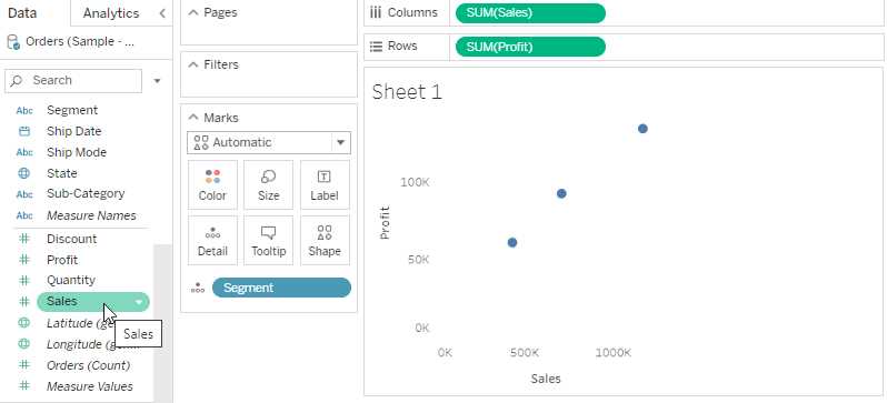

How can you add color to marks in the view in Tableau?
A. Click on Data in the main menu above, and click on choose color.
B. From the Data pane, drag a field to Color on the Marks card.
C. In the column/row shelf, right click the field and click on edit in shelf to select the color.
D. From the Analytics pane, drag a model to Color on the Marks card.
To assign a color to marks in the view, do the following:
Tableau applies different colors to marks based on the fields values and members. For example, if
you drop a discrete field (a blue field), such as Category, on Color, the marks in the view are broken
out by category, and each category is assigned a color.
If you drop a continuous field, such as SUM(sales), on Color, each mark in the view is colored based
on its sales value.

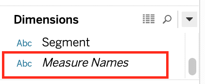

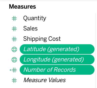

Which one of the following is a dimension?
  • A. Longitude
  • B. Measure Names
  • C. Number of records
  • D. Latitude
Measure Names is a dimension. Latitude, Longitude, and Number of records are all measures.
https://help.tableau.com/current/pro/desktop/en-us/datafields_understanddatawindow.htm

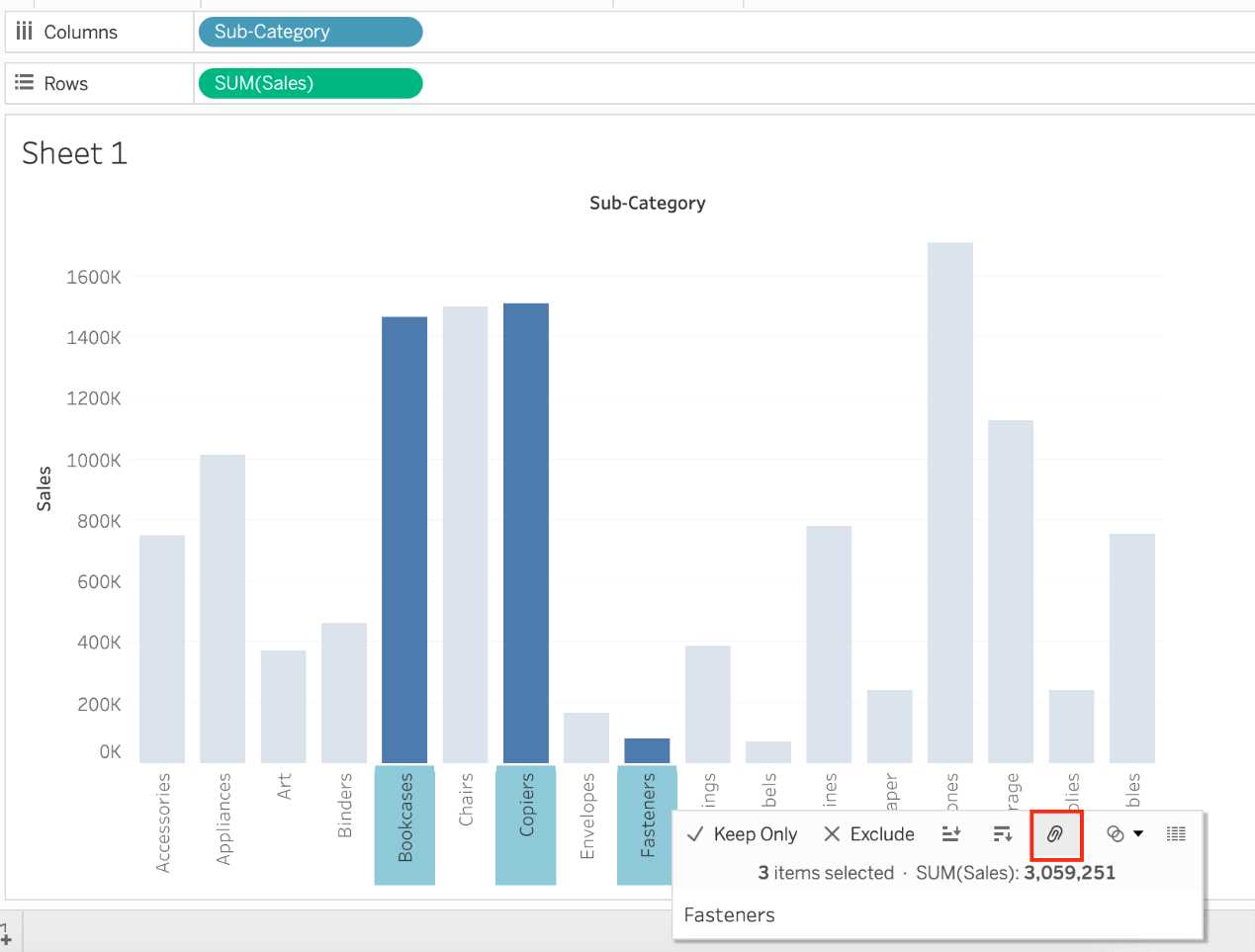

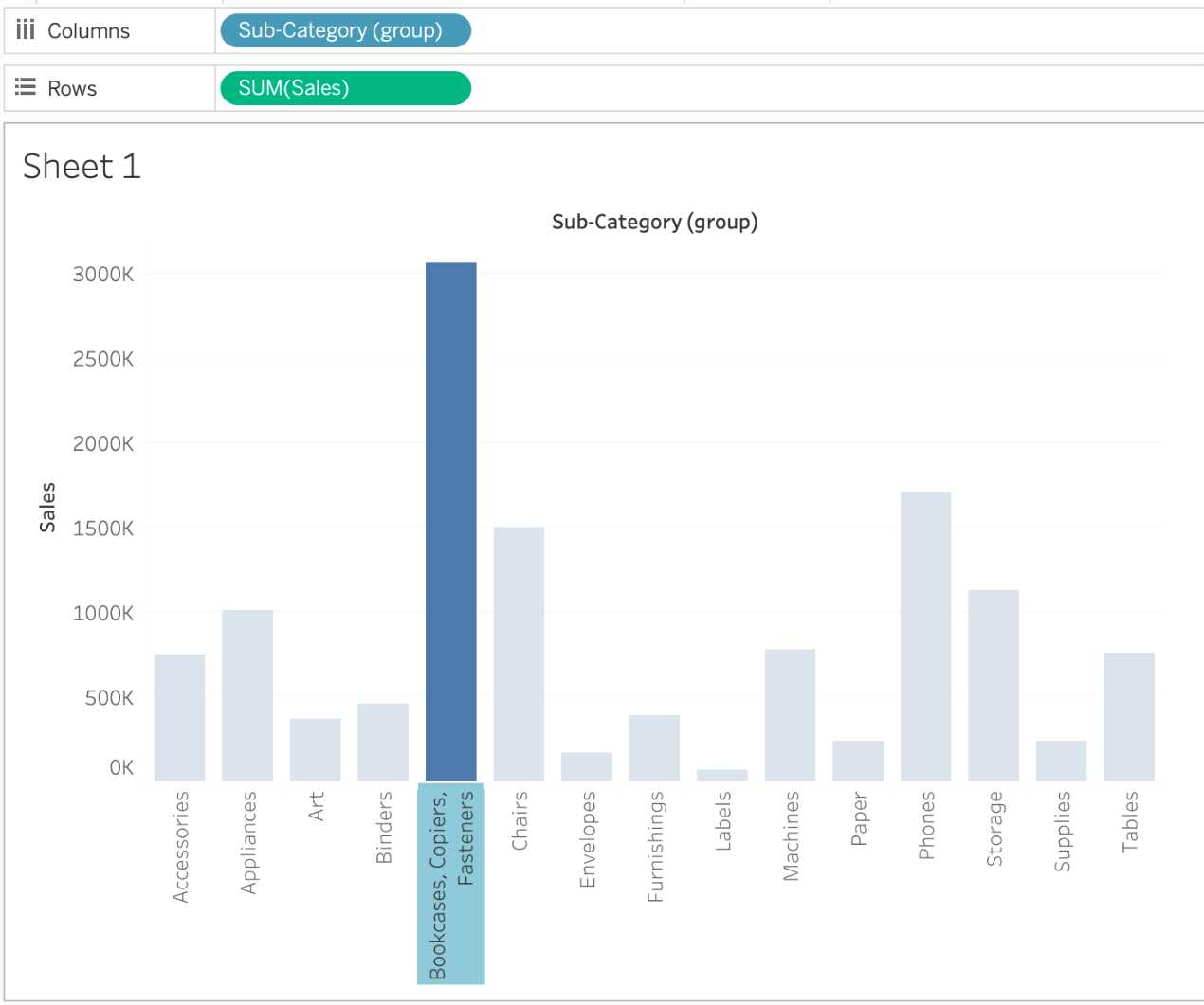

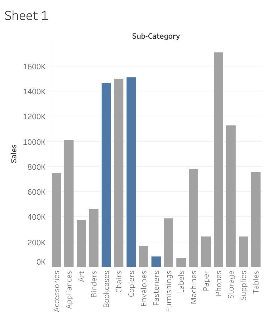

Suppose you have a bar chart. When we group by labels in a view, which of the following happens?
  • A. Nothing changes in the view, but a group is created in the Dimensions shelf.
  • B. The colours of the members selected are now the same, and different for the rest of the members.
  • C. Trick question! It is not possible to group by labels.
  • D. A new mark (bar) is created, which consolidates all members of the group.
*Very important question*
If we select the labels in the view and then group, a new consolidated mark is created - in our case
bar since we are talking about a bar chart in the question. See below:
Then on grouping, a new bar is created, and the colour of all bars remain the same.
Had we grouped by choosing the marks instead of the labels, the following would be the result:
https://help.tableau.com/current/pro/desktop/en-us/sortgroup_groups_creating.htm
