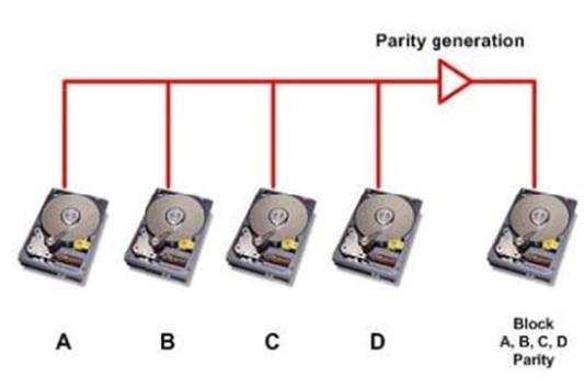

Referring to the exhibit, which RAID level is shown?
  • A. RAID 4
  • B. RAID 5
  • C. RAID 0
  • D. RAID 6

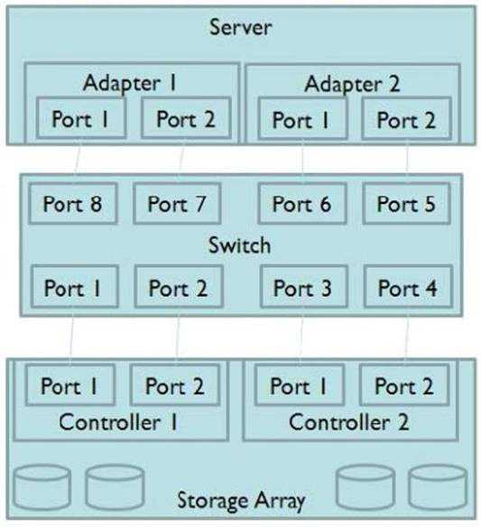

Referring to the exhibit, what are the two largest risks to a highly available solution? (Choose two.)
  • A. Only two adapters per controller
  • B. Only two adapters on the server
  • C. Only one server
  • D. Only one switch
C,D

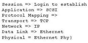

What is the protocol stack shown in the exhibit?
  • A. FCoE
  • B. SCSI
  • C. InfiniBand
  • D. Fibre Channel
