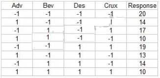

What conclusion is most correct about the Experimental Design shown here with the response in the
far right column?
  • A. No factor has enough statistical confidence greater than 95% to have an impact on the response rate
  • B. Constant, Adv and Bev are the only factors statistically affecting the response rate with 95% confidence or more
  • C. If the Adv is increased from the low level to the high level, the response rate increases
  • D. The response level is statistically concluded to only need the Adv and Bev factors set at the low level to get the largest response rate
  • E. This design does not have enough experimental runs to conclude anything as evidenced by the lack of P-values in the MINITABTM output

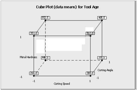

Which statement(s) are correct about the Factorial Plot shown here? (Note: There are 3 correct
answers).
  • A. When the cutting speed increased from low to high level, the tool age increases
  • B. The coefficient of the metal hardness is positively related to the output of tool age
  • C. The coded coefficient is lower for cutting speed than the cutting angle related to the output of tool age
  • D. These plots prove a statistically significance factor with 95% confidence
  • E. These plots are an example of interaction plots
