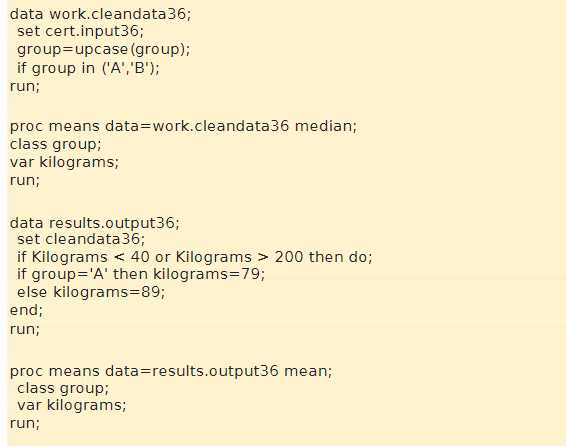

Scenario:
This project will use data setcert.input36. At any time, you may save your program asprogram36 in
cert\programs. Write a SAS program that will clean the data incert.input36as follows:
Step 1:
create a temporary data set, cleandata36.
In this data set, convert all case.
Then keep only observations with group equal to 'A' or 'B'.
Step 2:
Determine the MEDIAN value for the Kilograms variable for each group(A,B) in the cleandata36
data set. Round MEDIAN to the nearest whole number.
Step 3:
Create results.output36 from cleandata36
Ensure that all values for variable Kilogramsare between 40 and 200, inclusively.
If the value is missing or out of range, replace the value with the MEDIAN Kilograms value for the
respectivegroup(A,B) calculated in step 2
How many observations are inresults.output36?
4992
data work.cleandata36;
set cert.input36;
group=upcase(group);
if group in ('A','B');
run;
proc means data=work.cleandata36 median;
class group;
var kilograms;
run;
data results.output36;
set cleandata36;
if Kilograms < 40 or Kilograms > 200 then do;
if group='A' then kilograms=79; else kilograms=89;
end;
run;
proc contents data=results.output36;
run;
SIMULATION
Scenario:
Step 1:
Step 2:
Step 3:
What is the MEAN Kilograms value for group='A' in the results.output36 data set?
76.3
