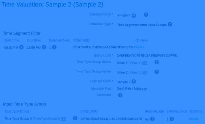

Based on an employee's work schedule, the planned working time is from 09:00 AM to 05:00 PM (9
hours). On the timesheet, the employee enters the actual start and end time as 09:00 AM and 06:00
PM. What will be the hours in Value 1 and Value 2 of the below rule?Note:Time Type Group A in the
Input Time Type Group is the input hours from 09:00 AM to 06:00 PM.No previous and next rules are
considered in this scenario.No other additional scenarios that may alter the working time are
considered in this rule (for example a break or a holiday).
  • A. Value 1 = 1 and Value 2 = 10
  • B. Value 1 = 9 and Value 2 = 1
  • C. Value 1 = 10 and Value 2 = 1
  • D. Value 1 = 1 and Value 2 = 9

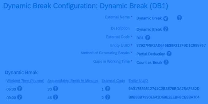

The Dynamic Break configuration below is set up and assigned to an employee.How is the break
provided to this employee?
  • A. 30 minutes of break are provided when the employee completes 6 hours of working time, and another 15 minutes of break are provided when the employee completes 9 hours of working time.
  • B. Both the 30 minutes and 15 minutes of break are provided only when the employee completes 9 hours of working time.
  • C. Both 30 minutes and 45 minutes of break are provided only when the employee completes 9 hours of working time.
  • D. 30 minutes of break are provided when the employee completes 6 hours of working time, and another 45 minutes of break are provided when the employee completes 9 hours of working time.
