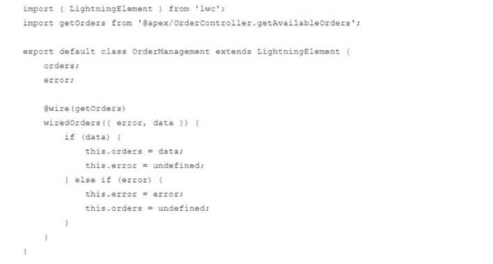

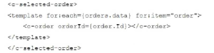

Consider the following code snippet:
How should the <e-orders> component communicate to the <c-selected-orders
component that an order has been selected by the user?
  • A. Create and fire a component event.
  • B. Create and fire an application event.
  • C. Create and fire a standard DOM event.
  • D. Create and dispatch a custom event,
Create and dispatch a custom event. This approach allows LWC components to communicate
effectively, maintaining component encapsulation and reusability.
Reference: Communicating Between Lightning Web Components

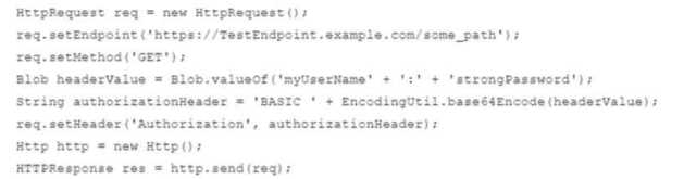

As part of their quoting and ordering process, a company needs to send POFs to their document
storage system's REST endpoint that supports OAuth 2.0. Each Salesforce user must be individually
authenticated with the document storage system to send the PDF.
What is the optimal way for a developer to implement the authentication to the REST endpoint?
  • A. Named Credential with an OAuth Authentication Provider
  • B. Named Credential with Password Authentication
  • C. Hierarchy Custom Setting with an OAuth token custom field
  • D. Hierarchy Custom Setting with 2 password custom field
Named Credentials with OAuth handle secure API calls. Individual authentication for each user with
OAuth 2.0 is managed through Named Credentials.
Reference: Named Credentials as Callout Endpoints

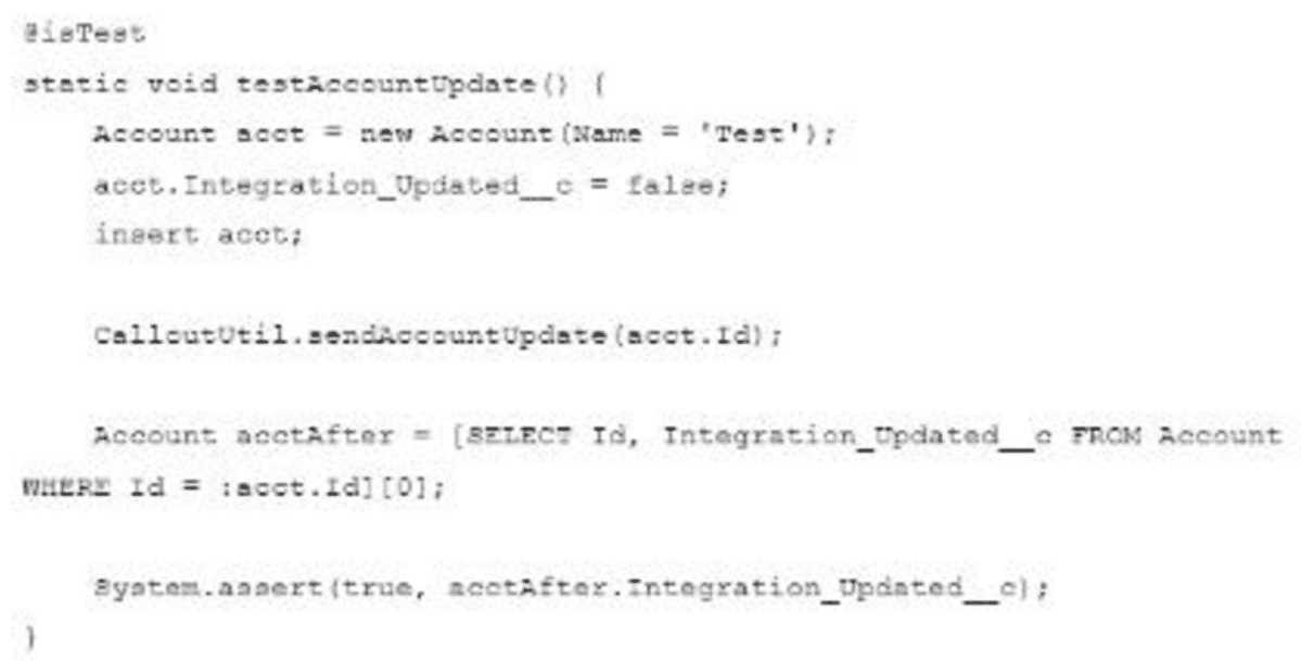

What is the optimal way to fix this?
Test.startTest() and Test.stopTest() should wrap the method call for resource allocation.
Test.setMock() sets a mock callout for the test to handle callouts.
Reference: Apex Developer Guide - Testing HTTP Callouts

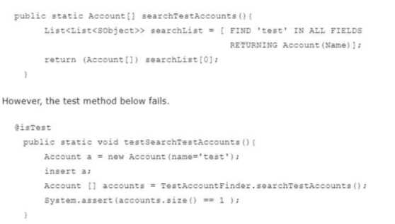

Refer to the test method below''
The test method calls a web service that updates an external system with Account
information and sets the Accounts integration_Updated__c checkbox to True when it completes.
The test fails to execute and exits with an error: "Methods defined as TestMethod do
not support Web service callouts.”
The correct order in tests with callouts is Test.startTest(), then Test.setMock(), followed by the
method invocation, and finally Test.stopTest(). This ensures the mock callout is used.

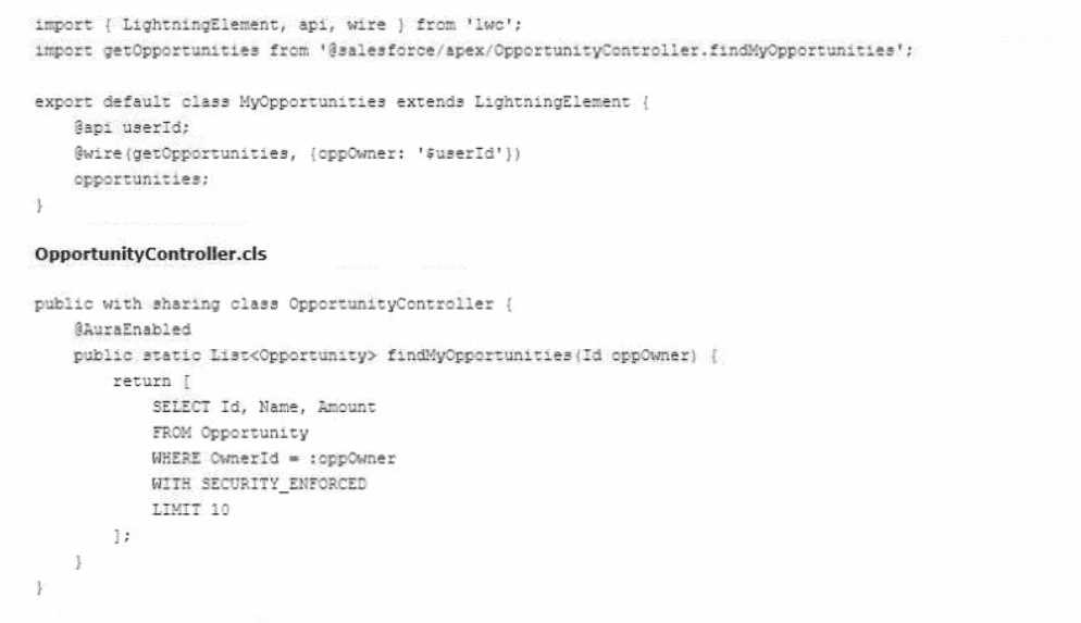

Refer to the following code snippets:
A developer is experiencing issues with a Lightning web component. The component must surface
information about Opportunities owned by the currently logged-in user.
When the component is rendered, the following message is displayed: "Error retrieving data”.
Which modification should be implemented to the Apex class to overcome the issue?
  • A. Use the Cacheable=true attribute in the Apex method,
  • B. Ensure the OWD for the Opportunity object is Public.
  • C. Edit the code to use the w. cut sharing keyword in the Apex class.
  • D. Use the Continuation=true attribute in the Apex method.
The @AuraEnabled(cacheable=true) attribute allows caching of method results on the client side,
reducing server trips for already fetched data, which is useful for read-only data.
