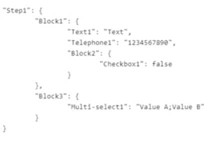

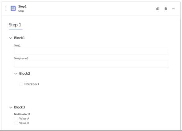

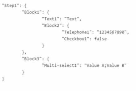

What JSON code correct represent the step in the OmniScript Structure panel shown?

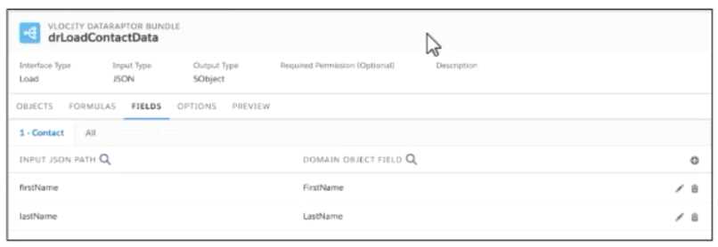

A developer has an existing DataRaptor Load that insert Contact records with inputs as LastName and
firstName. The DataRaptor works as expected when previewed.
The developer creates an integration Procedure to test the DataRaptor and is using a SetValues
element in the Integration Procedure to set the first name and last name for the contact record. The
DataRaptor and Integration Procedure are set up as shown in the exhibit below.
When the developer executes the Integration procedure in preview, the following error message
displays: Required fields are missing: [last Name],
How should the developer address this issue?

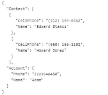

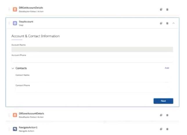

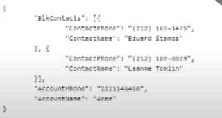

What JSON from the DRGetAccountDetails action would display all six values correctly in the
OmniScript structure shown? BlkContacts is a Repeat Block.

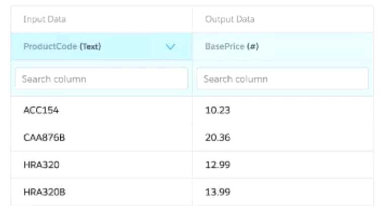

All inputs to the Calculation Matric are set correctly.
The Calculation Matrix has the following input:
What is the output?
  • A. Null
  • B. 13.99
  • C. 12.99,13.99
  • D. 12.99

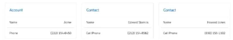

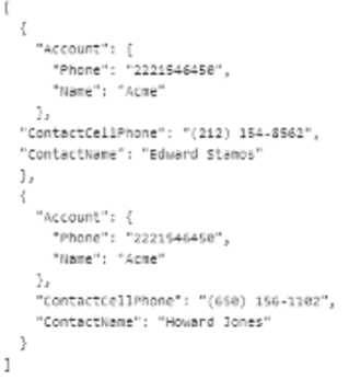

The card layout uses an integration Procedure as a data source. The cards use the layout data source.
Which JSON data structure supports this card layout and follows best practices?

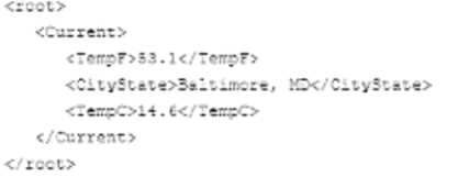

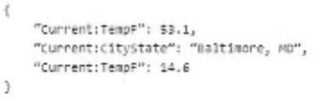

A developer needs to build a DataRaptor Transform to send current weather to both an OmniScript
Card Layout. Which of these samples would be valid for the Expected Output JSON?
