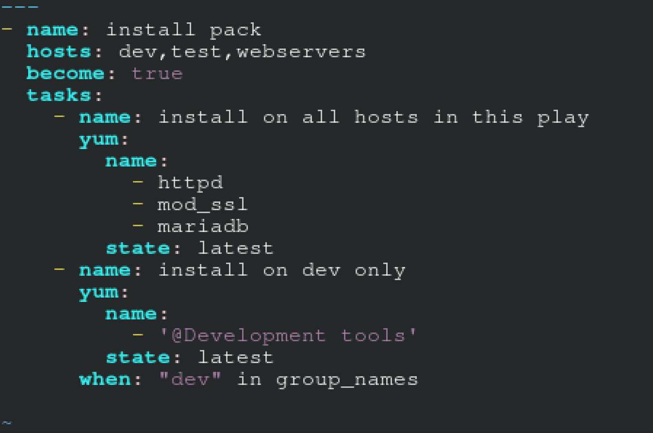

Create a file called packages.yml in /home/sandy/ansible to install some packages for the following
hosts. On dev, prod and webservers install packages httpd, mod_ssl, and mariadb. On dev only install
the development tools package. Also, on dev host update all the packages to the latest.
See the
Explanation for
complete Solution
below.
Solution as:
** NOTE 1 a more acceptable answer is likely 'present' since it's not asking to install the latest
state: present
** NOTE 2 need to update the development node
- name: update all packages on development node
yum:
state: latest

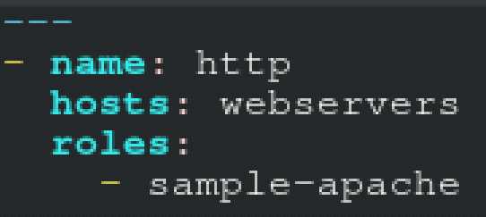

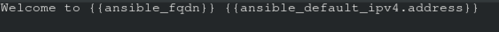

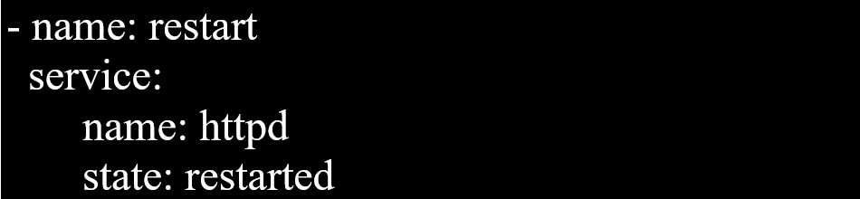

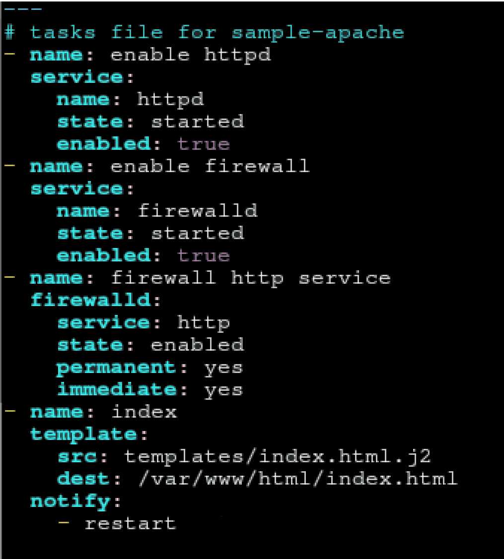

Create a role called sample-apache in /home/sandy/ansible/roles that enables and starts httpd,
enables and starts the firewall and allows the webserver service. Create a template called
index.html.j2 which creates and serves a message from /var/www/html/index.html Whenever the
content of the file changes, restart the webserver service.
Welcome to [FQDN] on [IP]
Replace the FQDN with the fully qualified domain name and IP with the ip address of the node using
ansible facts. Lastly, create a playbook in /home/sandy/ansible/ called apache.yml and use the role
to serve the index file on webserver hosts.
See the
Explanation for
complete Solution
below.
/home/sandy/ansible/apache.yml
/home/sandy/ansible/roles/sample-apache/tasks/main.yml/home/sandy/ansible/roles/sample-apache/templates/index.html.j2
In /home/sandy/ansible/roles/sample-apache/handlers/main.yml

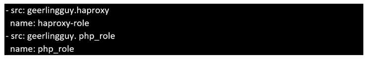

Create a file called requirements.yml in /home/sandy/ansible/roles to install two roles. The source
for the first role is geerlingguy.haproxy and geerlingguy.php. Name the first haproxy-role and the
second php-role. The roles should be installed in /home/sandy/ansible/roles.
See the
Explanation for
complete Solution
below.
vim requirements.yml
Run the requirements file from the roles directory:
ansible-galaxy install -r requirements.yml -p /home/sandy/ansible/roles

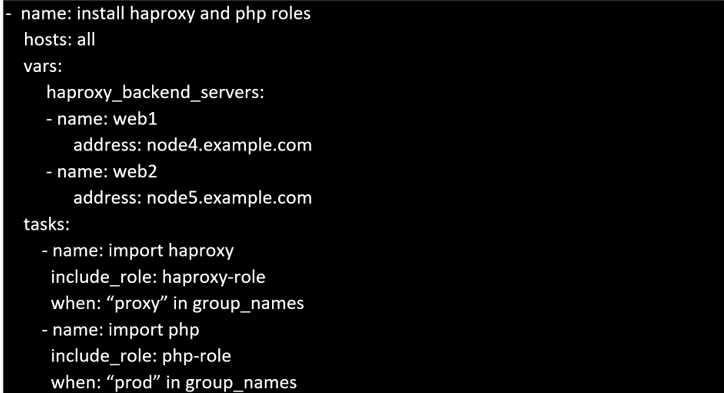

Create a file called requirements.yml in /home/sandy/ansible/roles a file called role.yml in
/home/sandy/ansible/. The haproxy-role should be used on the proxy host. And when you curl
http://node3.example.com
it should display "Welcome to
node4.example.com
" and when you curl
again "Welcome to
node5.example.com
" The php-role should be used on the prod host.
See the
Explanation for
complete Solution
below.
Solution as:
Check the proxy host by curl

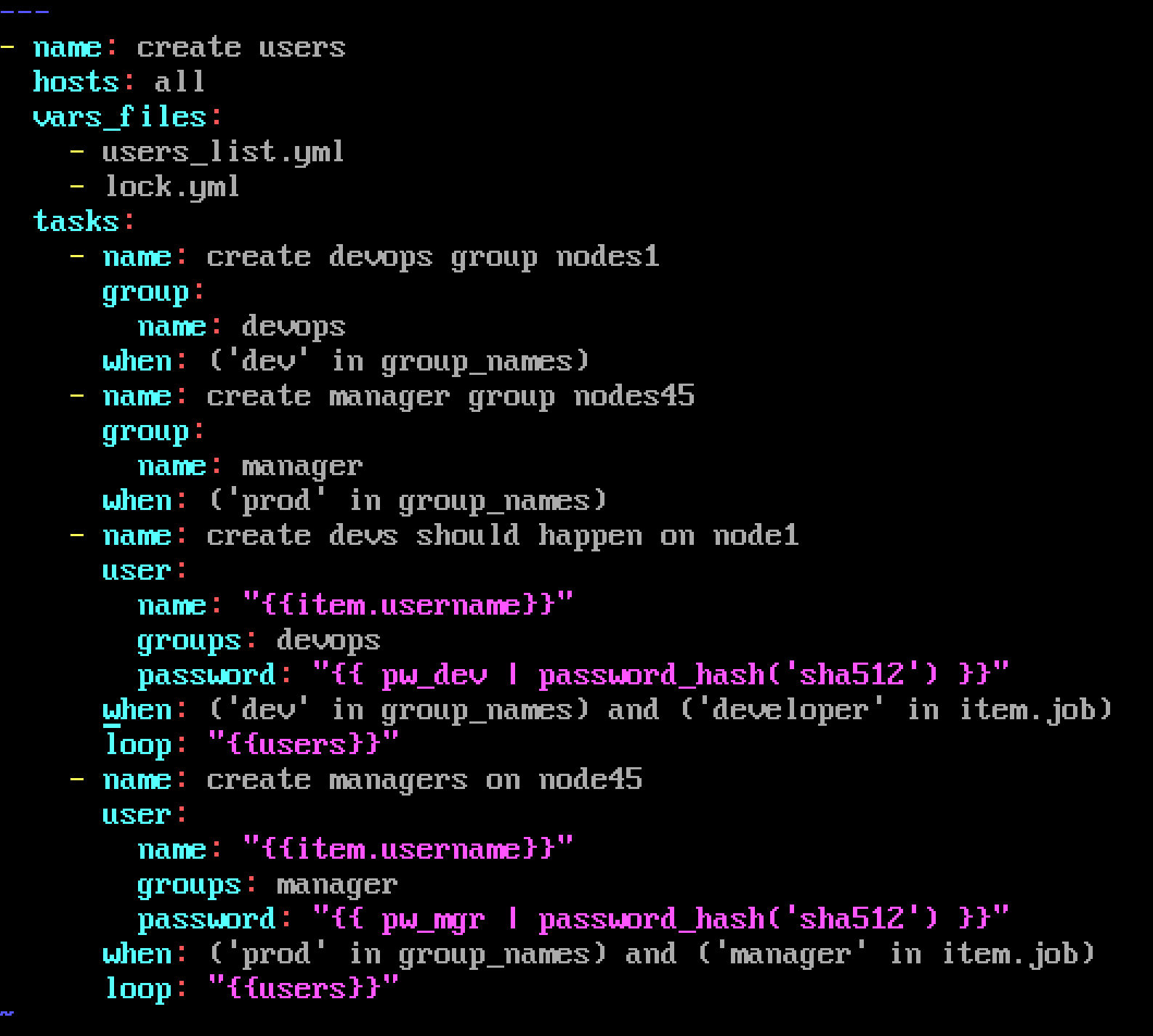

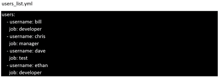

Create the users in the file usersjist.yml file provided. Do this in a playbook called users.yml located
at /home/sandy/ansible. The passwords for these users should be set using the lock.yml file from
TASK7. When running the playbook, the lock.yml file should be unlocked with secret.txt file from
TASK 7.
All users with the job of 'developer' should be created on the dev hosts, add them to the group
devops, their password should be set using the pw_dev variable. Likewise create users with the job
of 'manager' on the proxy host and add the users to the group 'managers', their password should be
set using the pw_mgr variable.
See the
Explanation for
complete Solution
below.
ansible-playbook users.yml –vault-password-file=secret.txt

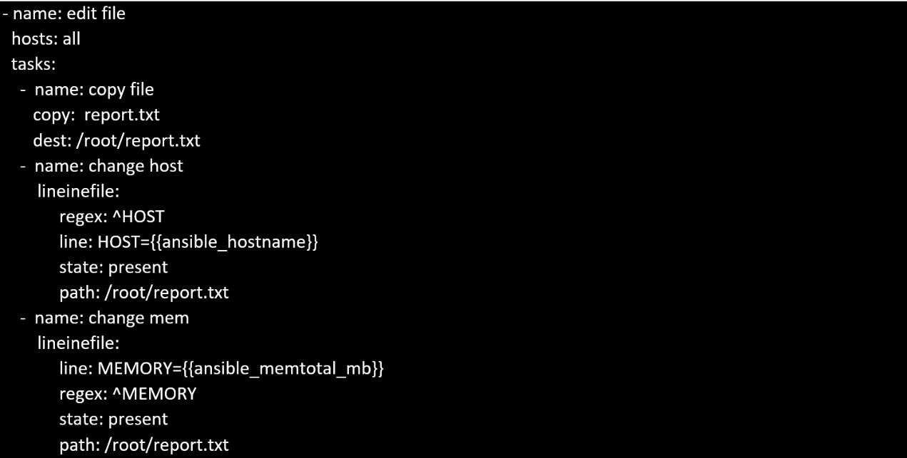

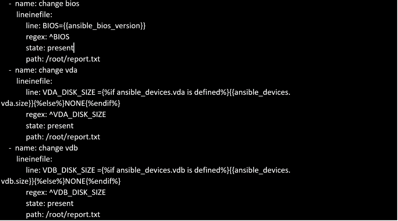

Create a file called specs.empty in home/bob/ansible on the local machine as follows:
HOST=
MEMORY=
BIOS=
VDA_DISK_SIZE=
VDB_DISK_SIZE=
Create the playbook /home/bob/ansible/specs.yml which copies specs.empty to all remote nodes'
path /root/specs.txt. Using the specs.yml playbook then edit specs.txt on the remote machines to
reflect the appropriate ansible facts.
See the
Explanation for
complete Solution
below.
Solution as:

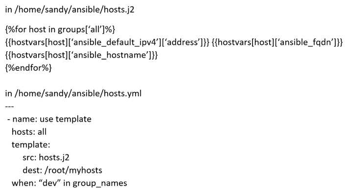

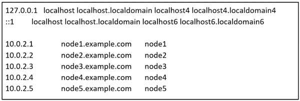

Create a jinja template in /home/sandy/ansible/ and name it hosts.j2. Edit this file so it looks like the
one below. The order of the nodes doesn't matter. Then create a playbook in /home/sandy/ansible
called hosts.yml and install the template on dev node at /root/myhosts
See the
Explanation for
complete Solution
below.
Solution as:

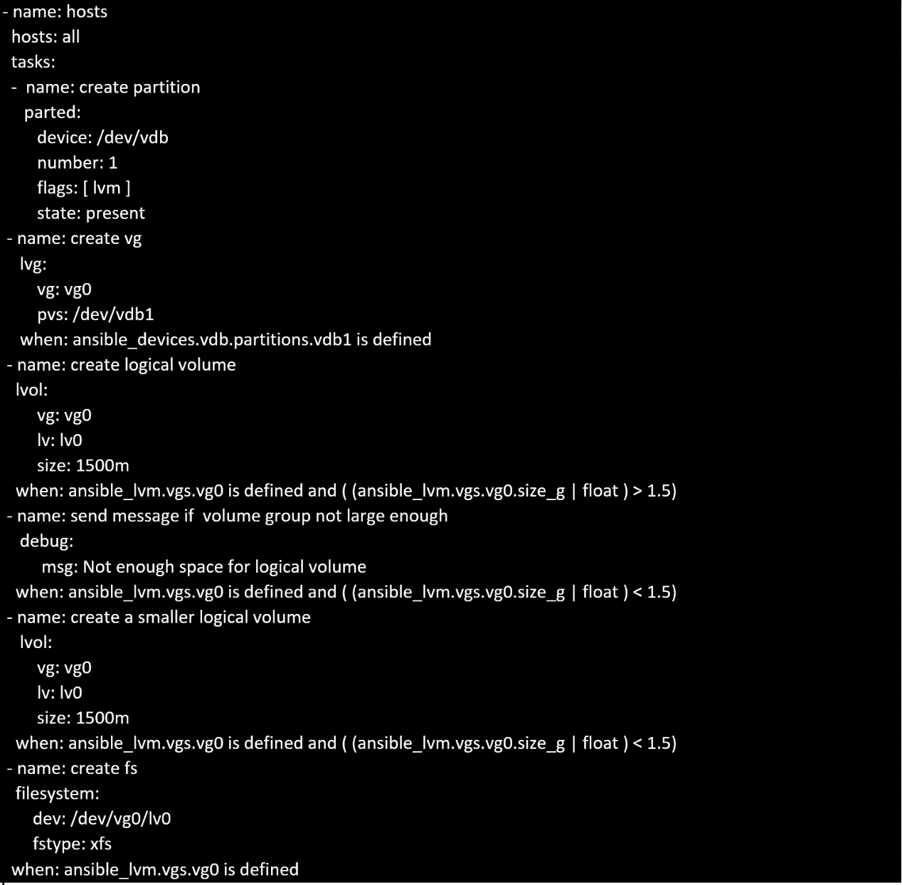

In /home/sandy/ansible/ create a playbook called logvol.yml. In the play create a logical volume
called Iv0 and make it of size 1500MiB on volume group vgO If there is not enough space in the
volume group print a message "Not enough space for logical volume" and then make a 800MiB Iv0
instead. If the volume group still doesn't exist, create a message "Volume group doesn't exist" Create
an xfs filesystem on all Iv0 logical volumes. Don't mount the logical volume.
See the
Explanation for
complete Solution
below.
Solution as:

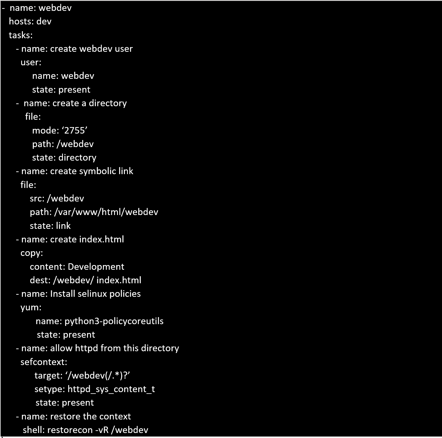

Create a playbook called webdev.yml in 'home/sandy/ansible. The playbook will create a directory
Avcbdev on dev host. The permission of the directory are 2755 and owner is webdev. Create a
symbolic link from /Webdev to /var/www/html/webdev. Serve a file from Avebdev7index.html
which displays the text "Development" Curl
http://node1.example.com/webdev/index.html
to test
See the
Explanation for
complete Solution
below.
Solution as:

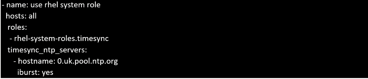

Create a playbook called timesvnc.yml in /home/sandy/ansible using rhel system role timesync. Set
the time to use currently configured nip with the server 0.uk.
pool.ntp.org
. Enable burst. Do this on
all hosts.
See the
Explanation for
complete Solution
below.
Solution as:

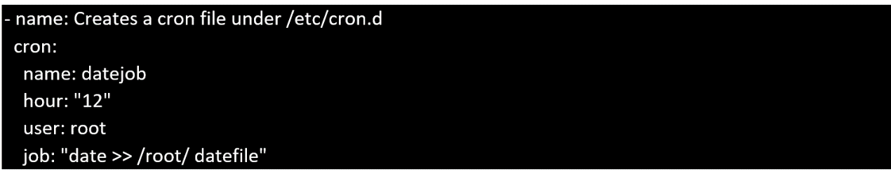

Create a playbook called regulartasks.yml which has the system that append the date to
/root/datefile every day at noon. Name is job 'datejob'
See the
Explanation for
complete Solution
below.
Solution as:

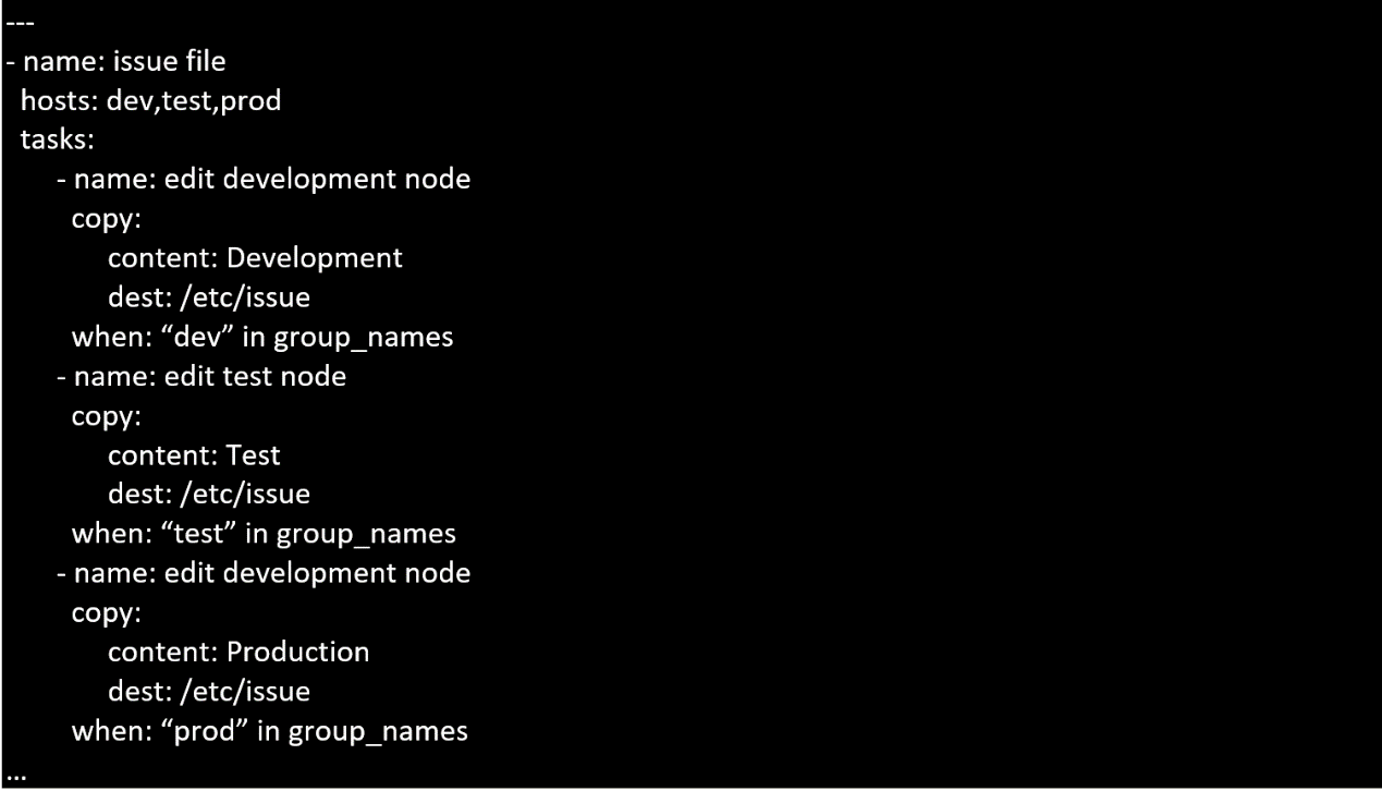

Create a playbook called issue.yml in /home/sandy/ansible which changes the file /etc/issue on all
managed nodes: If host is a member of (lev then write "Development" If host is a member of test
then write "Test" If host is a member of prod then write "Production"
See the
Explanation for
complete Solution
below.
Solution as:
