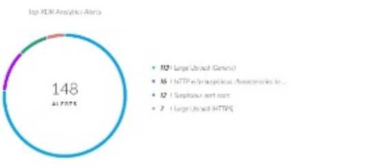

[Dashboards and Reporting]
An engineer is building a dashboard to visualize the number of alerts from various sources. One of
the widgets from the dashboard is shown in the image below:
The engineer wants to configure a drilldown on this widget to allow dashboard users to select any of
the alert names and view those alerts with additional relevant details. The engineer has configured
the following XQL query to meet the requirement:
dataset = alerts
| fields alert_name, description, alert_source, severity, original_tags, alert_id, incident_id
| filter alert_name =
| sort desc _time
How will the engineer complete the third line of the query (filter alert_name =) to allow dynamic
filtering on a selected alert name?
  • A. $y_axis.value
  • B. $x_axis.value
  • C. $x_axis.name
  • D. $y_axis.name

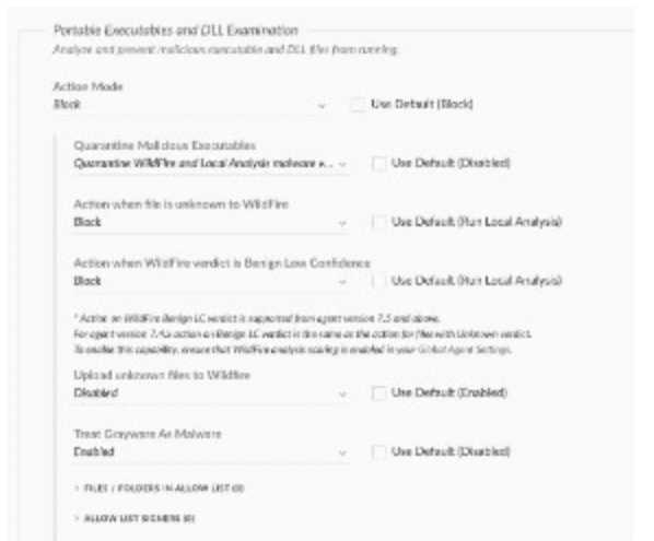

[Cortex XDR Agent Configuration]
Based on the Malware profile image below, what happens when a new custom-developed
application attempts to execute on an endpoint?
  • A. It will immediately execute
  • B. It will not execute
  • C. It will execute after one hour
  • D. It will execute after the second attempt
