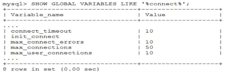

An employee cannot access the company database. You check the connection variables:
A look at the user privileges shows:
What is a valid explanation for why one of the users is unable to connect to the database?
  • A. Bob has max_user_connections set to zero, which blocks all his connections.
  • B. All users are blocked because max_user_connections is accumulated over the host account information.
  • C. connect_timeout is too small to allow a connection to occur.
  • D. Joe has exceeded the max_user_connections global limit.
  • E. Kay is already connected elsewhere and attempting to log in again.

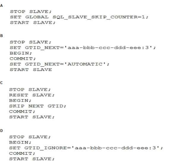

You are using GTIDS in replication. You need to skip a transaction with the GTID of aaa-bbb-ccc-ddd-
eee:3 on a slave.
Which procedure would you execute from a MySQL prompt?
You have created a backup of the sales database with the command:
Which two procedures can be used to restore the orders table from the backup?
B,C

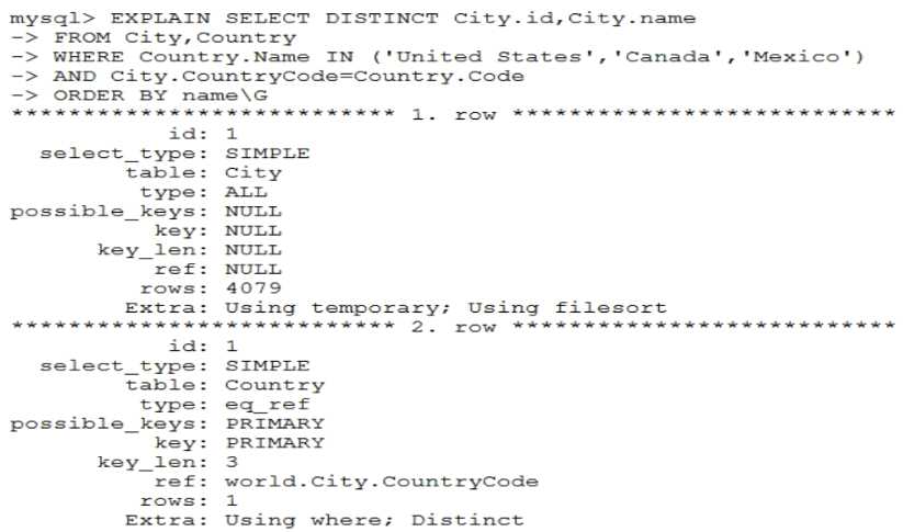

Consider:
Which statement best describes the meaning of the values in the ref columns?
  • A. world.City.CountryCode is used as the primary key for the Country table.
  • B. No indexed columns are used to select rows from the City table. The world.City.CountryCode column is used to select rows in the Country table.
  • C. world.City.CountryCode is used to sort the rows in the City table.
  • D. No indexed columns are used to select rows from the Country table. The world.City.CountryCode column is used to select rows in the City table.
