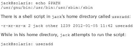

User jack, whose account is configured to use the korn shell, logs in and examines the value of his
PATH environment variable:
What will happen, and why?
  • A. He will get a "file not found" error, because the current directory is not in his seaech path.
  • B. He will get a "file not found" error, because his home directory is not in his search path.
  • C. The useradd script will execute, because jack is in the same directory that the script is located in.
  • D. The command /user/sbin/useradd will execute, because it is the last match in the search path.
  • E. The command /user/sbin/useradd will execute, because it is the first match in the search path.
