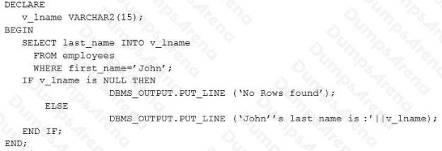

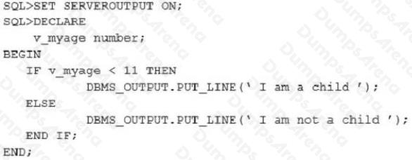

Examine the following code:
Which statement is true about the execution of the above code?
  • A. It executes and displays null.
  • B. It executes and the condition returns true.
  • C. It executes and control goes to the else statement.
  • D. It fails because no value is assigned to the v_myage variable.
D 3 votes

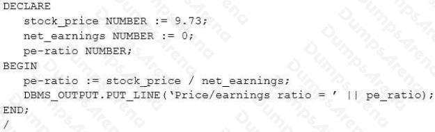

Examine the following PL/SQL code:
Which statement is true about the execution of the code if the query in the PL/SQL block returns no rows?
  • A. The program abruptly terminates and an exception is raised.
  • B. The program executes successfully and the output is No ROWS_FOUND.
  • C. The program executes successfully and the query fetches a null value in the V_LNAME variable.
  • D. Program executes successfully, fetches a NULL value in the V_LNAME variable and an exception is raised.

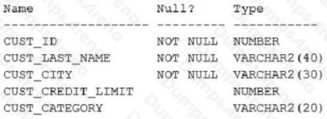

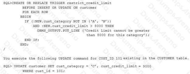

View the Exhibit and examine the structure of the customer table.
You create the following trigger to ensure that customers belonging to category "A" or "B" in the customer table can have a
credit limit of more than 8000.
What is the outcome?
  • A. The trigger is fired, a message is displayed, and the update is successful.
  • B. The trigger is fired and a message is displayed, but the update is rolled back.
  • C. The trigger is not fired because the when clause should be used to specify the condition, however, the update is successful.
  • D. The trigger is not fired because column names must be specified with the update event to identify which columns must be changed to cause the trigger to fire, however, the update is successful.

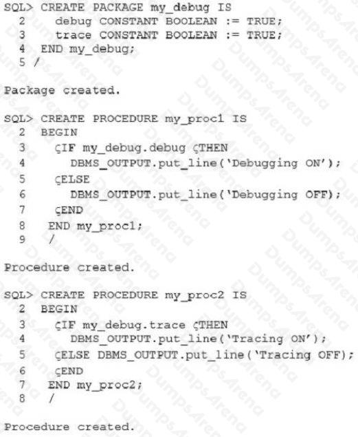

View the Exhibit and examine the code and its outcome on execution:
What would be the effect on the two procedures if the value of debug is set to false? (Choose two.)
  • A. MY_PROC2 is not recompiled.
  • B. MY_PROC1 is recompiled but remains unchanged.
  • C. MY_PROC2 is recompiled but remains unchanged.
  • D. MY_PROC1 is recompiled without the debugging code.
C D

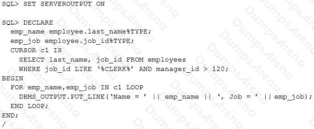

Examine the following PL/SQL code;
The execution of the code produces errors. Identify the error in the code.
  • A. The open cursor is missing.
  • B. The fetch clause is missing.
  • C. The exit when condition is missing.
  • D. The EMP_NAME and EMP_JOB variables cannot be used in the for clause of the cursor FOR statement.

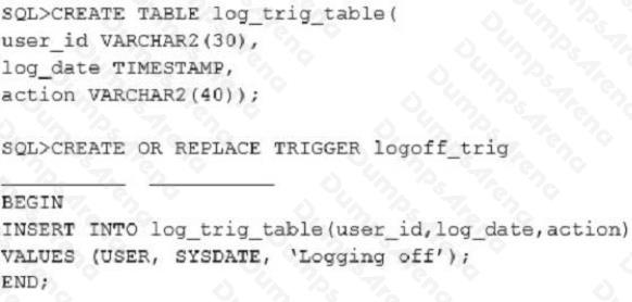

You want to maintain an audit of the date and time when each user of the database logs off.
Which two clauses should be used to fill in the blanks and complete the above code? (Choose two.)
  • A. ON SCHEMA
  • B. ON QRXABASE
  • C. AFTER LOGOFF
  • D. BEFORE LOGOFF
B D

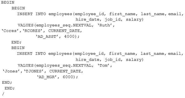

View the exhibit and examine the structure of the EMPLOYEE table.
EMPLOYEE_SEQ is an existing sequence.
Examine the following block of code:
Which statement is true about the above block of code?
  • A. It consists of two transactions
  • B. It consists of a single transaction.
  • C. The data is automatically committed after the block execution ends.
  • D. It gives an error on execution because sequences cannot be used in anonymous blocks.

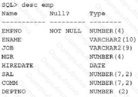

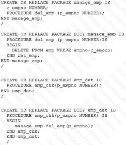

View Exhibit 1 and examine the structure of the EMP table.
View Exhibit 2 and examine the code of the packages that you have created.
You issue the following command:
SQL> DROP PACKAGE manage_emp;
  • A. It drops both the MANAGE_EMP AND EMP__DET packages because of the cascading effect.
  • B. It drops the MANAGE_EMP package and invalidates only the body for the EMP_DET package.
  • C. It returns an error and does not drop the MAMAGE_EMP package because of the cascading effect.
  • D. It drops the MANAGE_EMP package and invalidates both the specification and body for the EMP_DET package.
C 2 votes

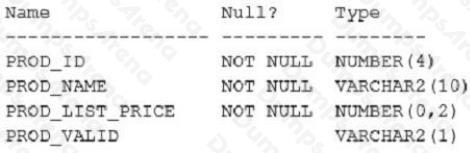

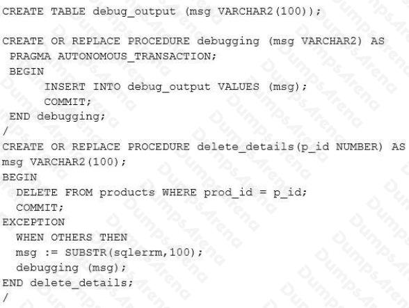

View the exhibit and examine the structure of the products table.
Which statement is true when the procedure DELETE_DETAILS is invoked?
  • A. It executes successfully but no error messages get recorded in the DEBUG_OUTPUT table
  • B. It executes successfully and any error messages get recorded in the DEBUG_OUTPUT table.
  • C. It gives an error because PRAGMA AUTONOMOUS_TRANSACTION can be used only in packaged procedures.
  • D. It gives an error because procedures containing PRAGMA AUTONOMOUS_TRANSACTION cannot be called from the exception section.
In this case, the debug output will only occur if there is an exception.
