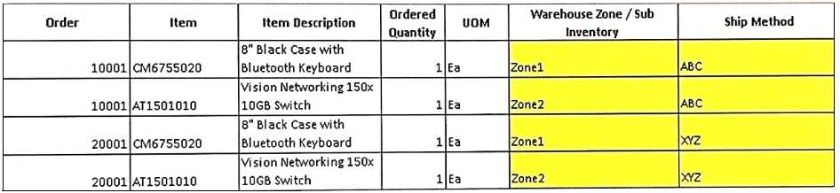

Your company has a warehouse that is classified as two different zones to enforce allocation and
picking from only one subinventory at a time. The business has a contract with a specific outbound
logistics carrier to deliver all orders for a particular customer zone or postal code.
How do you release orders that are scheduled to be fulfilled from a particular subinventory and
delivered through a specific carrier?
  • A. Define pick wave release rules specifying the shipment method and the subinventory on the Demand Selection Criteria tab.
  • B. Define a release sequence rule using the attribute as subinventory.
  • C. Use a picking rule specifying the pickling order for the subinventory.
  • D. Define pick wave release rules specifying the shipment method and pick from a subinventory under the Options tab.
  • E. Define a release sequence rule using the attribute as shipment priority.
