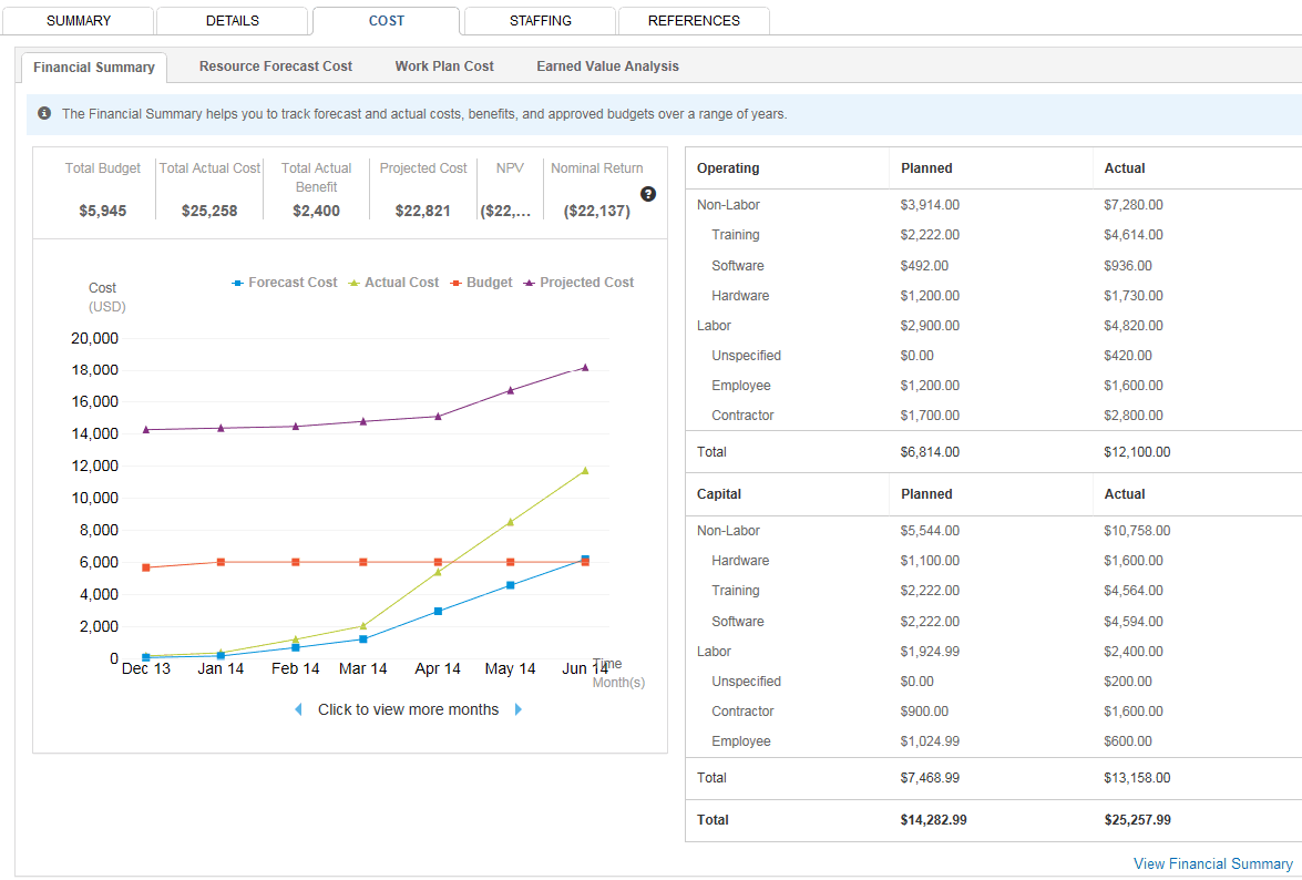

Your customer wants to calculate Estimate to Complete (ETC) as the difference between Current
Planned Cost and Actual Cost. In Progress Settings, which option would you use in conjunction with
the ETC method to meet this requirement? (Choose the best answer.)
  • A. Effort
  • B. Cost
  • C. Manual Entry
  • D. Remaining Plan
https://ppm-
help.saas.hpe.com/en/9.42/Help/Content/UG/PjMUG/view_pj_cost_data_costtab.htm
Below is an example of the Financial Summary view on the Cost tab of the Project Overview page.
