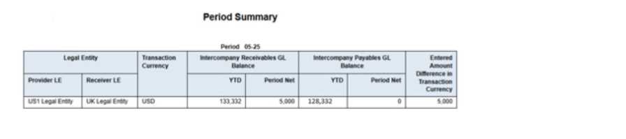

You are reviewing the Intercompany Reconciliation report for the current period and notice that
there is a difference for the period as indicated.
What could be reason for this difference?
  • A. The transaction needs to be transferred to Payables and accounted in the UK ledger.
  • B. The transaction needs to be transferred to Payables and accounted in the US ledger.
  • C. The transaction needs to be transferred to Receivables and accounted in the UK ledger.
  • D. The transaction needs to be transferred to Receivables and accounted in the US ledger.
