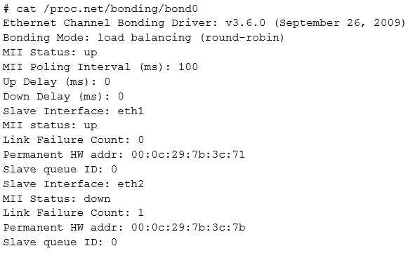

Examine the output of a bonded interface configuration from which one network cable has been
unplugged:
Which statement is true when you plug in the eth2 network cable?
  • A. The file system was exported on host o16 using the ROOT_SQUASH option.
  • A. The status of the slave interface eth2 changes to up and becomes a backup slave
  • B. The /export filesystem was mounted with the NOEXEC option on host o16.
  • B. The status of the slave interface eth2 changes to up and becomes a second active slave.
  • C. The filesystem mounted on /mnt was mounted with the NOEXEC option.
  • C. The status of the slave interface eth2 changes to up but must be manually assigned the active or backup slave role.
  • D. The filesystem was exported on host o16 by using the NO_ROOT_SQUASH option.
  • D. The status of the slave interface eth2 changes to up and is promoted to the primary active slave whereas eth1 becomes the backup slave
