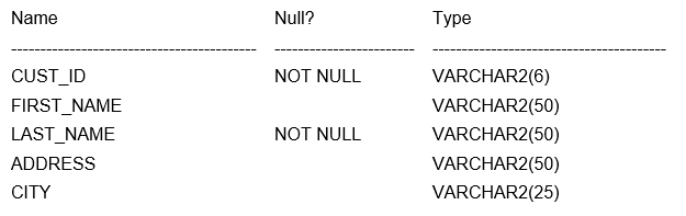

Examine the description of the CUSTOMERS table:
You want to display details of all customers who reside in cities starting with the letter D followed by
at least two characters.
Which query can be used?
  • A. SELECT * FROM customers WHERE city LIKE ‘D_%’;
  • B. SELECT * FROM customers WHERE city = ‘%D_’;
  • C. SELECT * FROM customers WHERE city LIKE ‘D_’;
  • D. SELECT * FROM customers WHERE city = ‘D_%’;
A 3 votes

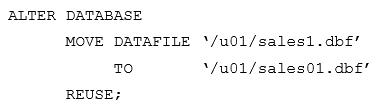

Examine this command:
Which two statements are true? (Choose two.)
  • A. DML may be performed on tables with one or more extents in this data file during the execution of this command.
  • B. The tablespace containing SALES1.DBF must be altered READ ONLY before executing the command.
  • C. The tablespace containing SALES1.DBF must be altered OFFLINE before executing the command.
  • D. If Oracle Managed Files (OMF) is used, then the file is renamed but moved to DB_CREATE_FILE_DEST.
  • E. The file is renamed and stored in the same location
A, E
E 1 votes
