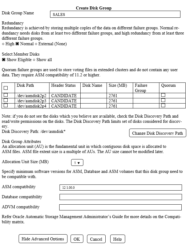

View the Exhibit.
Which three statements are true? (Choose three.)
  • A. It applies a patch to the Grid Infrastructure only on the first cluster node.
  • A. The three listed disks may have previously belonged to a disk group.
  • B. It applies a patch to the Grid Infrastructure on all cluster nodes.
  • B. The three listed disks may already be members of an existing disk group.
  • C. It applies a patch to all database ORACLE_HOMEs, with the same release as the Grid Infrastructure, only on the first cluster node.
  • C. To allow an 11g R2 database to use this disk group, ASM Compatibility must be 11.2 or lower.
  • D. It applies a patch to all database ORACLE_HOMEs, with the same release as the Grid Infrastructure, on all cluster nodes.
  • D. The COMPATIBLE parameter of any database client using this disk group can be less than or equal to 12.1.
  • E. It applies a patch to all database ORACLE_HOMEs of any version on the first cluster node.
  • E. ADVM compatibility can be set greater than or equal to 11.2 without changing the value of ASM compatibility.
  • F. It applies a patch to all database ORACLE_HOMEs of any version on all cluster nodes.
  • F. The three listed disks are have definitely not been provisioned using ASMLIB.
D,E,F
