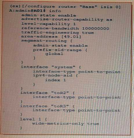

Based upon the exhibit, which of the following statements regarding the configuration is FALSE?
  • A. Traffic engineering information will only be advertised for the interfaces that have both MPLS and RSVP enabled.
  • B. The Node-SID assigned to this router is the second label in the defined range.
  • C. Traffic engineering has been enabled on this router.
  • D. Adjacency-SID labels will not be advertised as they have not been defined under the physical interfaces.
