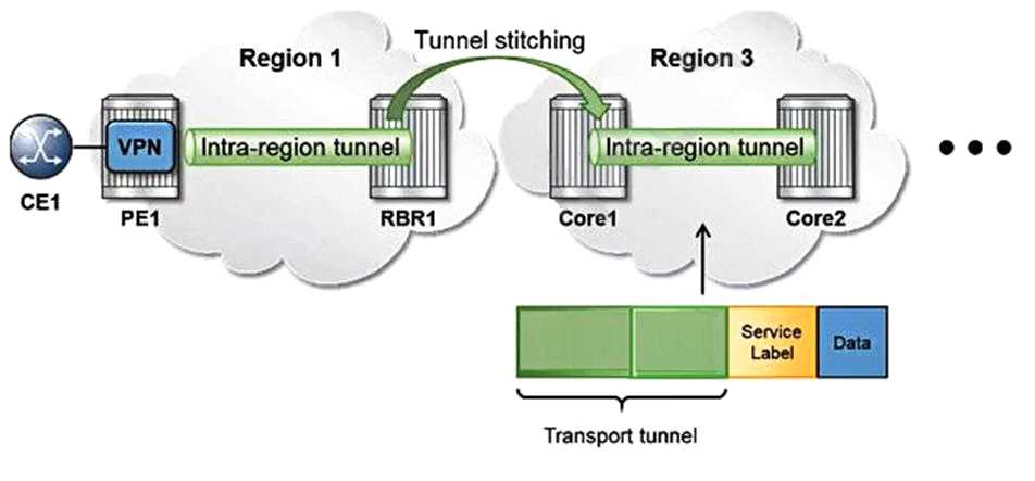

In the diagram below, a data packet is sent from CE1 to a far-end CE2 over a VPRN service across
multiple regions. Which of the following statements about the tunnel labels is FALSE?
  • A. The outer label is an RSVP, LDP, or segment routing label pushed by router Core1.
  • B. The second label is a BGP label pushed by router RBR1.
  • C. The service label is a label pushed by router PE1.
  • D. The outer label will be popped by router Core2.

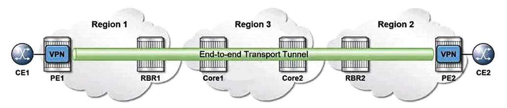

In the diagram below, an end-to-end transport tunnel needs to be established between PE1 and PE2
using MP-BGP. Which of the following items is NOT required?
  • A. MP-BGP address families label-ipv4 or label-ipv6 need to be supported on each of the edge routers.
  • B. Either RSVP, LDP, or segment routing tunnels need to be established between regions.
  • C. Either RSVP, LDP, or segment routing tunnels need to be established within each region.
  • D. Each PE router needs to advertise an IP address as a labeled BGP route to identify the tunnel endpoint.
