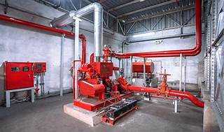

A multistage centrifugal fire pump is defined as
  • A. a pump installed on more than one floor or one building.
  • B. requiring more than one input location connection.
  • C. being able to operate with a diesel, steam or electric driver.
  • D. having two or more impellers on one shaft as a single unit.
Explore
A multistage centrifugal fire pump is defined as having two or more impellers on one shaft as a
single unit. A multistage centrifugal pump is a type of centrifugal pump that uses multiple impellers
to increase the pressure and flow of water.
Each impeller acts like a single-stage pump within a chain
of pumps, and the water passes through each impeller in series, gaining pressure and velocity at
each stage1
A multistage centrifugal fire pump is used to provide high-pressure water for fire
protection systems, especially in high-rise buildings or large industrial facilities2
A multistage
centrifugal fire pump can be driven by an electric motor, a diesel engine, or a steam turbine3
Our Guide to Multistage Centrifugal Pumps | C&B Equipment
Fire Pump Types | NFPA
NFPA 20: Changes to the fire pump standard - Consulting
