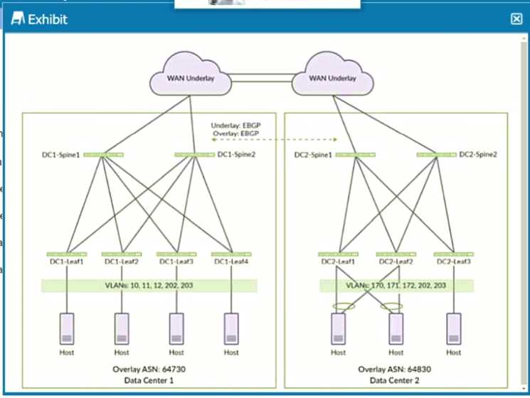

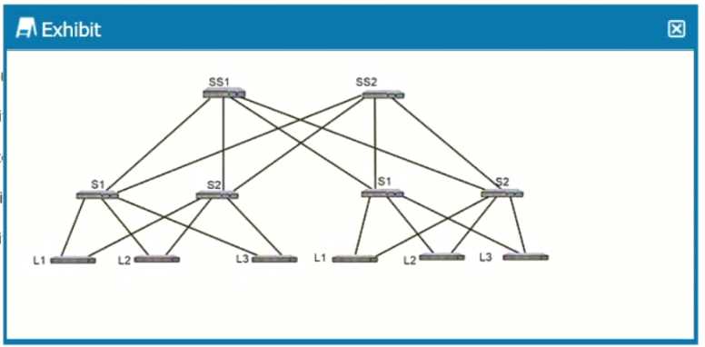

Exhibit.
  • A. The exhibit shows a 5-stage IP fabric architecture.
  • B. The exhibit shows a collapsed fabric architecture.
  • C. The exhibit does not represent a valid fabric architecture.
  • D. The exhibit shows a 3-stage IP fabric architecture.

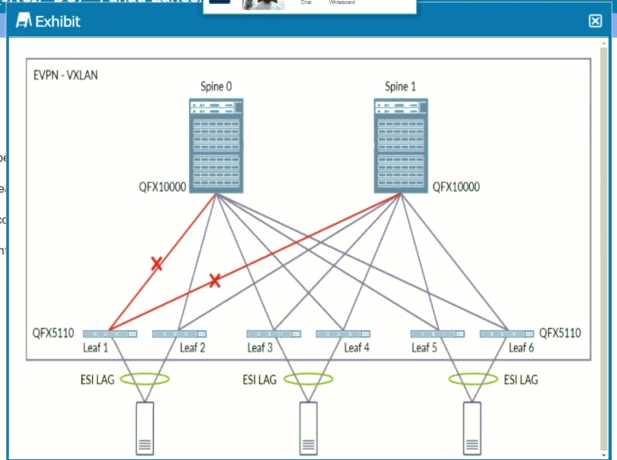

Exhibit.
Referring to the exhibit, what effect does EVPN core isolation have?
  • A. Leaf 1 will send a pause frame to each connected host.
  • B. Leaf 1 will place the interfaces to connected hosts into LACP passive mode.
  • C. Leaf 1 will take down all revenue interfaces.
  • D. Spine 1 will block all traffic.

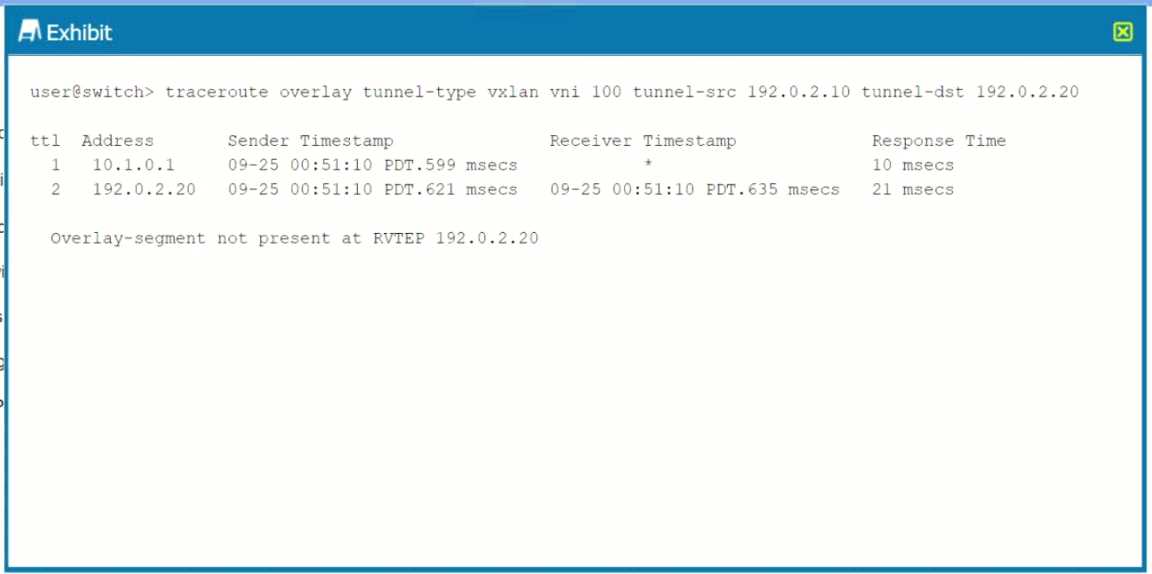

Exhibit.
You are troubleshooting a problem with traffic not reaching a remote VTEP
Referring to the exhibit, what is the reason for the problem?
  • A. A conflict exists with the VLAN-to-VNI mapping.
  • B. The local VTEP is misconfigured with the wrong VNI.
  • C. No VTEP is configured on peer 192.0.2.20.
  • D. The remote VTEP does not have the correct VNI configured.

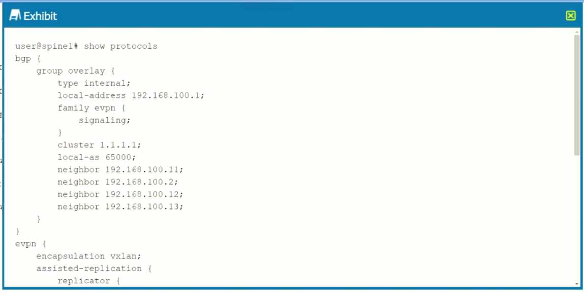

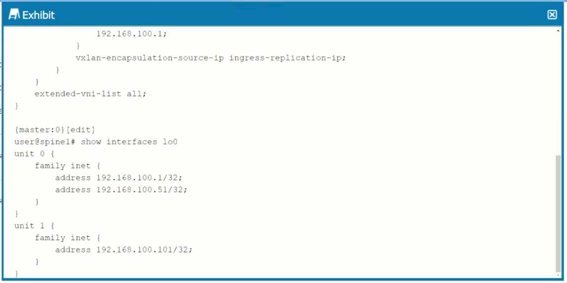

Exhibit.
The configuration shown in the exhibit is intended to set up assisted replication but will not commit.
Which action will create a valid configuration in this situation?
  • A. Change the 10.0 address to 192.168.100.1 primary.
  • B. Change the replicator inet address to 192.168.100.101.
  • C. Delete replicator inet 192.168.100.1.
  • D. Change the replicator inet address to 192.168.100. 51.

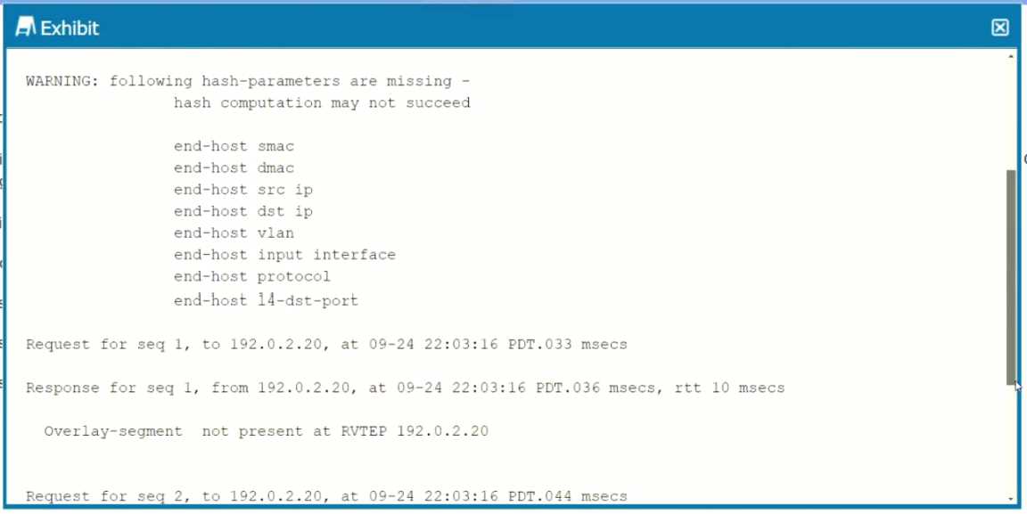

Exhibit.

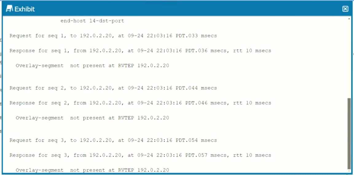

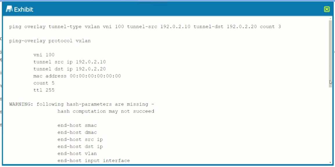

You are troubleshooting a connectivity issue across a VXLAN overlay network. In the exhibit, you are
using the ping overlay command from a local VTEP residing on a OFX 5120 to a remote VTEP residing
on a separate QFX5120.
What is the problem in this situation?
  • A. The VXLAN controller is down.
  • B. VXLAN VN1100 is not configured on the local VTEP
  • C. VXLAN VN1100 is not configured on the remote VTEP.
  • D. VXLAN VN1100 is not configured on both end points.

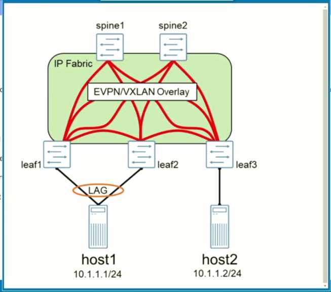

Exhibit.

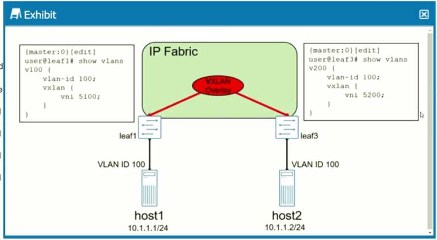

A VXLAN has been created between devices leaf1 and Ieaf3.
Referring to the exhibit, which statement is true?
  • A. Traffic sent from host1 to host2 will be dropped on Ieaf3.
  • B. Traffic sent from host1 to host2 will be tagged with VLAN ID 100 when exiting Ieaf3.
  • C. Traffic sent from host1 to host2 will be tagged with VLAN ID 200 when exiting Ieaf3.
  • D. Traffic sent from host1 to host2 will be dropped on leaf1.

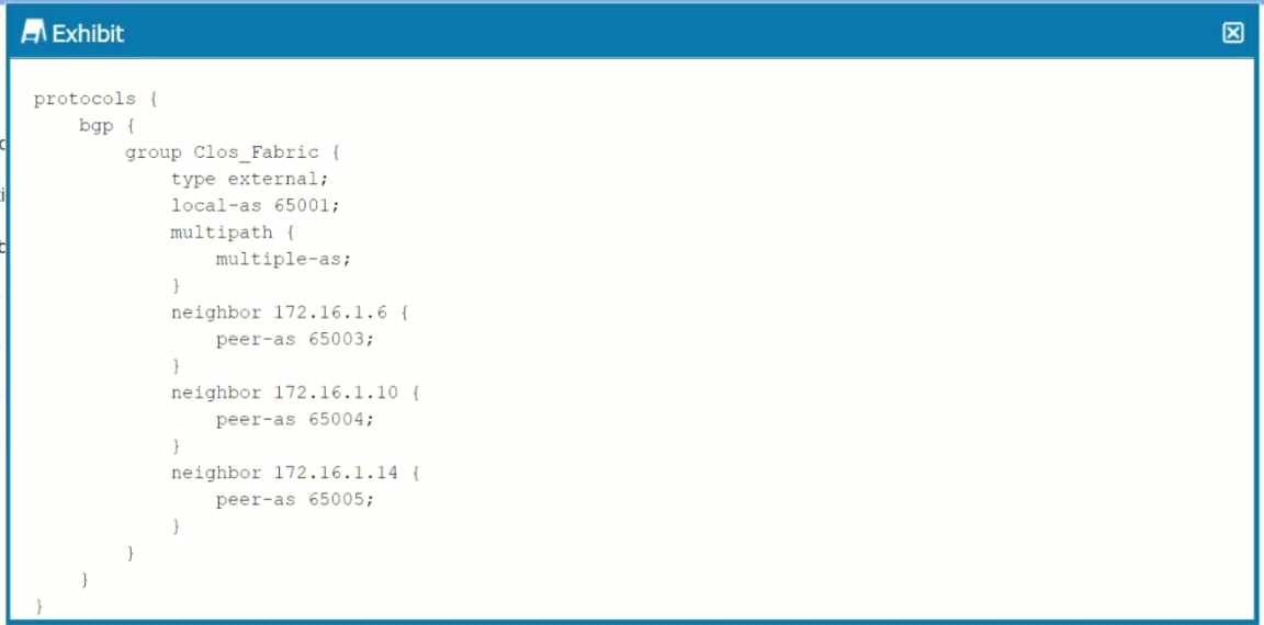

Exhibit.

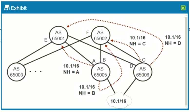

You choose the EBGP design shown in the exhibit as your IP fabric design. You must ensure that both
routes received by the spine nodes will be used for ECMP forwarding
Which BGP parameter would need to be added to the EBGP configuration of the spine nodes to
achieve this goal?
  • A. multipath
  • B. multihop
  • C. add-path
  • D. multipath multiple-as

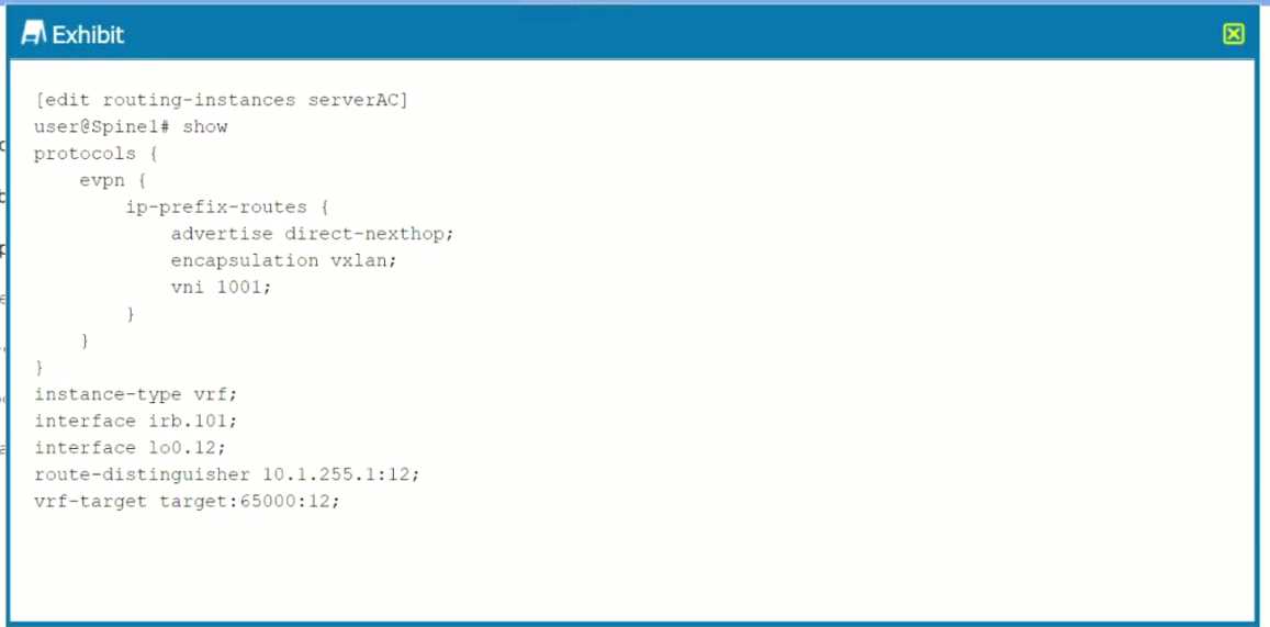

Exhibit.
Referring to the exhibit, you must advertise the Io0.12 interface as a type-5 route.
Which configuration parameter would be used to accomplish this task?
  • A. Configure auto-export under the routing instance.
  • B. Configure a vrf-export policy to advertise the interface route under the routing instance.
  • C. Configure an export policy to advertise the interface route under protocols evpn.
  • D. Configure vrf-table-label under the routing instance.
