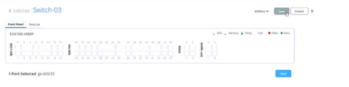

Referring to the exhibit, what is the purpose of the Save button in the upper-right corner of the Mist
dashboard?
  • A. It generates a backup of the current port configuration.
  • B. It resets the port configuration to its default settings.
  • C. It previews the impact of the port configuration changes before applying them.
  • D. It applies the port configuration changes to the switch.
In the Juniper Mist AI for Wired dashboard, administrators can select one or more switch ports (as
shown in the exhibit, e.g., port ge-0/0/25 on an EX4100-48MP). Once configuration changes are
made — such as VLAN assignment, port profiles, PoE settings, or administrative state — the Save
button must be clicked to confirm and apply those changes to the device.
“When making configuration changes in the Mist switch interface, the Save button must be used to
confirm the modifications. Clicking Save applies the selected port settings to the switch through Mist
Cloud.”
Option A is incorrect: saving does not create a backup. Backups and snapshots are handled through
Mist’s configuration archive, not via the Save button.
Option B is incorrect: Save does not reset configuration; instead, it commits changes.
Option C is incorrect: there is no preview function tied to Save.
Option D is correct: the Save button is explicitly for applying configuration changes to the selected
switch or port(s).

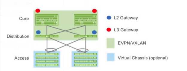

Which campus fabric architecture is shown in the exhibit?
  • A. core-distribution – edge-routed bridging (ERB)
  • B. 5-stage IP Clos
  • C. 3-stage IP Clos
  • D. core-distribution – centrally-routed bridging (CRB)
The exhibit shows:
L2 gateways (blue dots) positioned at the distribution layer.
L3 gateways (red dots) positioned at the core layer.
EVPN/VXLAN providing fabric connectivity between layers.
Access switches forwarding traffic into the fabric without acting as gateways.
This directly maps to the centrally-routed bridging (CRB) model, where:
Bridging occurs at the access/distribution layer.
Routing (L3 gateway) occurs centrally at the core layer.
“In the core-distribution CRB model, Layer 2 gateways are deployed at the distribution switches, and
Layer 3 gateways are deployed centrally at the core switches.”
Option A (ERB) is incorrect because ERB places the L3 gateway at the edge/access.
Option B (5-stage IP Clos) is incorrect — that topology has a leaf/spine architecture, not
core/distribution.
Option C (3-stage IP Clos) is incorrect — that eliminates the distribution layer.
Option D (CRB) is correct, matching the diagram exactly.
