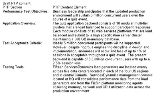

A coworker has located various test plan elements under the standard PTP sections in a draft You
have been asked to analyze the quality of the draft. The complete PTP draft cannot be provided here
A content sampling of the PTP is provided.
Based on the content sample below, what is the quality of the draft document when only considering
the alignment of content under standard PTP sections?
  • A. 0 misalignments, good
  • B. 1 misalignments, good
  • C. 2 misalignments good
  • D. 3 misalignments needs improvement
