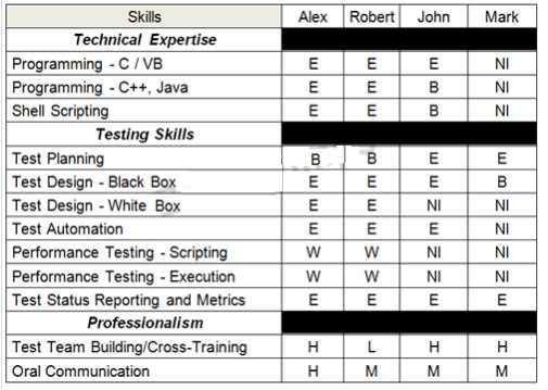

Consider the following skills assessment spreadsheet for your test team (consisting of four team
members):
This spreadsheet has three sections: technical expertise, testing skills and professionalism.
The skill levels for each skill area for both the technical expertise and testing skills sections have
been rated on a four-point scale:
- E (Expert): indicates that a person has expert knowledge and experience in the skill area
- B (Beginner): indicates that a person has some knowledge and experience in the skill area but
he/she is not autonomous
- W (Wants to learn): indicates that a person has no knowledge or experience in the skill area but
he/she wants to learn that skill
- NI (Not Interested): indicates that a person has no knowledge or experience in the skill area and
he/she is not interested to learn that skill
The skill levels for each skill area of the professionalism section have been rated on a three point
scale (H=High, M=Medium, L=Low).
You are using this skills assessment spreadsheet in order to define a training development plan for
your test team.
Your objective is to fill the skill gaps by having at least a team member rated as an expert for each
skill identified for the technical expertise and testing skills sections, and with the ability to train
the other team members.
Considering the budget constraints you can send only one person to a training course.
Based only on the given information, which of the following answers would you expect to be the best
option to achieve your objective?
K4 3 credits
  • A. Send Robert to a performance testing training course
  • B. Send Alex to a performance testing training course
  • C. Send John to a performance testing training course
  • D. Send Mark to a test automation training course

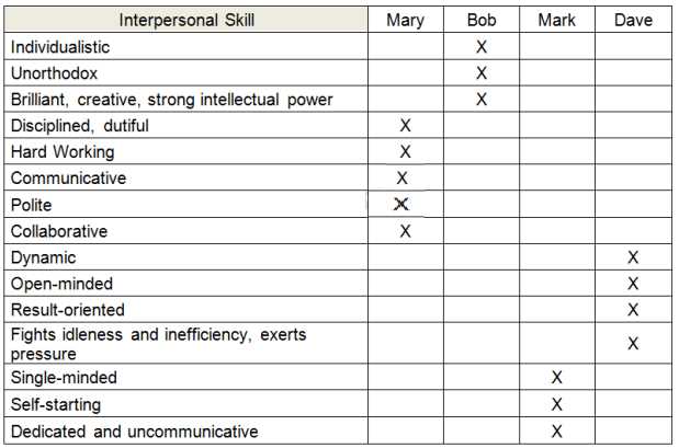

Your test team consists of four members (Mary, Bob, Mark, Dave) with different interpersonal skills.
The following skills assessment spreadsheet shows the characteristics of the team members with
respect to a list of interpersonal-skills (for each characteristic only the member with the highest level
of that characteristic is indicated and marked with X):
On the next project a member of your test team will have to perform some routine tasks requiring
collaboration with other teams. Who in your test team would you expect to be most suitable at doing
these tasks? K4 3 credits
  • A. Mary
  • B. Bob
  • C. Mark
  • D. Dave
members):

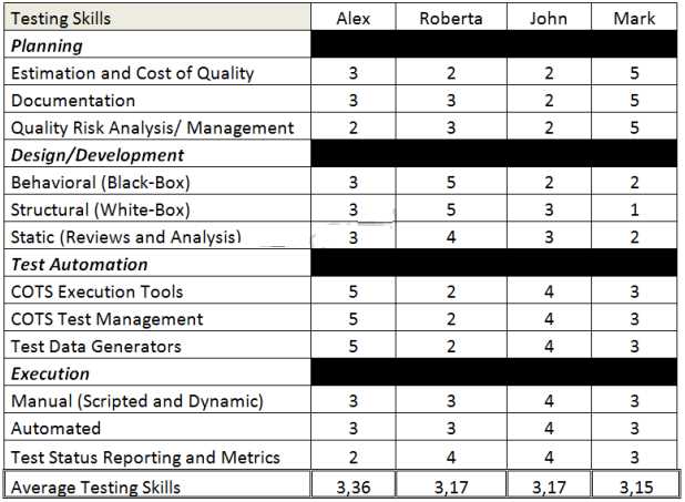

Consider the following analysis of testing skills performed on four people. Alex, Robert, John and
Mark (all the skills have been rated on an ascending scale. The higher the score, the better the skill):
Which of these people, based on this analysis, would you expect to be most suitable to work
specifically as test designer?
K4 3 credits
  • A. Alex
  • B. Roberta
  • C. John
  • D. Mark
