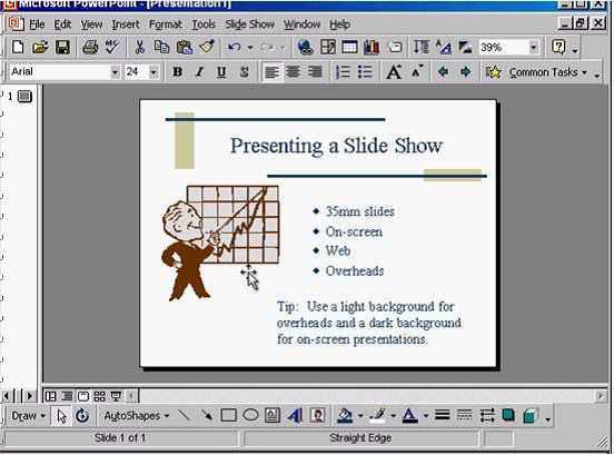

Change the output settings for this presentation to those best suited for printing 35mm slides.
  • A. File -> page setup -> in the slides sized for from the drop down list select 35 mm slides -> ok

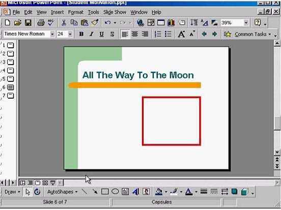

Insert a text box within the red square.
  • A. Select text box tool from the drawing toolbar -> put the cursor in the red square and draw the text box

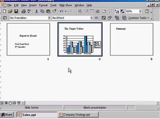

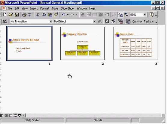

Duplicate the selected slide as slide number 2 in Company Strategy, which is also currently open.
  • A. Right click on slide 2 -> select copy -> Select Company Strategy from the taskbar -> right click after slide 1 and select paste

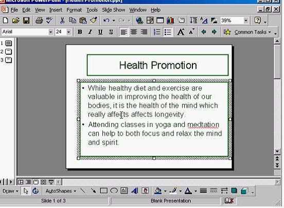

PowerPoint has detected a spelling error on this slide.
Use the spell checker to correct the spelling of just this occurrence of the word, meditation.
  • A. Right click on the word meditation

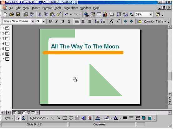

You no longer need the triangle auto-shape. Delete it now, without placing it on the Clipboard.
  • A. Select the auto shape -> press delete from the keyboard

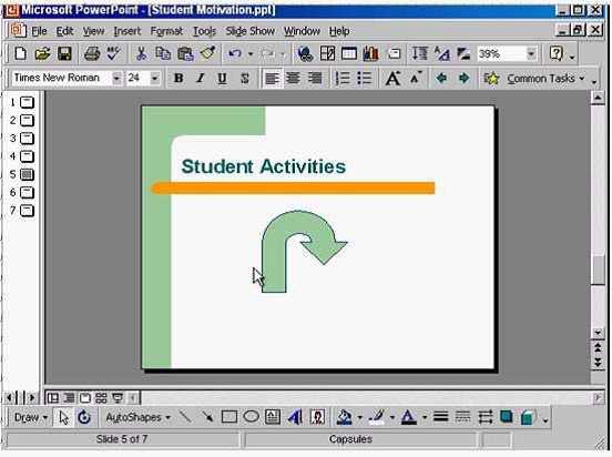

Select the auto-shape of the U-turn arrow and flip it horizontally.
  • A. Select the auto shape -> click on the draw tool from the drawing toolbar -> select flip horizontally
