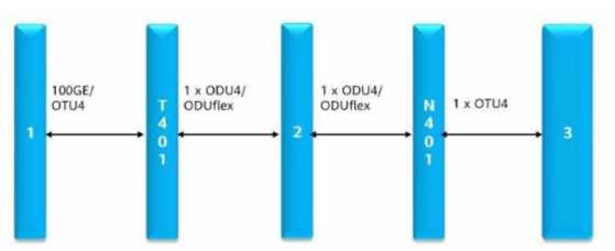

Drag the correct answer to the corresponding number in the picture.
