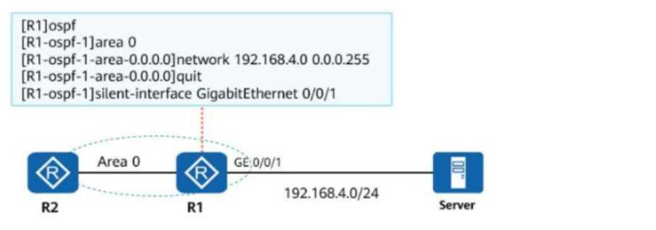

The following figure shows the OSPF network of an enterprise and the OSPF configurations of R1.
Which of the following statements is false about the network?
  • A. R2 can access the server.
  • B. GE 0/0/1 of R1 cannot send OSPF packets.
  • C. The network segment to which GE 0/0/1 of R1 belongs cannot be advertised.
  • D. GE 0/0/1 of R1 cannot accept OSPF packets.
​ Silent Interface Explanation
The silent-interface command is used to prevent OSPF from sending or receiving OSPF packets on the
specified interface (GE 0/0/1). This disables OSPF adjacency establishment and stops route
advertisement for that interface.
​ Network Observations
Statement A: R2 can access the server.
This is correct, as the silent interface does not impact data traffic, only OSPF-related communication.
Statement B: GE 0/0/1 of R1 cannot send OSPF packets.
Correct due to the silent-interface configuration.
Statement C: The network segment to which GE 0/0/1 of R1 belongs cannot be advertised.
This is correct, as the silent interface prevents route advertisement.
Statement D: GE 0/0/1 of R1 cannot accept OSPF packets.
Correct, as the silent interface configuration blocks packet reception.
