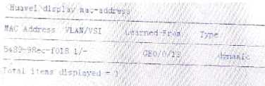

As shown in the figure, when the switch needs to forward frames with the destination mac address
of 5489-98ec-f011, which of the following descriptions is correct? () (Single-choice question)
  • A. The switch will send a message that the destination is unreachable to the source device
  • B. The switch did not find a matching entry in the mac address table. So the frame will be discarded
  • C. The switch needs to send a request to discover the device with the mac address of 5489-98ec-f011
  • D. The switch will be All ports outside flood the frame

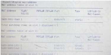

The mac address of the existing switch is shown in the figure. Which of the following statements is
correct ()? (Multiple Choice Questions)
A.When the switch restarts, the mac address learned by port Eth0/0/2 does not need to be relearned
B.The data frame with the source mac address of 5489-9885-18a8 and the destination mac address of
5489-989d-1d30 learned from the port is forwarded from the Eth0/0/1 port
C.The source mac address learned from the port is 5489-9811-0b49. The data frame with the
destination mac address 5489-989d-1d30 is forwarded from the Eth0/0/2 port
D.When the switch restarts, the mac address learned by port Eth0/0/3 needs to be re-learned

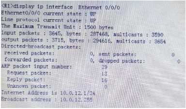

The output information of the router is shown in the figure. Which of the following statements is
wrong? () (Single-choice question)
The broadcast address corresponding to the AEthernet0/0/0 interface is 10.0.12.255
B.The physical link of the Ethernet0/0/0 interface is normal
C.Ethernet0/0/0 interfaceThe MTU value is 1480
D.Ethernet (The IP address of the /0/0 interface is 10.0.12.1/24

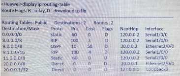

The following figure shows the routing table of a router. When the router receives a
destinationIWhen the P address is a data packet of 9.1.1.1,The router will forward according to the
route of 9.1.0.0/16 because the mask length of this route is longer. ()(True or False)
A.True
B.False

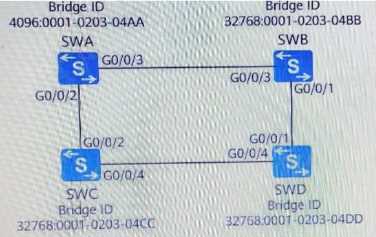

In the figure below, all switches have enabled the STP protocol, assuming that the path cost value of
all ports is 200. What is the root path cost value contained in the configuration BPDU message
received by the G0/0/4 port of $WD? () (Single-choice question)
  • A. 600
  • B. 200
  • C. 0
  • D. 400

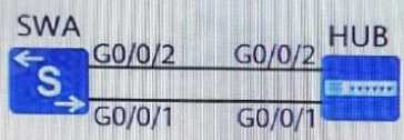

As shown in the figure, the switch runs STP with default parameters. Which of the following ports
will be elected as the designated port? () (Single-choice question)
A.Port G0/0/1 of switch A
B.HUB's G0/0/1 port
C.HUB's G0/0/2 port
D.Port G0/0/2 of switch A

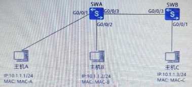

As shown in the figure below, all hosts can communicate normally. Is the correspondence between
the MAC address and the port in the MAC address table of SWB correct? () (Single-choice question)
A.MAC-A GO/0/1
MAC-B GO/0/2
MAC-C GO/0/3
B.MAC-A GO/0/2
MAC-B G0/0/2
MAC-C GO/0/3
C.MAC-A GO/0/3
MAC-B GO/0/3
MAC-C GO/0/1
D.MAC-A GO/0/1
MAC-B GO/0/1
MAC-C GO/0/3

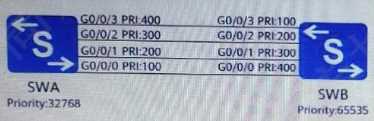

The priority of the LACP protocol is shown in the figure. Switch A and Switch B adopt LACP mode link
aggregation, and all interfaces are added to the link aggregation group. At the same time, set the
maximum number of active ports to 3. Then which port of switch A is not an active port ? () (Single-
choice question)
  • A. G0/0/0
  • B. G0/0/1
  • C. G0/0/2
  • D. G0/0/3

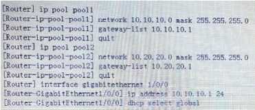

The administrator has configured the router as shown in the figure. Then a host connected to the
G1/0/0 interface of the router. What kind of IP address can be obtained through DHCP? () (Single-
choice question)
A.The IP address obtained by the host belongs to the 10.10.10.0/24 network
B.The IP address obtained by the host belongs to the 10.20.20.0/24 network
C.The IP address obtained by the host may belong to the 10.10.10.0/24 network, or it may belong to
D.The host cannot get an address
