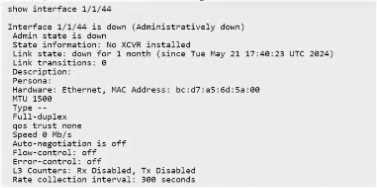

Refer to the partial exhibit from an HPE Aruba Networking CX 8325:
A new port 1/1/44 needs to be configured to connect to a 29301, which has the following
configuration:
Which configuration would be used?

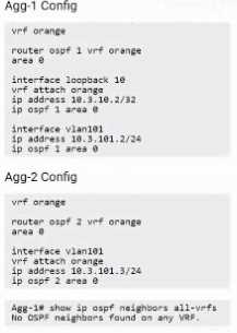

You have applied the following OSPF configuration but are seeing the output from the command
below. What is the reason for this?
  • A. A loopback interface hasn't been configured on Agg-2
  • B. OSPF interfaces are passive by default
  • C. A different OSPF process ID is used on each switch
  • D. A Layer-3 interface has not been associated with a VRF

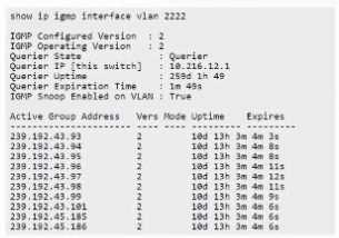

An HPE Aruba Networking CX switch is configured with IGMP using the given output:
Which statement is true about the possible supported message types?
  • A. Leave and Report
  • B. Join, Leave, Query and Report
  • C. Query and Report
  • D. Join and Query
