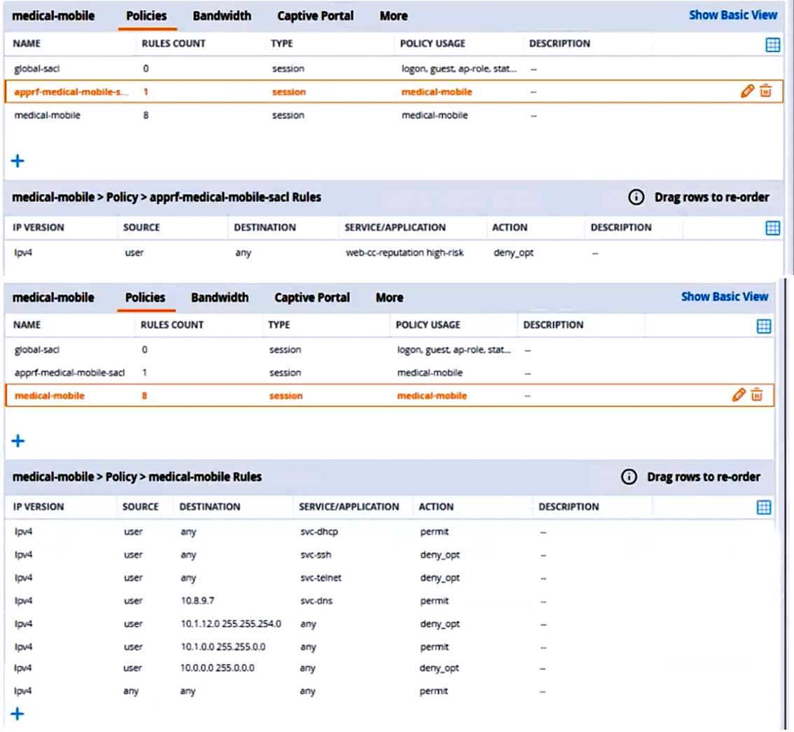

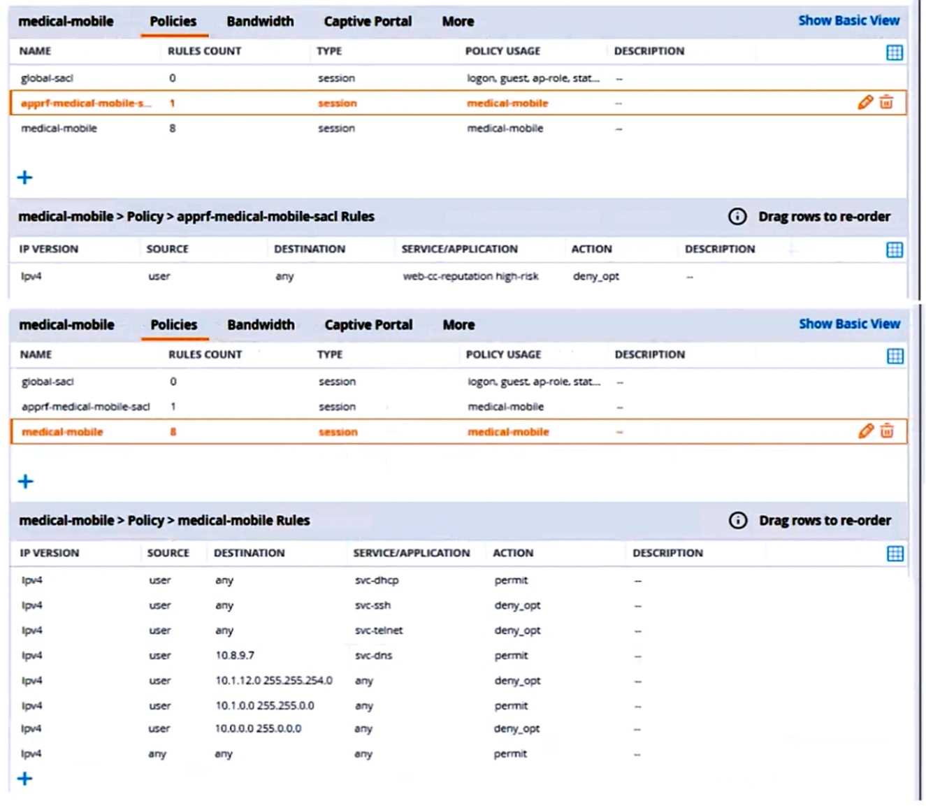

Refer to the scenario.
A customer requires these rights for clients in the “medical-mobile” AOS firewall role on Aruba
Mobility Controllers (MCs):
Permitted to receive IP addresses with DHCP
Permitted access to DNS services from 10.8.9.7 and no other server
Permitted access to all subnets in the 10.1.0.0/16 range except denied access to 10.1.12.0/22
Denied access to other 10.0.0.0/8 subnets
Permitted access to the Internet
Denied access to the WLAN for a period of time if they send any SSH traffic
Denied access to the WLAN for a period of time if they send any Telnet traffic
Denied access to all high-risk websites
External devices should not be permitted to initiate sessions with “medical-mobile” clients, only
send return traffic.
The exhibits below show the configuration for the role.
There are multiple issues with this configuration. What is one change you must make to meet the
scenario requirements? (In the options, rules in a policy are referenced from top to bottom. For
example, “medical-mobile” rule 1 is “ipv4 any any svc-dhcp permit,” and rule 8 is “ipv4 any any any
permit”.)
  • A. In the “medical-mobile” policy, move rules 2 and 3 between rules 7 and 8.
  • B. In the “medical-mobile” policy, change the subnet mask in rule 3 to 255.255.248.0.
  • C. Move the rule in the “apprf-medical-mobile-sacl” policy between rules 7 and 8 in the “medical- mobile” policy.
  • D. In the “medical-mobile” policy, change the source in rule 8 to “user.”
The subnet mask in rule 3 of the “medical-mobile” policy is currently 255.255.252.0, which means
that the rule denies access to the 10.1.12.0/22 subnet as well as the adjacent 10.1.16.0/22 subnet 1
This is not consistent with the scenario requirements, which state that only the 10.1.12.0/22 subnet
should be denied access, while the rest of the 10.1.0.0/16 range should be permitted access.
To fix this issue, the subnet mask in rule 3 should be changed to 255.255.248.0, which means that the
rule only denies access to the 10.1.8.0/21 subnet, which includes the 10.1.12.0/22 subnet 1
. This
way, the rule matches the scenario requirements more precisely.

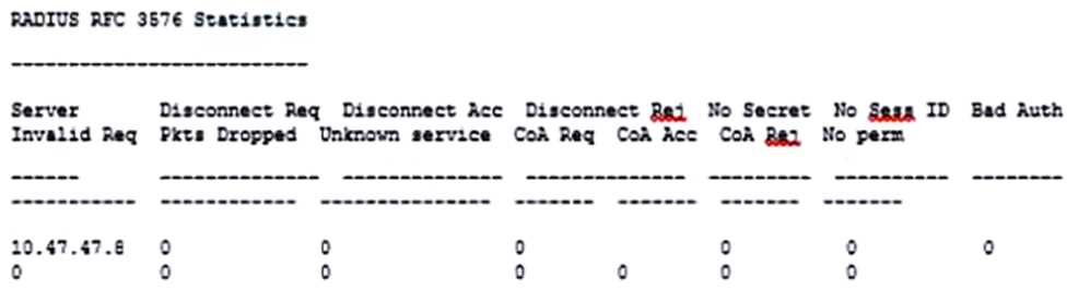

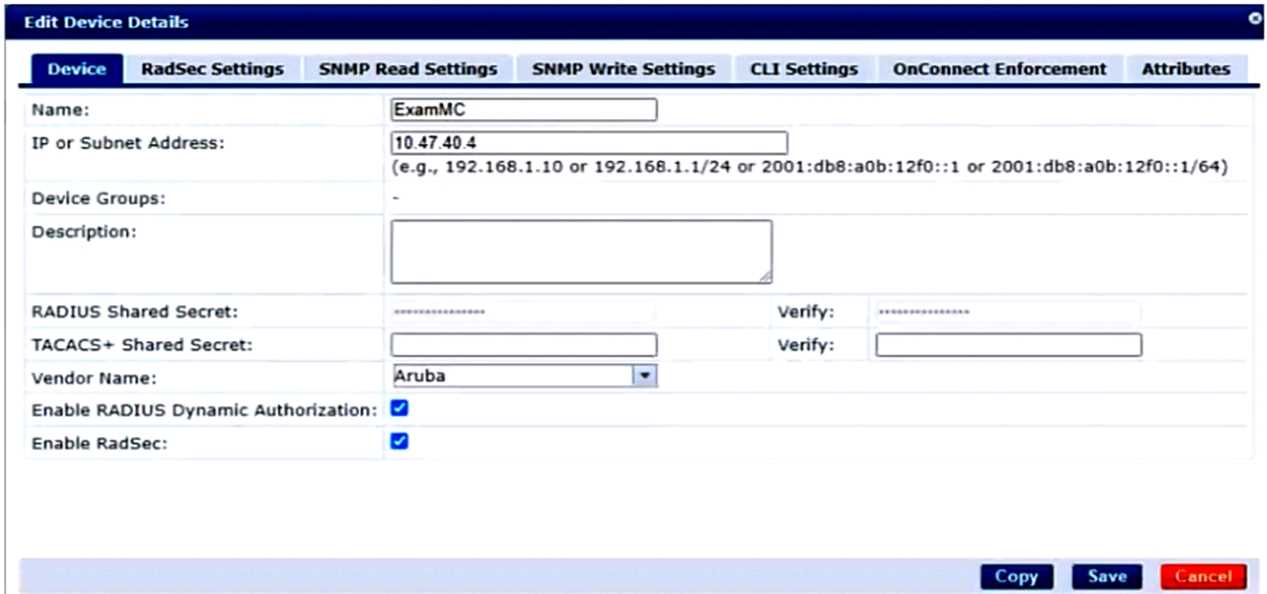

A company has an Aruba ClearPass server at 10.47.47.8, FQDN radius.acnsxtest.local. This exhibit
shows ClearPass Policy Manager's (CPPM's) settings for an Aruba Mobility Controller (MC).
The MC is already configured with RADIUS authentication settings for CPPM, and RADIUS requests
between the MC and CPPM are working. A network admin enters and commits this command to
enable dynamic authorization on the MC:
aaa rfc-3576-server 10.47.47.8
But when CPPM sends CoA requests to the MC, they are not working. This exhibit shows the RFC
3576 server statistics on the MC:
How could you fix this issue?
  • A. Change the UDP port in the MCs’ RFC 3576 server config to 3799.
  • B. Enable RadSec on the MCs’ RFC 3676 server config.
  • C. Configure the MC to obtain the time from a valid NTP server.
  • D. Make sure that CPPM is using an ArubaOS Wireless RADIUS CoA enforcement profile.
Dynamic authorization is a feature that allows CPPM to send change of authorization (CoA) or
disconnect messages to the MC to modify or terminate a user session based on certain conditions or
events 1
Dynamic authorization uses the RFC 3576 protocol, which is an extension of the RADIUS
protocol 2
To enable dynamic authorization on the MC, you need to configure the IP address and UDP port of
the CPPM server as the RFC 3576 server on the MC 3
. The default UDP port for RFC 3576 is 3799, but
it can be changed on the CPPM server .
The MC and CPPM must use the same UDP port for dynamic
authorization to work properly 3
In this scenario, the MC is configured with the IP address of the CPPM server (10.47.47.8) as the RFC
3576 server, but it is using the default UDP port of 3799. However, according to the exhibit, the
CPPM server is using a different UDP port of 1700 for dynamic authorization . This mismatch causes
the CoA requests from CPPM to fail on the MC, as shown by the statistics .
To fix this issue, you need to change the UDP port in the MCs’ RFC 3576 server config to match the
UDP port used by CPPM, which is 1700 in this case. Alternatively, you can change the UDP port in
CPPM to match the default UDP port of 3799 on the MC.
Either way, you need to ensure that both
devices use the same UDP port for dynamic authorization 3

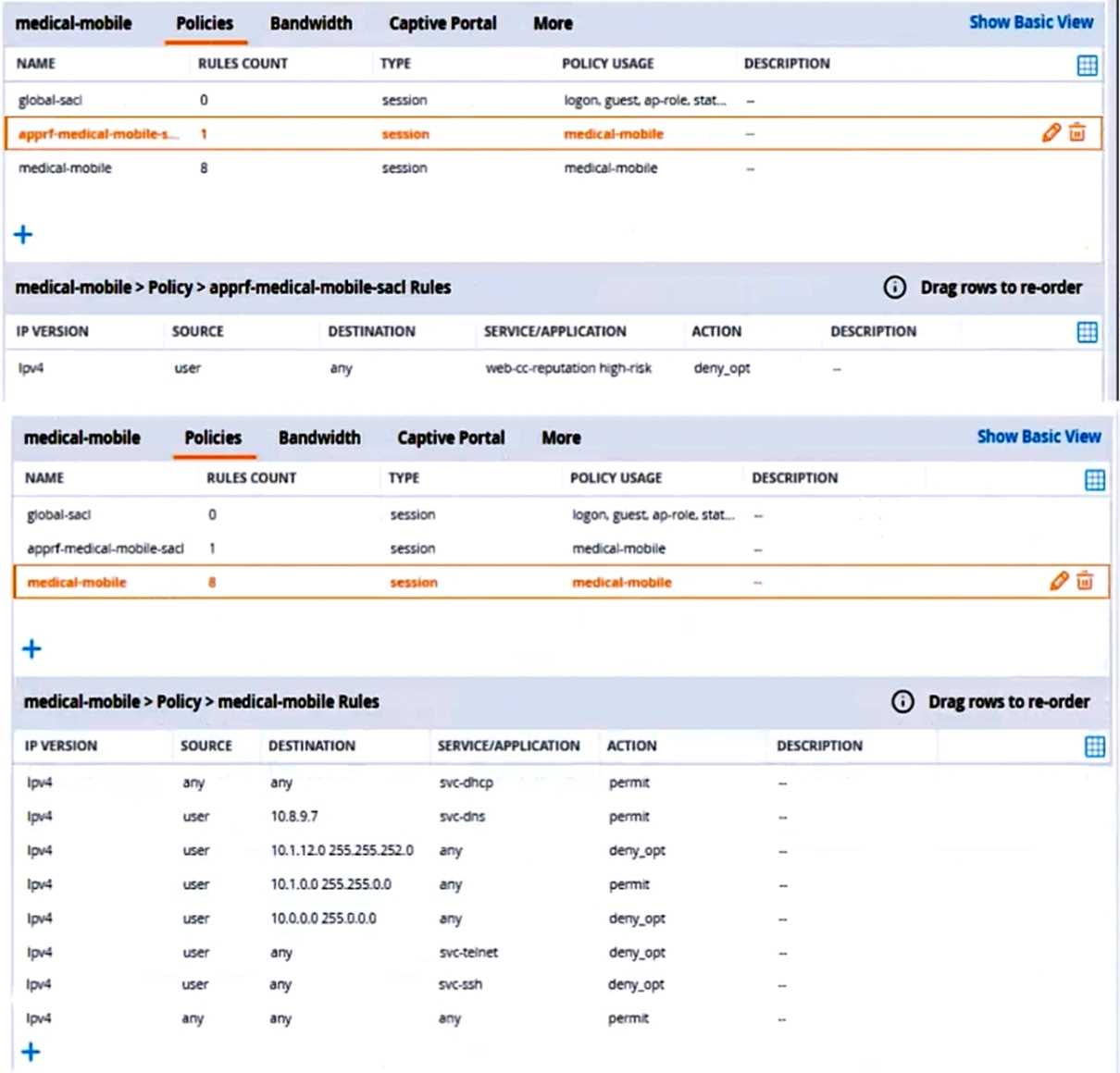

What setting not shown in the exhibit must you check to ensure that the requirements of the
scenario are met?
  • A. That denylisting is enabled globally on the MCs’ firewalls
  • B. That stateful handling of traffic is enabled globally on the MCs’ firewalls and on the medical- mobile role.
  • C. That AppRF and WebCC are enabled globally and on the medical-mobile role
  • D. That the MCs are assigned RF Protect licenses
AppRF and WebCC are features that allow the MCs to classify and control application traffic and web
content based on predefined or custom categories 12
. These features are required to meet the
scenario requirements of denying access to all high-risk websites and denying access to the WLAN
for a period of time if they send any SSH or Telnet traffic.
To enable AppRF and WebCC, you need to check the following settings:
On the global level, you need to enable AppRF and WebCC under Configuration > Services >
AppRF and Configuration > Services > WebCC, respectively 12
On the role level, you need to enable AppRF and WebCC under Configuration > Security > Access
Control > Roles > medical-mobile > AppRF and Configuration > Security > Access Control > Roles >
medical-mobile > WebCC, respectively 12
You also need to make sure that the MCs have valid licenses for AppRF and WebCC, which are
included in the ArubaOS PEFNG license 3

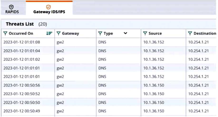

A company has Aruba gateways that are Implementing gateway IDS/IPS in IDS mode. The customer
complains that admins are receiving too frequent of repeat email notifications for the same threat.
The threat itself might be one that the admins should investigate, but the customer does not want
the email notification to repeat as often.
Which setting should you adjust in Aruba Central?
  • A. Report scheduling settings
  • B. Alert duration and threshold settings
  • C. The IDS policy setting (strict, medium, or lenient)
  • D. The allowlist settings in the IDS policy
Alert duration and threshold settings are used to control how often and under what conditions email
notifications are sent for gateway IDS/IPS events 1
. By adjusting these settings, the customer can
reduce the frequency of repeat email notifications for the same threat, while still being informed of
any critical or new threats.
To adjust the alert duration and threshold settings in Aruba Central, the customer can follow these
steps 1
In the Aruba Central app, set the filter to Global, a group, or a device.
Under Analyze, click Alerts & Events.
Click the Config icon to open the Alert Severities & Notifications page.
Select the Gateway IDS/IPS tab to view the alert categories and severities for gateway IDS/IPS
events.
Click on an alert category to expand it and view the alert duration and threshold settings for each
severity level.
Enter a value in minutes for the alert duration. This is the time period during which the alert is active
and email notifications are sent.
Enter a value for the alert threshold. This is the number of times the alert must be triggered within
the alert duration before an email notification is sent.
Click Save.
By increasing the alert duration and/or threshold values, the customer can reduce the number of
email notifications for recurring threats, as they will only be sent when the threshold is reached
within the duration. For example, if the customer sets the alert duration to 60 minutes and the alert
threshold to 10 for a Critical severity level, then an email notification will only be sent if the same
threat occurs 10 times or more within an hour.
There are multiple issues with the configuration.
What is one of the changes that you must make to the policies to meet the scenario requirements?
(In the options, rules in a policy are referenced from top to bottom. For example, “medical-mobile”
rule 1 is “ipv4 any any svc-dhcp permit,” and rule 8 is “ipv4 any any any permit’.)
  • A. In the “medical-mobile” policy, change the source in rule 1 to “user.”
  • C. In the “medical-mobile” policy, move rules 6 and 7 to the top of the list.
  • D. Move the rule in the “apprf-medical-mobile-sacl” policy between rules 7 and 8 in the “medical- mobile” policy.
Rules 6 and 7 in the “medical-mobile” policy are used to deny access to the WLAN for a period of
time if the clients send any SSH or Telnet traffic, as required by the scenario. However, these rules
are currently placed below rule 5, which permits access to the Internet for any traffic. This means
that rule 5 will override rules 6 and 7, and the clients will not be denied access to the WLAN even if
they send SSH or Telnet traffic.
To fix this issue, rules 6 and 7 should be moved to the top of the list, before rule 5. This way, rules 6
A hospital has an AOS10 architecture that is managed by Aruba Central. The customer has deployed a
pair of Aruba 9000 Series gateways with Security licenses at each clinic. The gateways implement
The Security Dashboard shows these several recent events with the same signature, as shown below:
Which step could give you valuable context about the incident?
  • A. View firewall sessions on the APs and record the threat sources' type and OS.
  • B. View the user-table on APs and record the threat sources' 802.11 settings.
  • C. View the RAPIDS Security Dashboard and see if the threat sources are listed as rogues.
  • D. Find the Central client profile for the threat sources and note their category and family.
The RAPIDS Security Dashboard is a feature of Aruba Central that provides a comprehensive view of
the network security status, including IDS/IPS events, rogue APs, and wireless intrusion detection. By
viewing the RAPIDS Security Dashboard, you can see if the threat sources are rogue APs that are
spoofing legitimate DNS servers or clients.
This can give you valuable context about the incident and
help you identify the root cause of the attack1
Aruba Central User Guide

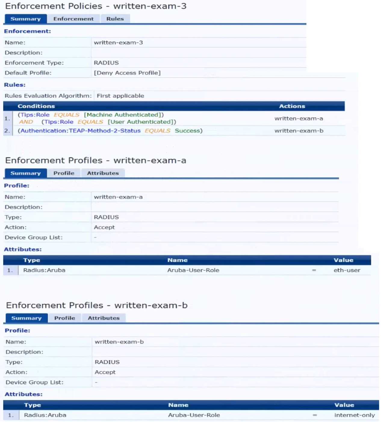

A customer has an Aruba ClearPass cluster. The customer has AOS-CX switches that implement
802.1X authentication to ClearPass Policy Manager (CPPM).
Switches are using local port-access policies.
The customer wants to start tunneling wired clients that pass user authentication only to an Aruba
gateway cluster. The gateway cluster should assign these clients to the “eth-internet" role. The
gateway should also handle assigning clients to their VLAN, which is VLAN 20.
The plan for the enforcement policy and profiles is shown below:
The gateway cluster has two gateways with these IP addresses:
• Gateway 1
o VLAN 4085 (system IP) = 10.20.4.21
o VLAN 20 (users) = 10.20.20.1
o VLAN 4094 (WAN) = 198.51.100.14
• Gateway 2
o VLAN 4085 (system IP) = 10.20.4.22
o VLAN 20 (users) = 10.20.20.2
o VLAN 4094 (WAN) = 198.51.100.12
• VRRP on VLAN 20 = 10.20.20.254
The customer requires high availability for the tunnels between the switches and the gateway cluster.
If one gateway falls, the other gateway should take over its tunnels. Also, the switch should be able
to discover the gateway cluster regardless of whether one of the gateways is in the cluster.
What is one change that you should make to the solution?
  • A. Change the ubt-client-vlan to VLAN 13.
  • B. Configure edge ports in VLAN trunk mode.
  • C. Remove VLAN assignments from role configurations on the gateways.
  • D. Configure the UBT solution to use VLAN extend mode.
The UBT solution requires that the VLAN assignments for the wired clients are done by the gateway,
not by the switch. Therefore, the role configurations on the gateways should not have any VLAN
assignments, as they would override the VLAN 20 that is specified in the enforcement profile.
Instead, the role configurations should only have policies that define the access rights for the clients
in the “eth-internet” role.
This way, the gateway can assign the clients to VLAN 20 and apply the
appropriate policies based on their role1
: Aruba Certified Network Technician (ACNT) | HPE Aruba Networking, section “Get the Edge: An
Introduction to Aruba Networking Solutions”
• Gateway 1
• Gateway 2
Assume that you are using the “myzone” name for the UBT zone.
Which is a valid minimal configuration for the AOS-CX port-access roles?
  • A. port-access role eth-internet gateway-zone zone myzone gateway-role eth-user
  • B. port-access role internet-only gateway-zone zone myzone gateway-role eth-internet
  • C. port-access role eth-internet gateway-zone zone myzone gateway-role eth-internet vlan access 20
  • D. port-access role internet-only gateway-zone zone myzone gateway-role eth-internet vlan access
The UBT solution requires that the edge ports on the switches are configured in VLAN trunk mode,
not access mode. This is because the UBT solution uses a special VLAN (VLAN 4095 by default) to
encapsulate the user traffic and tunnel it to the gateway. The edge ports need to allow this VLAN as
well as any other VLANs that are used for management or control traffic.
Therefore, the edge ports
should be configured as VLAN trunk ports and allow the necessary VLANs1
The line below shows the effective configuration for the role.
example, “medical-mobile” rule 1 is “ipv4 any any svc-dhcp permit,” and rule 6 is “ipv4 any any any
permit’.)
  • A. Apply the "apprf-medical-mobile-sjcT policy explicitly to the 'medical-mobile' user-role under the 'medical-mobile" policy.
  • B. In the "medical-mobile" policy, change the action for rules 2 and 3 to reject.
  • C. In the "medical-mobile" policy, move rule 5 under rule 6.
  • D. In the "medical-mobile* policy, change the subnet mask in rule 5 to 255.255.252.0.
The scenario requires that the clients in the “medical-mobile” role are denied access to the
10.1.12.0/22 subnet, which is a range of IP addresses from 10.1.12.0 to 10.1.15.255. However, the
current configuration in rule 5 has a subnet mask of 255.255.240.0, which means that it matches any
IP address from 10.1.0.0 to 10.1.15.255. This is too broad and would deny access to other subnets in
the 10.1.0.0/16 range that should be permitted according to the scenario.
Therefore, the subnet
mask in rule 5 should be changed to 255.255.252.0, which would match only the IP addresses from
10.1.12.0 to 10.1.15.255 and deny access to them as required by the scenario.1
: Configuring Firewall Policies - Aruba, section “Firewall Policies”
