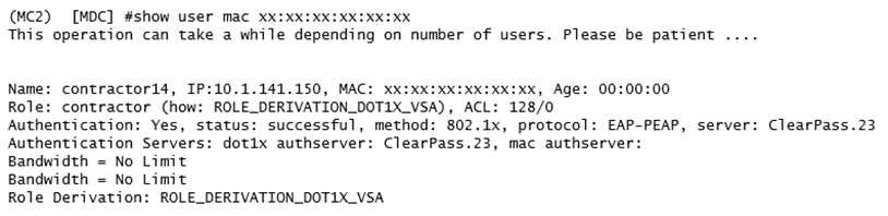

Refer to the exhibits.
Exhibit 1
Exhibit 2
Exhibit 3

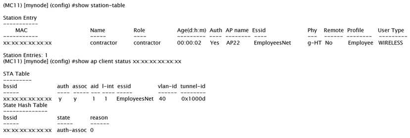

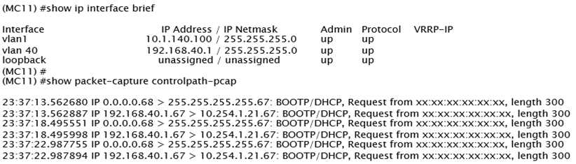

A network administrator wants to allow contractors to access the corporate WLAN named
EmployeesNet with the contractor role in VLAN 40. When users connect, they do not seem to get an
IP address. After some verification checks, the network administrator confirms the DHCP server
(10.254.1.21) is reachable from the Mobility Controller (MC) and obtains the outputs shown in the
exhibits.
What should the network administrator do next to troubleshoot this problem?
  • A. Permit UDP67 to the contractor role.
  • B. Remove the IP address in VLAN 40.
  • C. Configure the DHCP helper address.
  • D. Confirm there is an IP pool for VLAN 40.

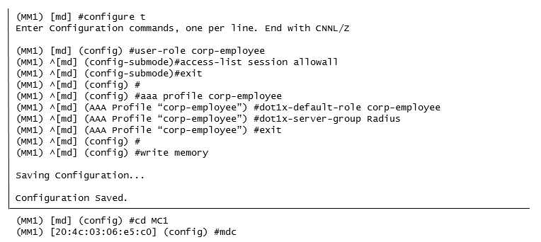

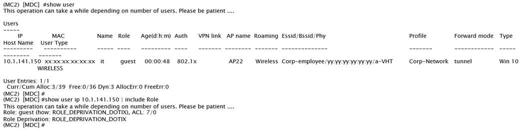

Exhibit 1
Exhibit 2

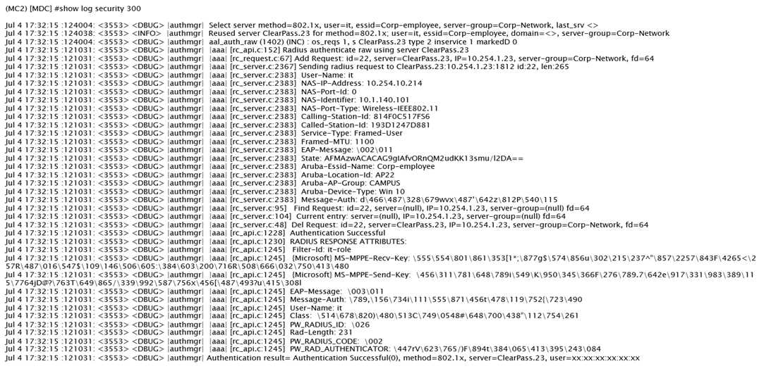

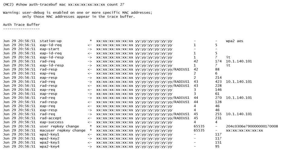

A network administrator integrates a current Mobility Master (MM) - Mobility Controller (MC)
deployment with a RADIUS server to authenticate a wireless user, the network administrator realizes
that the client machine is not failing into the it_department role, as shown the exhibits.
Which configuration is required to map the users into the proper role, based on standard attributes
returned by the RADIUS server in the Access Accept message?
  • A. aaa server-group Corp-Network set role condition Filter-Id equals it-role set-value it_department
  • B. aaa server-group Corp-employee set role condition Filter-Id value-of
  • C. aaa server-group Corp-employee set role condition Filter-Id equals it-role set-value it_department
  • D. aaa server-group ClearPass set role condition Filter-Id equals it_department set-value it-role
  • E. aaa server-group Corp-Network set role condition Filter-Id equals it_department set-value it-role

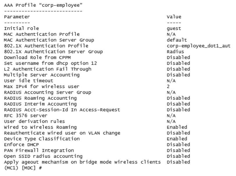

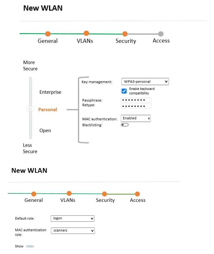

Refer to the exhibit:
A company acquires ten barcode scanners to run inventory tasks. These WiFi devices support WPA2-
PSK security only. The network administrator deploys a WLAN named scanners using the
configuration shown in the exhibit.
What must the network administrator do next to ensure that the scanner devices successfully
connect to their SSID?
  • A. Set internal as the MAC authentication server group.
  • B. Add scanner MAC addresses in user derivation rules.
  • C. Enable L2 Authentication Fail Through.
  • D. Add scanner MAC addresses in the internal database.

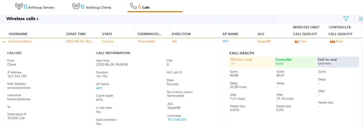

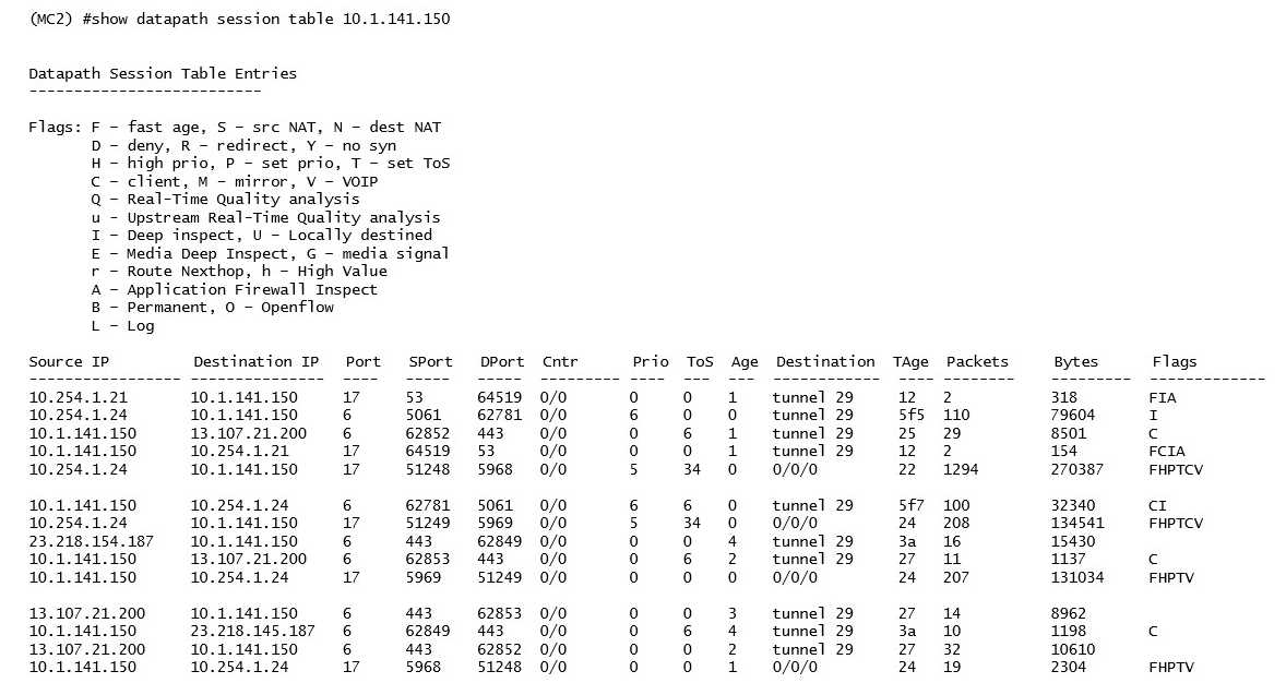

A network administrator deploys DSCP based prioritization in the entire wired network to improve
voice quality for a SIP-based IP telephony system used by the company. However, users report that
calls they make from WLAN have poor audio quality, while desktop phones do not experience the
same problem. The network administrator makes a test call and looks in the datapath session table.
Based on the output shown in the exhibit, what is one area that the network administrator should
focus on?
  • A. UCC based DSCP correction
  • B. WMM support on the WLAN
  • C. Dynamic Multicast Rate Optimization
  • D. wired network congestion

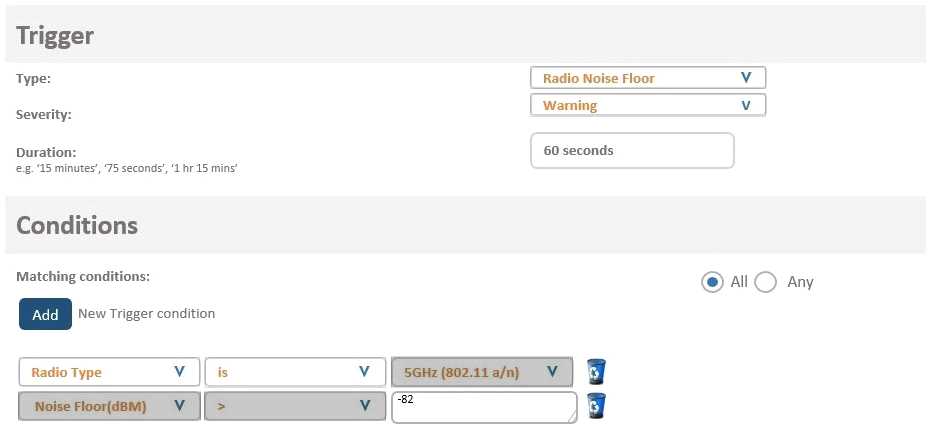

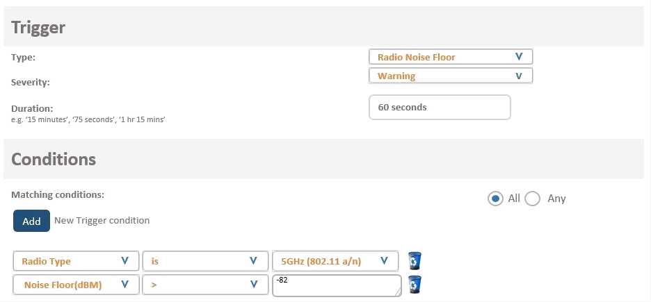

A network administrator wants to receive a warning level alarm every time the noise floor rises
above -82 dBm on any of the AP radios.
Which alarm definition must the network administrator create to accomplish this?

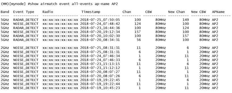

A network administrator deploys a Mobility Master (MM) - Mobility Controller (MC) network with
Aps in different locations. Users in one of the locations report that the WiFi network works fine for
several hours, and then they are suddenly disconnected. This symptom may happen at any time, up
to three times every day, and lasts no more than two minutes.
After some research, the network administrator logs into the MM and reviews the output shown in
the exhibit.
Based on this information, what is the most likely reason users get disconnected?
  • A. Adaptive Radio Management is reacting to RF events.
  • B. AirMatch is applying a scheduled optimization solution.
  • C. Users in the 2.4 GHz band are being affected by high interference.
  • D. AirMatch is reacting to non-scheduled RF events.

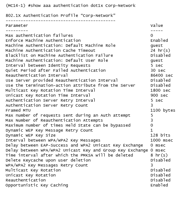

Based on the output shown in the exhibit, which wireless connection phase has just completed?
  • A. L3 authentication and encryption
  • B. MAC Authentication and 4-way handshake
  • C. 802.11 enhanced open association
  • D. L2 authentication and encryption

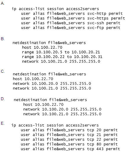

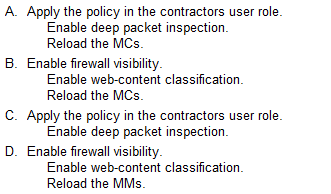

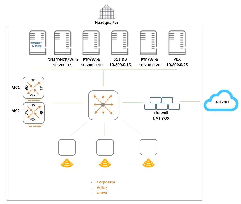

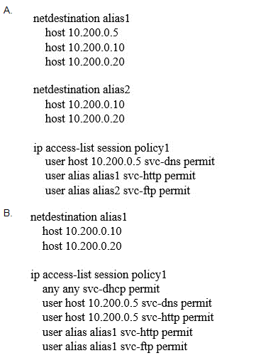

An organization provides WiFi access through a corporate SSID with an Aruba Mobility Master (MM) -
Mobility Controller (MC) network that includes PEF functions. The organization wants to have a
single firewall policy configured and applied to the employee role.
This policy must allow users to reach Web, FTP, and DNS services, as shown in the exhibit. Other
services should be exclusive to other roles. The client NICs should receive IP settings dynamically.
Which policy design meets the organization’s requirements while minimizing the number of policy
rules?

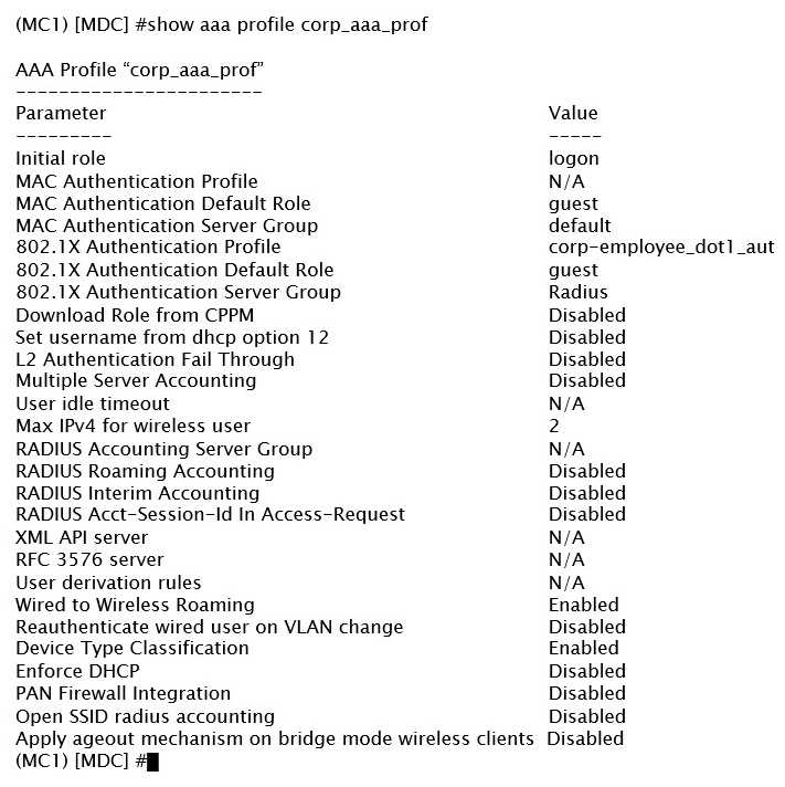

A network administrator has created AAA profile for the corporate VAP. In addition to the regular
Radius based authentication, the administrator needs to be able to disconnect the users from either
of the two servers that are part of the “Radius” server group.
What must the administrator do next in order to achieve this goal?
  • A. Use the "Radius" server group as the RADIUS Accounting Server Group in the AAA profile.
  • B. Create two new RFC 3576 servers and assign them as the RFC 3576 servers in the AAA profile.
  • C. Use the "Radius' server group as both the Accounting Server Group and the RFC 3576 server in the AAA profile.
  • D. Use the "Radius' server group as the RFC 3576 server in the AAA profile.
