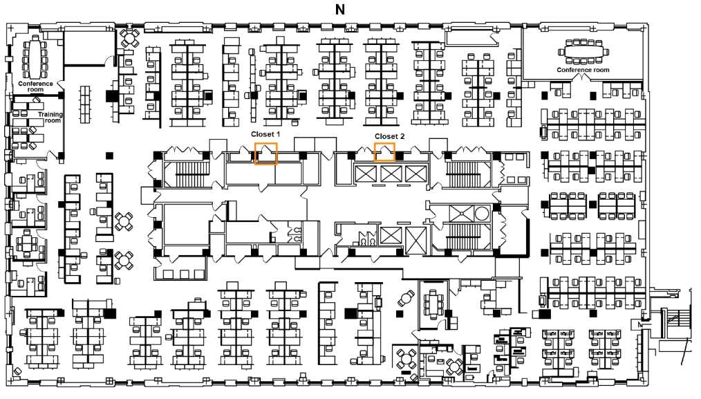

NewStellar has a main corporate campus in a business park with two adjacent buildings. Each
building has three floors and each floor is 322 x 175 feet (98 x 53 meters) for 56,350 square feet
(5,235 square meters) total. The ceiling for each floor is 12 feet (3.6 meters) high with a drop-down
ceiling at 10 feet (3 meters). The network architect has given you one floor to analyze, Building 1
Floor 2, shown in the attached exhibit.
This floor has a central main corridor with washrooms, stairs, elevators and supply and network
cabinets. There are cubicles around the perimeter of the floor. The central part main corridor's
dimensions contain 9,350 square feet (870 square meters). Assuming that wireless coverage is not
required in the central area, which square footage (square meter) value should a network architect
use when determining the number of APs in a capacity design for each floor?
  • A. 55.750 square feet {5,175 square meters)
  • B. 56.350 square feet {5,235 square meters)
  • C. 47.000 square feet {4,365 square meters)
  • D. 338,100 feet {31,410 square meters)

A network architect is given the task to design a new network solution for NewStellar Company, Inc.
NewSteiiar has a main corporate campus in a business park with two adjacent buildings. The
network architect has given one floor to analyze, Building 1 Floor 2, shown in the attached exhibit.
Each building has three floors and each floor is 322 x 175 feet (98 x 53 meters) for 56,350 square feet
(5,235 square meters) total, which results in a total of 338,100 feet (31,410 square meters) for the
entire building space. Each floor has a central main corridor with washrooms, stairs, elevators and
supply and network cabinets. There are cubicles around the perimeter of the floor. The central part
main corridor's dimensions contain 9,350 square feet {870 square meters).
Because of security concerns, video cameras will be installed throughout the facility. There are 16 of
these per floor, 8 per wiring closet. The cameras are non-WiFi capable and require POE 802.3af-
capable switch ports from which to draw power.
A wireless capacity design is required. Assuming that wireless coverage is required across the
Building 1, Floor 2, including the central area, and that half the required APs will connect to each
wiring closet, approximately how many POE+ ports will be required per wiring closet for all devices
that have POE or POE+ needs?
  • A. 30
  • B. 22
  • C. 42
  • D. 8
