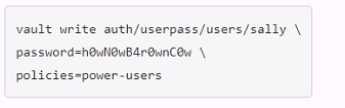

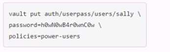

You are using the Vault userpass auth method mounted at auth/userpass. How do you create a new
user named "sally" with password "h0wN0wB4r0wnC0w"? This new user will need the power-users
policy.
To create a new user named “sally” with password “h0wN0wB4r0wnC0w” and the power-users
policy, you would use the Vault userpass auth method mounted at auth/userpass. You would use the
following command: “vault write auth/userpass/users/sally password=h0wN0wB4r0wnC0w
policies=power-users”. This command would create a new user named “sally” with the specified
password and policy. Reference:
[Userpass Auth Method | Vault | HashiCorp Developer]
[Create Vault policies | Vault | HashiCorp Developer]

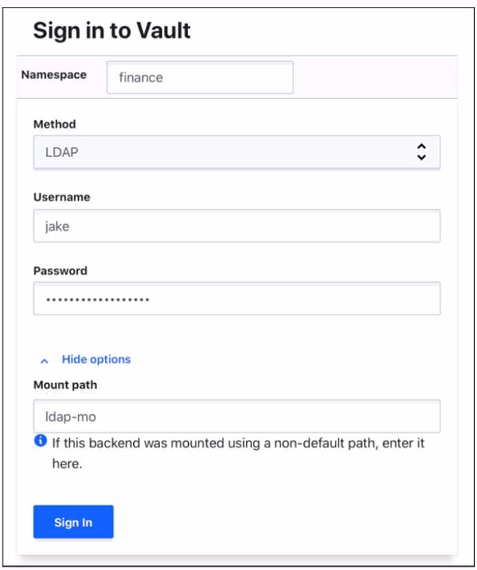

Where do you define the Namespace to log into using the Vault Ul?
To answer this question
Use your mouse to click on the screenshot in the location described above. An arrow indicator will
mark where you have clicked. Click the "Answer" button once you have positioned the arrow to
answer the question. You may need to scroll down to see the entire screenshot.
The namespace can be defined in the “Mount path” field in the “Advanced options” section of the
login screen. The mount path is the path where the auth method is enabled, and it can include a
namespace prefix. For example, if the LDAP auth method is enabled at the path ns1/auth/ldap,
where ns1 is the namespace, then the mount path field should be set to ns1/auth/ldap. This way, the
Vault UI will log in to the correct namespace and auth method. Alternatively, the namespace can also
be specified in the URL of the Vault UI, such as
https://vault.example.com/ui/vault/auth/ns1/auth/ldap/login.

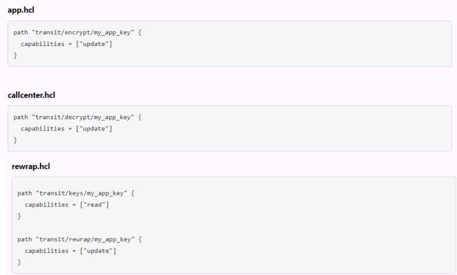

The following three policies exist in Vault. What do these policies allow an organization to do?
  • A. Separates permissions allowed on actions associated with the transit secret engine
  • B. Nothing, as the minimum permissions to perform useful tasks are not present
  • C. Encrypt, decrypt, and rewrap data using the transit engine all in one policy
  • D. Create a transit encryption key for encrypting, decrypting, and rewrapping encrypted data
The three policies that exist in Vault are:
admins: This policy grants full access to all secrets and operations in Vault. It can be used by
administrators or operators who need to manage all aspects of Vault.
default: This policy grants access to all secrets and operations in Vault except for those that require
specific policies. It can be used as a fallback policy when no other policy matches.
transit: This policy grants access only to the transit secrets engine, which handles cryptographic
functions on data in-transit. It can be used by applications or services that need to encrypt or decrypt
data using Vault.
These policies allow an organization to perform useful tasks such as:
Encrypting, decrypting, and rewrapping data using the transit engine all in one policy: This policy
grants access to both the transit secrets engine and the default policy, which allows performing any
operation on any secret in Vault.
Creating a transit encryption key for encrypting, decrypting, and rewrapping encrypted data: This
policy grants access only to the transit secrets engine and its associated keys, which are used for
encrypting and decrypting data in transit using AES-GCM with a 256-bit AES key or other supported
key types.
Separating permissions allowed on actions associated with the transit secret engine: This policy
grants access only to specific actions related to the transit secrets engine, such as creating keys or
wrapping requests. It does not grant access to other operations or secrets in Vault.
