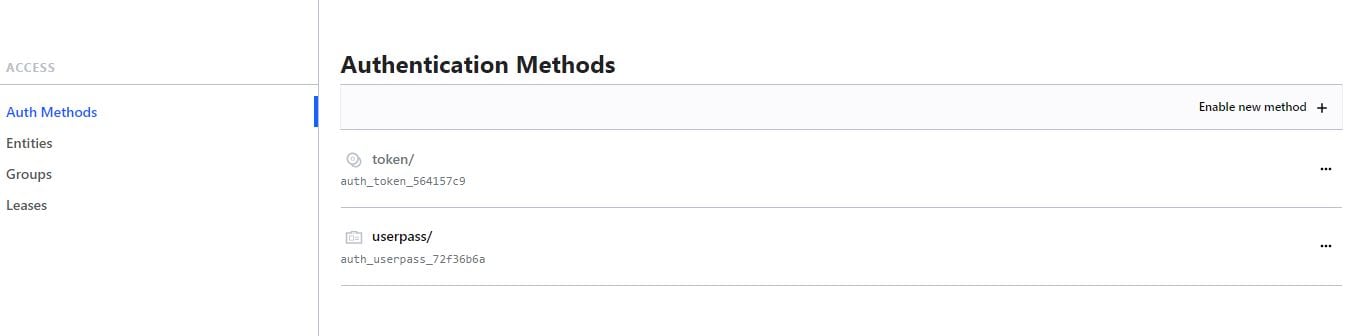

Based on the screenshot below, how many auth methods have been enabled on this Vault instance?
  • A. 1
  • B. 2
  • C. 4
  • D. 3
Comprehensive and Detailed in Depth
Token is enabled by default and cannot be disabled.
Userpass is explicitly enabled.
Total: 2 auth methods.
Overall Explanation from Vault Docs:
“Tokens are the default auth method… Additional methods like userpass increase the count.”
https://developer.hashicorp.com/vault/docs/concepts/tokens
