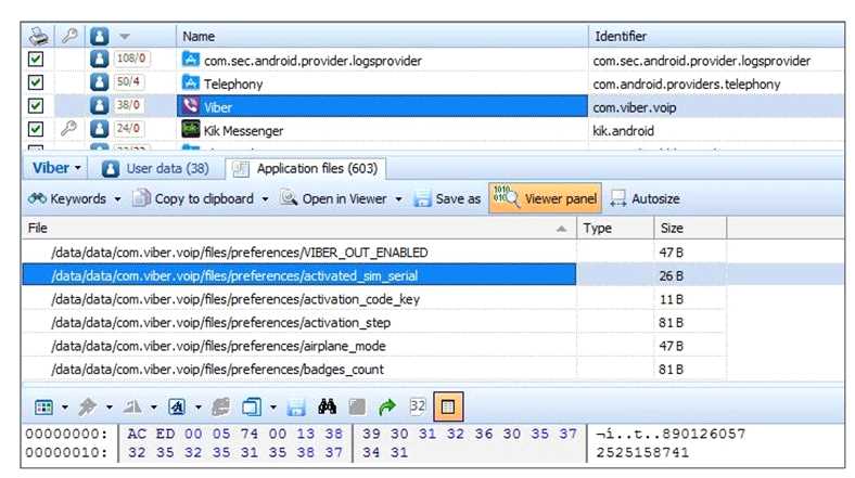

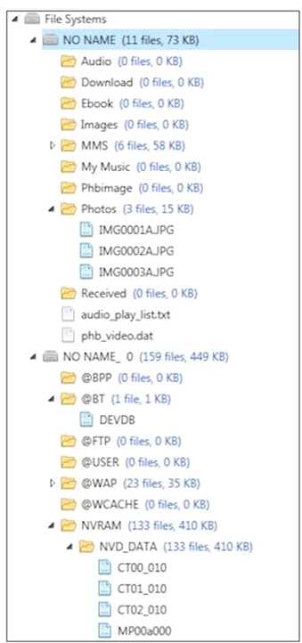

Based on the image below, which file system is being examined?
A. Chinese knock-off
B. Windows
C. Android
D. Blackberry
Explanation
https://forums.techguy.org/threads/virus-in-china-mobile.992051/

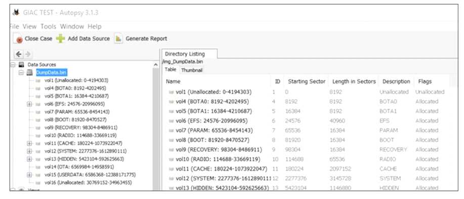

What type of acquisition is being examined in the image below?
A. iOS bypass lock
B. Blackberry logical
C. Android physical
D. Windows Mobile file system
Explanation
http://www.forensicswiki.org/wiki/How_To_Decrypt_Android_Full_Disk_Encryption

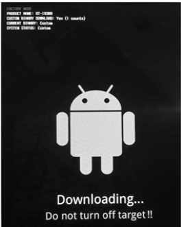

The device pictured below is in Download Mode to attempt a physical acquisition.
What can be ascertained by viewing the Android boot screen below?
A. The Android is not rooted
B. No ROM changes have ever occurred on this device
C. The Original/Factory ROM is booting
D. The Original ROM was at one time modified
Explanation
https://www.digitalforensics.com/blog/physical-acquisition-of-a-locked-android-device/

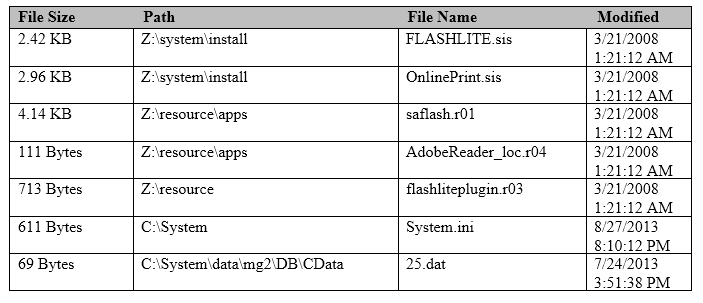

An analyst investigating a Nokia S60 Symbian device wants to know if an Adobe Flash file on the
handset is compromised.
Which file in the image will best target the Adobe Flash files?
A. FLASHLITE.sis
B. flashliteplugin.r03
C. saflash.r01
D. OnlinePrint.sis
Explanation
Explanation: A sis.file is the package that Symbian uses to install applications on their OS compatible
handsets. Knowing that you are investigating an application that is installed on the handset, first
narrowing the files down to installer packages, or *.sis files, is a good starting point. Flash is an
Adobe product making the most logical of the two remaining* .sis files for review, the FLASHLITE
installer package. There are several other files related to “Flash” but as resource files, they provide
supporting documentation and will not contain the .app file or code that was possibly malicious.

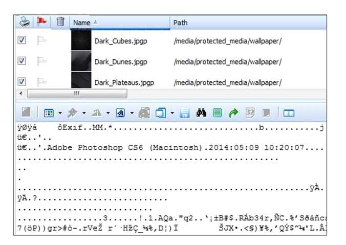

The files pictured below from a BlackBerry OS10 file system have a unique file extension.
What can be concluded about these files?
A. Files are protected by the file system, so changing the file system makes them less accessible
B. Files are encrypted to prevent them from being viewed without the decryption key
C. Files are encoded for secure transmitting of data
D. Files are located on a media card so they contain a unique file extension
Explanation
https://forums.crackberry.com/blackberry-q10-f272/protected-media-911023/
