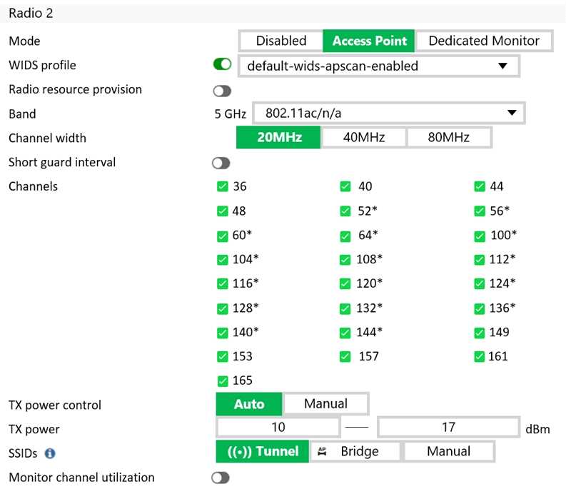

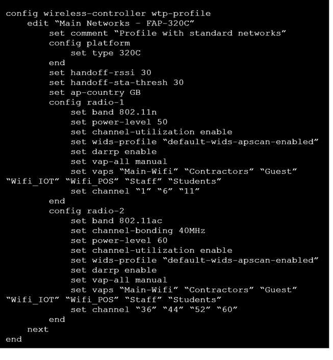

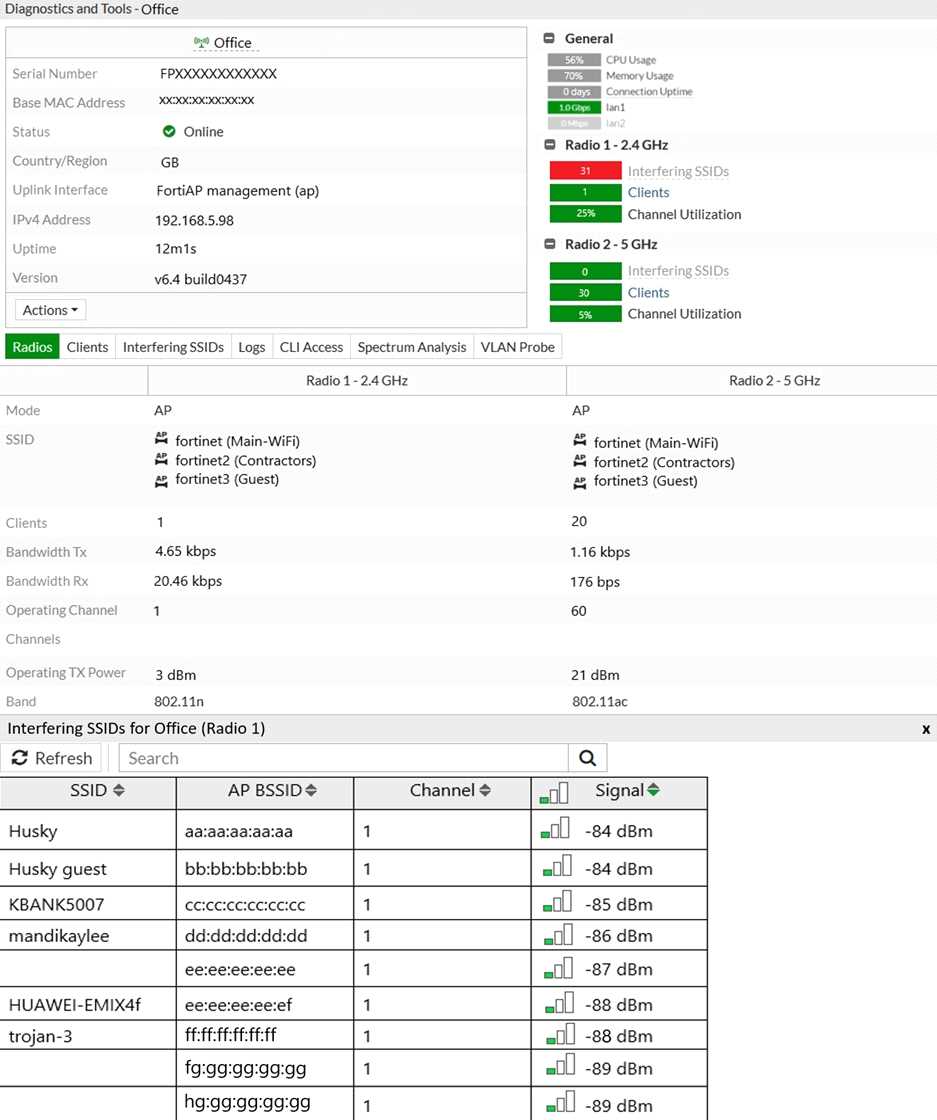

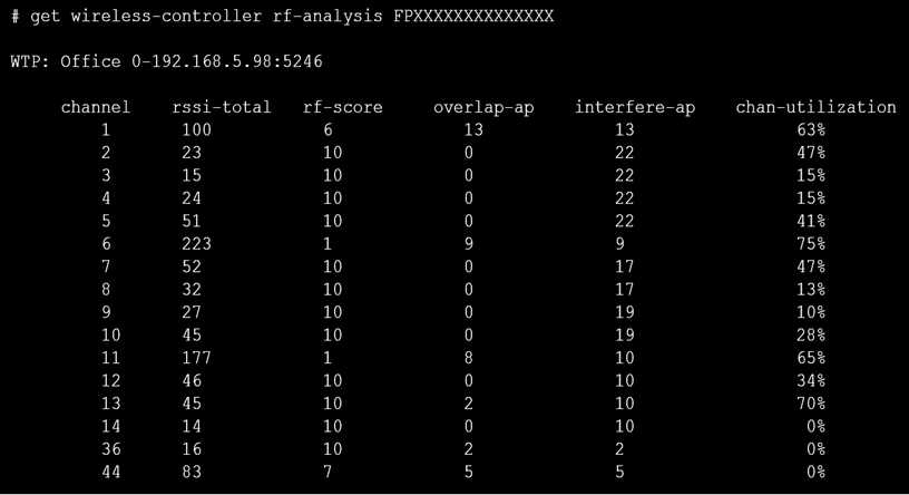

Refer to the exhibits.
Exhibit A
Exhibit B
Exhibit C
A wireless network has been installed in a small office building and is being used by a business to
connect its wireless clients. The network is used for multiple purposes, including corporate access,
guest access, and connecting point-of-sale and Io devices.
Users connecting to the guest network located in the reception area are reporting slow performance.
The network administrator is reviewing the information shown in the exhibits as part of the ongoing
investigation of the problem. They show the profile used for the AP and the controller RF analysis
output together with a screenshot of the GUI showing a summary of the AP and its neighboring APs.
To improve performance for the users connecting to the guest network in this area, which
configuration change is most likely to improve performance?
  • A. Increase the transmission power of the AP radios
  • B. Enable frequency handoff on the AP to band steer clients
  • C. Reduce the number of wireless networks being broadcast by the AP
  • D. Install another AP in the reception area to improve available bandwidth
B 3 votes
dilou59
11 months ago
Answer IS B
dilou59
11 months ago
Answer is B
