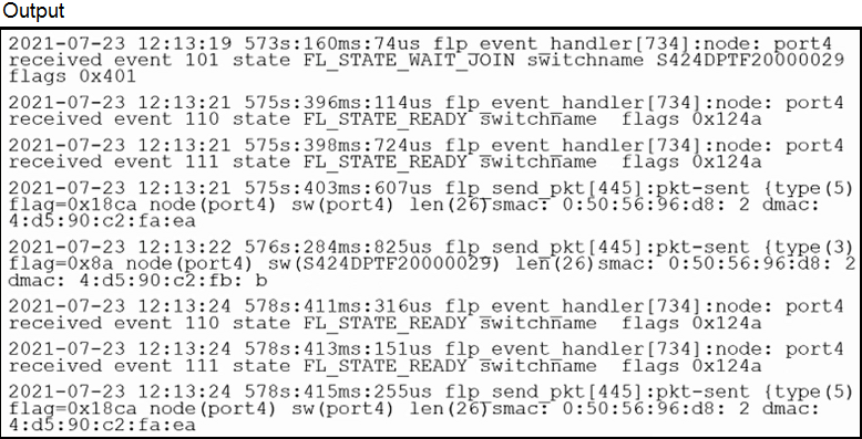

Refer to the configuration:
Which two conditions does FortiSwitch need to meet successfully configure the options shown in the exhibit above? (Choose two.)
  • A. The FortiSwitch model is equipped with a maximum of 54 interfaces.
  • B. FortiSwitch would need to be rebooted.
  • C. The split port can be assigned to a native VLAN.
  • D. The port full speed prior to the split was 100G QSFP+.
bd

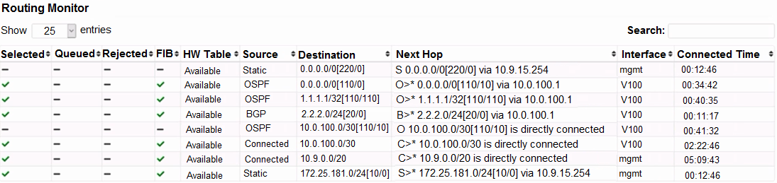

Two routes are not installed in the forwarding information base (FIB) as shown in the exhibit.
Which two statements about these two route entries are true? (Choose two.)
  • A. These two routes have a higher administrative distance value available to the destination networks.
  • B. These two routes will be used as load-balancing routes.
  • C. These two routes will become primary, if the best routes are removed.
  • D. These two routes are available in the hardware routing table.
ac

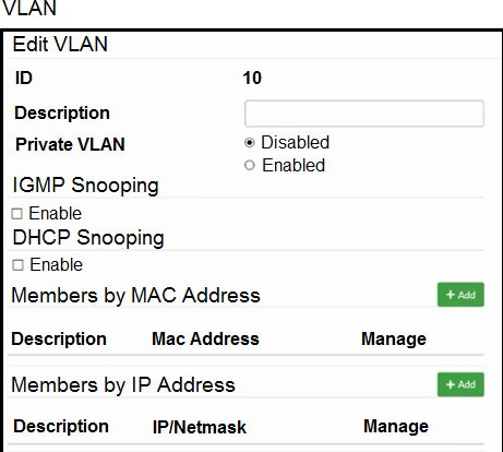

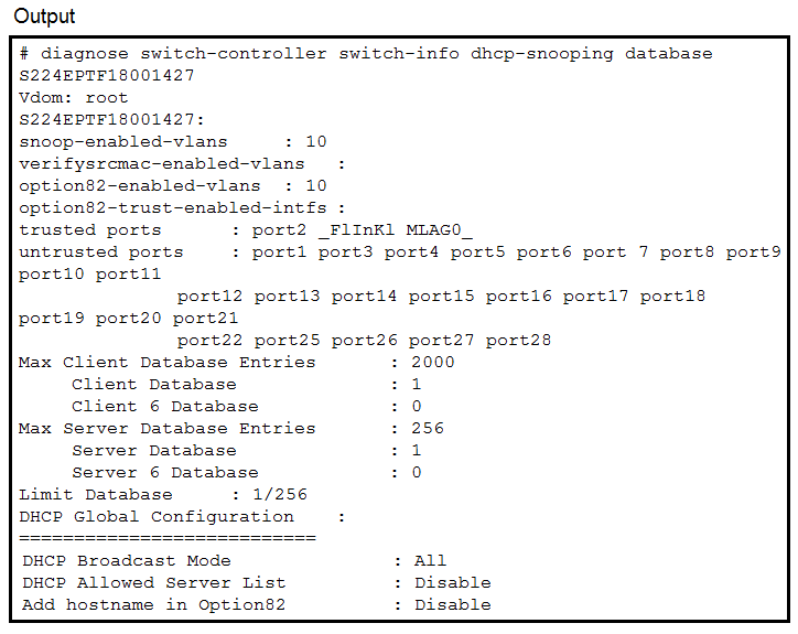

Refer to the exhibit
What two conclusions can be made regarding DHCP snooping configuration? (Choose two.)
  • A. Maximum value to accept clients DHCP request is configured as per DHCP server range.
  • B. Fortiswitch is configured to trust OHCP replies coming on FortLink interface.
  • C. DHCP clients that are trusted by DHCP snooping configured is only one.
  • D. Global configuration for DHCP snooping is set to forward DHCP client requests on all ports in the VLAN.
bd

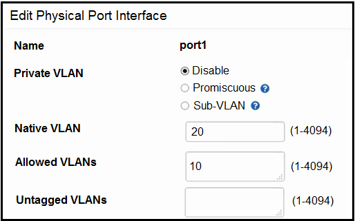

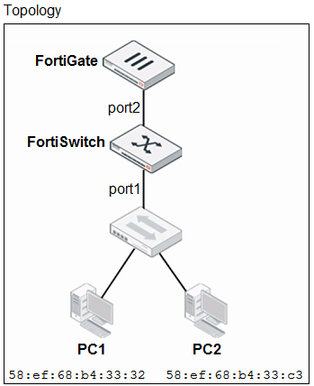

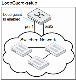

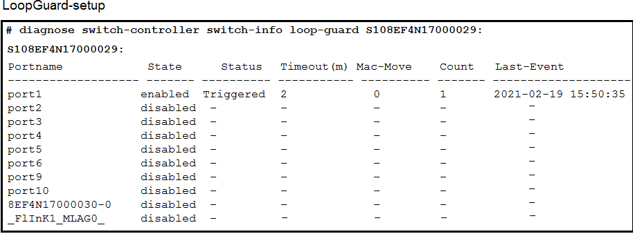

Refer to the exhibits.
Port1 and port2 are the only ports configured with the same native VLAN 10.
What are two reasons that can trigger port1 to shut down? (Choose two.)
  • A. port1 was shut down by loop guard protection.
  • B. STP triggered a loop and applied loop guard protection on port1.
  • C. An endpoint sent a BPDU on port1 that it received from another interface.
  • D. Loop guard frame sourced from port1 was received on port1.
ac
